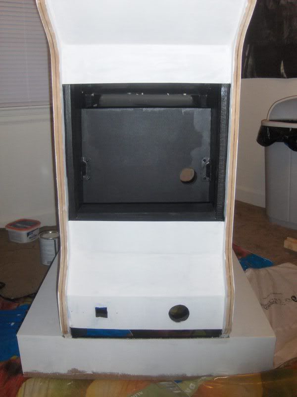

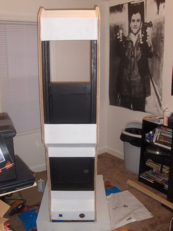

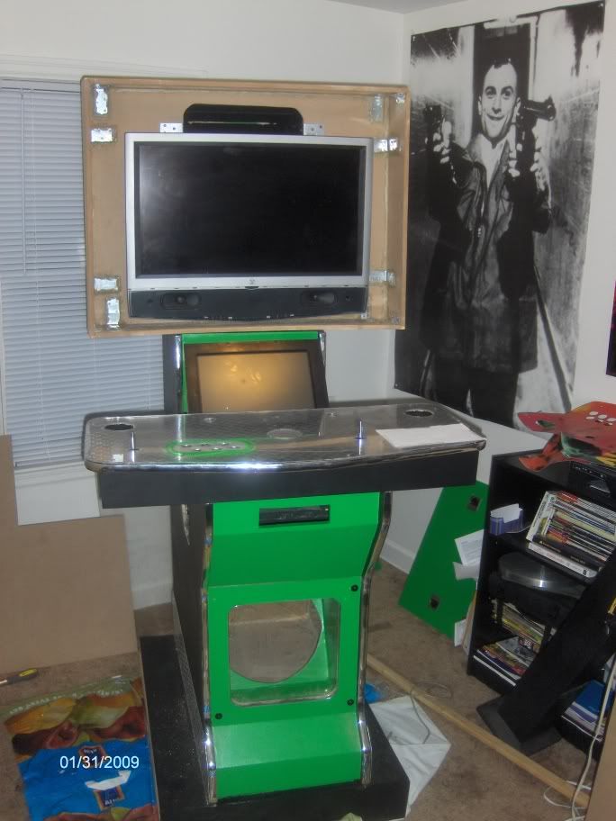

Man, its been a rough year... I've only had time and money to tinker with my cab for the last year, but I am back at it and determined to finish up within the next month (Thanks to Uncle Sam being ever so generous this season!). I actually took a semester off school and scheduled a vacation from work mid February to finish this thing up (As a C.S. major I am really going to enjoy playing with software that isn't business related... I really need the break!). Although I don't post a lot, I've checked these forums almost everyday, (kinda like checking WOOT! everyday) especially the project announcements, and I must say  that I have learned a ton and also a lot of you have rolled out some amazing cabs this year!
This is my first cab. I originally designed it taking inspiration from Taz's Mame Marvel cab. His slim cab design is genius. I really didn't have a choice as far as the cab width...the only room in my house that has room for a cab has a brutally small doorway and weird hallway angles before you even hit the door. I wanted something that would easily come apart in three or more pieces so I could easily move it. I designed it so I can easily remove the control panel and TV box, which accomplishes this quite well.
Well, I think last year I stopped about here...
And a few months later I was about here...

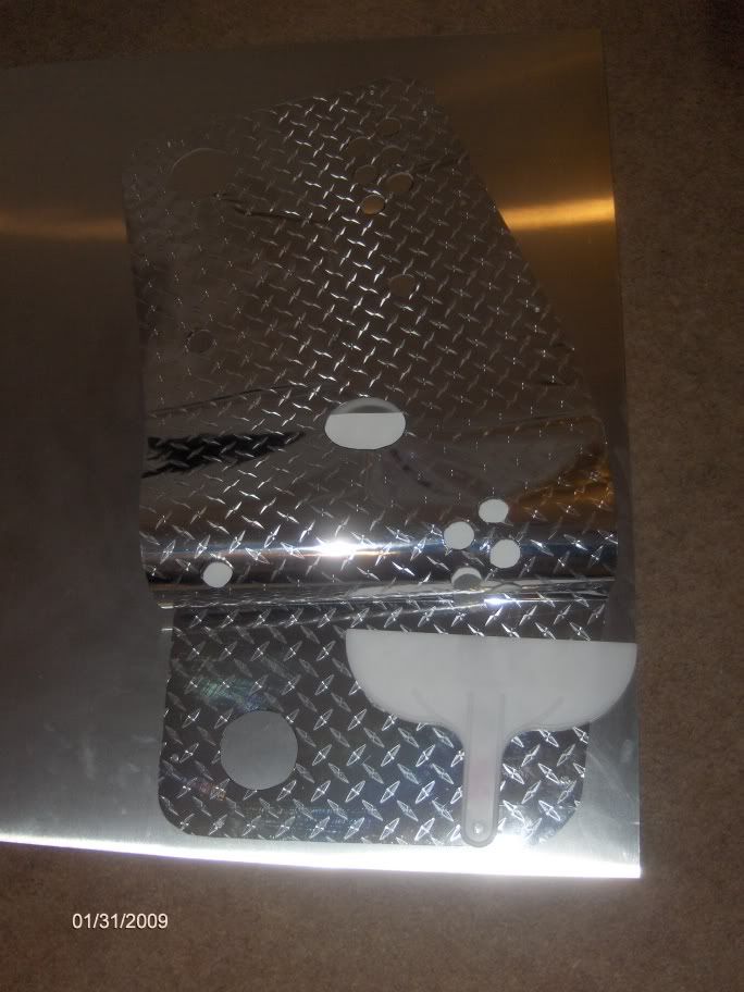

As you can see, I decided to go Green and I also grinded out some diamond plate to glue on the sides. I was thinking Vegas when I ordered the chrome t-molding. I am very happy with the way it came out! Like a fish, I like shiny things.

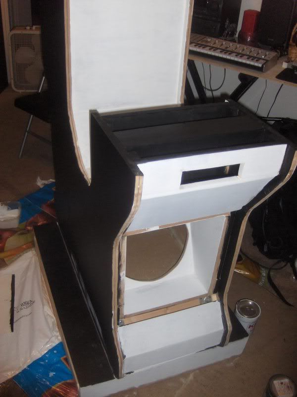

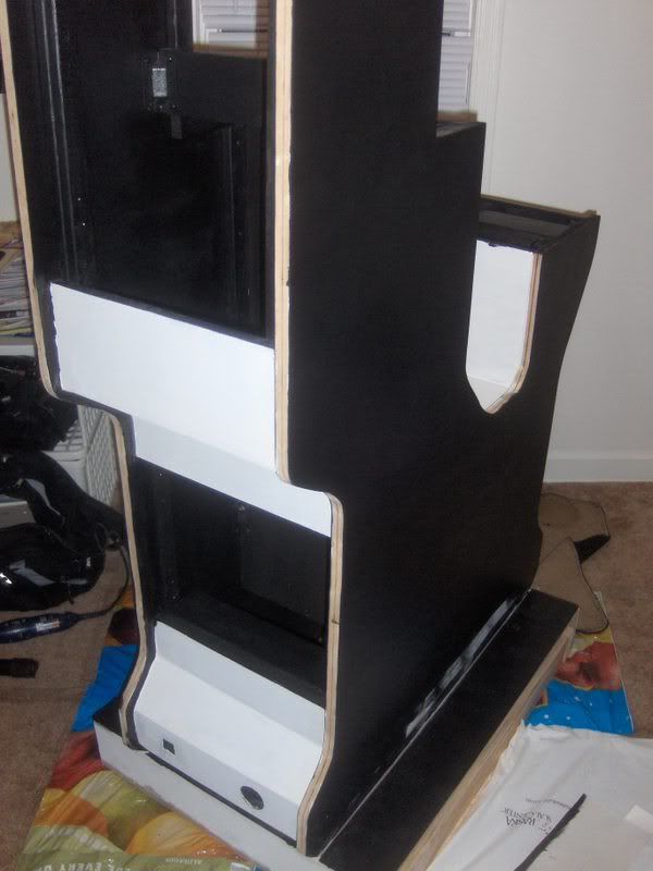

In case you are wondering why I have a giant circular hole in the front of the cab, I am going to put a 10' subwoofer in there. I am a music junkie, so I had to throw in some good tunage for when I'm woopin my friends in Killer Instinct. I built a full box for the subwoofer as you can see here...
What else??? I added a RJ-45 module so I can just plug directly into my router and do maintenance through remote desktop. Easier than opening up the control panel and pulling out a keyboard in my opinion...
The other hole in the front is for a Wii. This was something I agreed to do for my girlfriend to make up for all the sawing (in the house during winter haha).
The last few weeks I have been working a lot on the control panel and also boxing in the 32" LCD I bought for this cab. Here's where I am currently at....

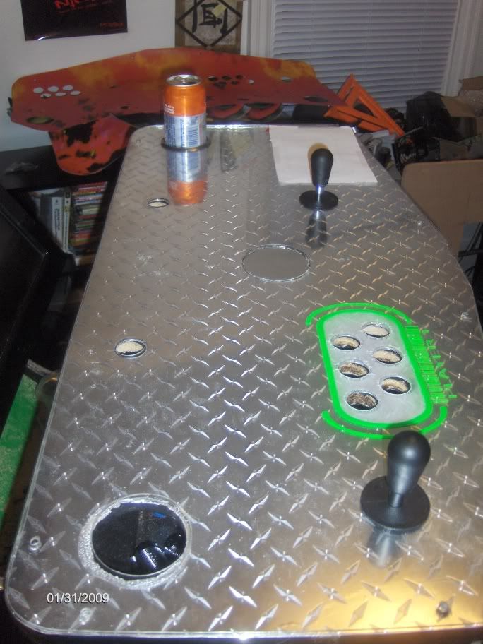

Awhile back during the cheap Ebay ELO touchscreen craze I picked one up as well. I wanted a dedicated monitor to run a jukebox. I mounted it at angle below the monitor box and it couldn't have fit better. I am going to case it in with plexi at some point.

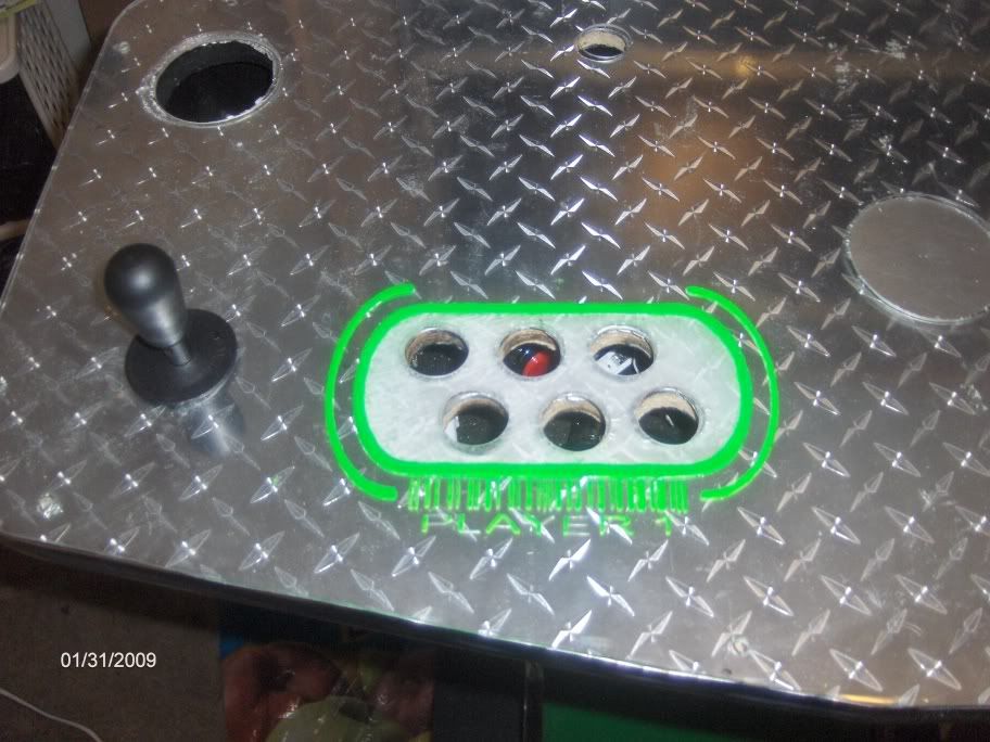

I thought a ton over the last year about what I wanted to do with the artwork on the control panel. I actually bought area 51 artwork from MameMarquees.com (As you can see in the background) but decided It wasn't right for this cab. I will use that on a full sized cab when I get a bigger house! The quality of the vinyl from MameMaquees is perfect those guys really do some amazing work. I plan to have them do the artwork surrounding the monitor once I get to it. So, I decided to keep it flashy. I wanted plexi to cover the top of the control panel but I also wanted diamond plate underneath. Trying to fabricate diamond plate for this would have been a nightmare and also it wouldn't look right under the plexi, but I found a way to satisfy my wishes. I found a guy on Ebay that makes diamond plate decals that are actually made out of paper thin aluminum and look exactly like real diamond plate...I was amazed when I got it. Being paper thin though it was wavy under the plexi and that is a no go. What I decided to do was to get a thin mill aluminum sheet and just adhere the decal to it, then just cut the aluminum. It turned out perfect and looks like real diamond plate. Here's a couple pics...
f
As you can see in the pic above my hole saw went crazy on the decal on the cup holder hole nearest the bottom. No big deal though because I plan to etch around the cup holder anyway. I have a blog out their somewhere on the internet that I started last year, once I find it and my project is done I will go into details and give my 2 cents on cab fabrication do's and dont's!
To dress it up a bit more, I decided to go with etching the plexi. I did this with a Dremel and hours of time staring straight down and then hours more painting and I am only 25% complete. I used a florescent green airbrush paint from Dick Blick because it has the perfect consistency and it is also real florescent paint. The reason I chose to go florescent is because I ordered some UV LED's to light this baby up! Here's a closer pic...

Real quick here's a rundown of the hardware features of my cab:
- 32" Westinghouse 1080p LCD
- 15" ELO touchscreen for Jukebox software
- 10" Eclipse sub woofer
- 6x9" Eclipse car speakers
- Pyle 1400 Watt amplifier
- ASUS P5K PRO Motherboard
- RAM?? Haven't bought yet
- Graphics??? Haven't bought yet
- Intel Wolfdale E8400
- 2 Ultrastick 360's
- Ultimarc Ultralux LED Chrome push buttons
- HAPP backlit 3" USB Trackball
- 2 LCD TopGun Light guns
- Nintendo Wii
Hope you enjoy my project, I appreciate any comments or criticism that anyone has! Still am trying to decide on a name...any suggestions? (It's almost like naming your baby!) I will try to keep updating over the next month with progress. :burgerking:

It's been a long time since I ordered the diamond plate decal but it looks like he's still selling the stuff, here's a link for anyone interested:
http://cgi.ebay.com/ebaymotors/4x12-Diamond-Plate-Plastic-Sticker-Decal-sheet-50-OFF_W0QQcmdZViewItemQQ_trkparmsZ72Q3a1205Q7c66Q3a2Q7c65Q3a12Q7c39Q3a1Q7c240Q3a1318QQ_trksidZp3911Q2ec0Q2em14QQhashZitem150322157013QQitemZ150322157013QQptZMotorsQ5fCarQ5fTruckQ5fPartsQ5fAccessories
It looks like he has some thicker stuff available on request now as well. Who knows, he might be able to do copper, etc as well? Not sure how this stuff is made. Might be worth checking into to safe some cash?!?! Originally I had requested black diamond plate and he said he could do that, so apparently he's the one (or has close contact to the person)  who's manufacturing this stuff.

Cup holders are a must have IMO. I was trying to figure out what the heck to use that wouldn't look cheesy and then it hit me... Why not use some casino cup holders to go with the flashy Vegas-like trim?
I just got them from an online poker supply site. I think they were around $5 bucks a piece.
