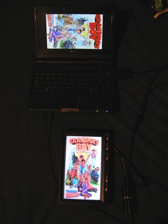

Ok guys i got my 7" touchscreen today and its working great i tried to put it into a old clear VHS cover but it was just a tad to big cause of the tabs inside the case altho it would fit fine if the case of the LCD was removed.
Here is the setup so far the EEE PC running the software and movies displaying a dvd cover

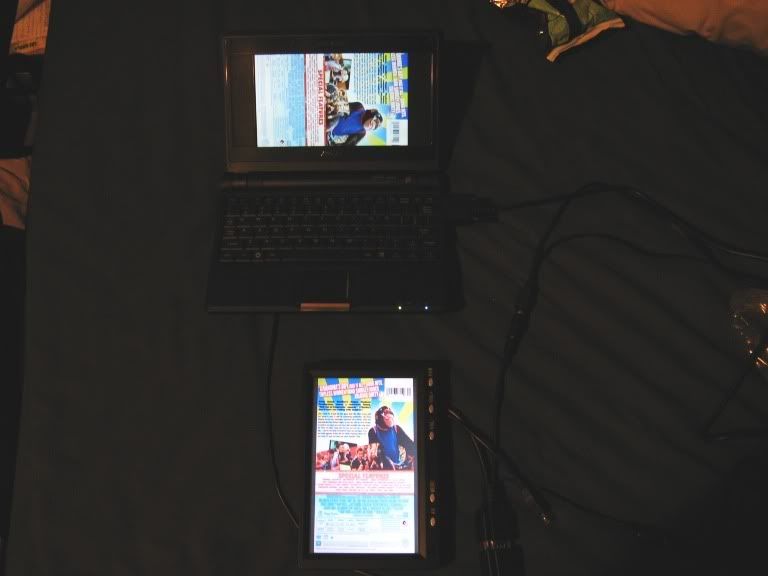

And with a click of a mouse button the back of the dvd

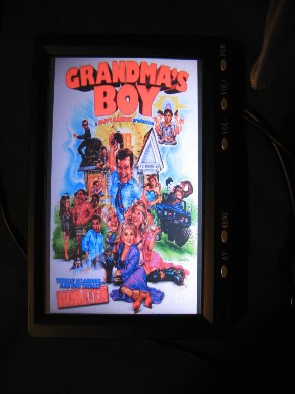

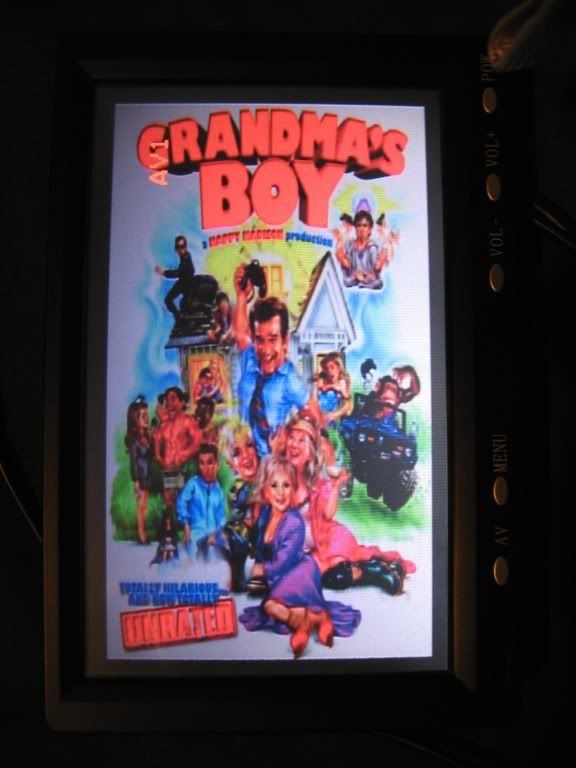

And here is a comparison of the lcd using the VGA signal as VGA
and as composite
you probably can't tell by much but the VGA is worth it compared to the composite cause the back of the dvd cover was impossible to read but clear when used for VGA so composite LCD's are out
Now this was just a quick test the colours on the touchscreen don't look as good as the eee pc cause i turned the brightness down to take a pic and left the contrast up so thats why the colour looks diff. I also need to fix the aspect ratio on it aswell.
But for a first test it worked nicely sadly the only way i could make it wireless is if i used RCA instead of a VGA signal and id rather have a small cable poking out the bottom that no wires and not being able to read the small text.
Now how this works right now is that using the mouse wheel button flips through all the DVD movies and if you click the mouse wheel that will alternate from front to back dvd cover.
using a small docking station that will have a lil pole that when the cover is inserted into it the pole hits the left mouse button which loads up the movie on the projector
I'll also have a lil magnet in the docking station that will turn a reed switch off and turn the power of the cover off for when not in use will do the same thing when on the shelf once it's moved away from the magnet it will turn on.
So far it's working great i just now need to find the right VHS cover or big dvd cover to use it :)
