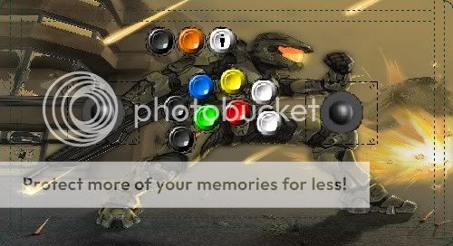

1. I've read that Sanwa buttons are the best you can get for fighting sticks. However, I also read that you can only mount them on a metal control panel. Is this true? If so, can I mount a metal layer on top of a wooden panel? Does Mame Marquees artwork stick to a metal panel?
2. Is it worth it to have all 8 buttons at one's disposal on their right hand?
3. I want to make my arcade stick wireless and rechargeable (using the 360 recharge pack and accompanying USB charge/interface cable). Can anyone advice me on a proper integration for this? I was thinking a hole in the bottom, but I wasn't sure of how to pull it off.
4. Which buttons do the various street fighter ports use on a 360 pad? I'm going to be wiring to a normal 360 pad, and I need to make sure that I get the right buttons in the right places. I'm not really sure whether to use the triggers or the bumpers for the far right buttons, or whether to do something else entirely. Any advice here, especially pertaining to the Street Fighter control layout used in Street Fighter HD (or any other Street Fighter games on the 360), is desired.
Here's a picture of what I'm thinking right now as a final product.
Green=A
Red=B
Blue=X
Yellow=Y
Black=One of the Bumpers/Triggers
White=The other of the two Bumpers/Triggers
Black(top row): Back
Player 1 Button: Start
Orange: Guide
The arcade stick in question. I put several inches of space around the buttons to let my arms rest comfortably on top of the panel.
(Artwork modification by Ninjun)

I personally can't stand Sanwa buttons, and have all Happ concave in mine.
Your mockup looks perfect, and most of the fighting games let you fully customize the buttons. I do have 8 on mine, but there isn't really any need for the extra 2 in any games.
I busted out the rotary tool and soldering iron, and I actually mounted the battery compartment to the outside of my arcade stick. I also mounted the port for the play & charge, so that I can plug it in like I do just like with the regular controller.
I have seen another arcade stick, where the battery and all were inside the controller with the play & charge wired to a standard USB jack to the outside.

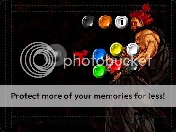

Does anyone know if it's possible to wire an analog stick on the 360 to a digital arcade stick? I'd love to do that in the future for games like Geometry Wars or any other dual-stick games.
Here's a mock-up of what that might look like:
Artwork by Utilizator @ DeviantArt
« Last Edit: December 24, 2008, 09:52:20 am by Chris2 »

I used seimitsu buttons, but the sanwa screw ons are the exact same for mounting.  Heres my build page if you want to see what I did.  http://omgbbq.com/tfight360.htm
Basically they work fine on 1/4" thick wood, you can either just use a 1/4" thick panel with stiffeners and extra supports, or route out recesses for the buttons on a thicker panel.

This is what my buddy Mark did on mine.  Never underestimate the power of the 2nd joystick ( You do play Robotron dont you?? )
