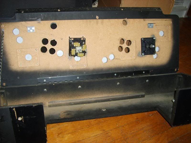

Hi everyone!  I've been thinking about making a MAME cabinet for about 2 years now and this past weekend I finally went to the amazing Arcade auction at Timonium Fairgrounds in MD and picked up a cabinet to gut.  I was taking apart the control panel to salvage the working buttons and joysticks before I rebuild the control panel and I got stuck at the joysticks.  How do I remove these??? :dizzy:
I thought you could just unscrew them, but they don't want to budge.  Anyone have any tricks or tips on installing and removing joysticks?
Thanks in advance!

can you post a picture of the underneath of the panel?

I'm betting there is an "E" clip on the very bottom.  Pop it off with a jewelers screwdriver (but cover it with your hand, they fly off and get lost very easily) and the shaft should slide right out.

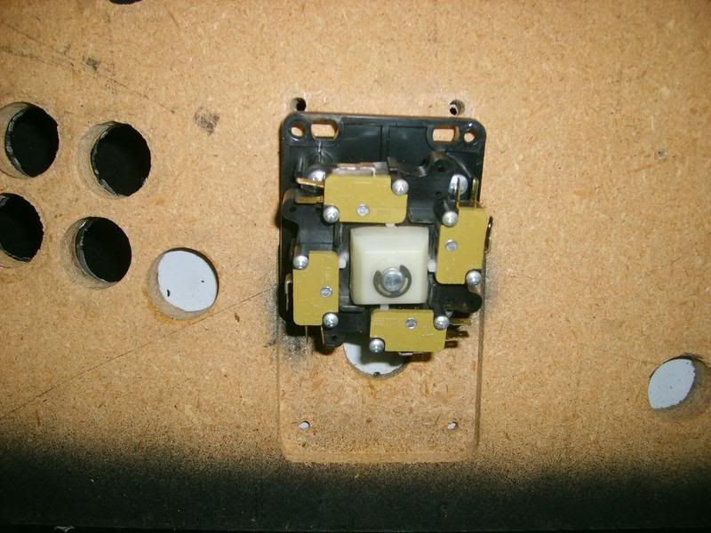

Wow, thanks for the quick response!  Duh, I should have posted the images, first but here they are:
Underside of the panel.  As you can see I have removed all the buttons and wiring.  I'm thinking about replacing this piece of wood as well so I can design my own stick and button layout.
Closeup of the left stick, which I just unscrewed the 4 screws holding it to the wood.
Closeup of the right stick, which I went a little further and took off all the microswitches and the "bottom" of the joystick.
Any suggestions?

Is there a technique to removing these easily?  I got one clip off of the right stick, but it took me awhile and I was afraid of breaking the clip/my screwdriver.
Sorry I didn't see your post until after I put up my pics...  ;D

You definitely won't break the clip, nor your screwdriver as long as it's made of hardened metal.  Most jewelers screwdrivers are.

use a small flathead srewdriver and pull out the eclip, if you are afraid to losing it just pinch the middle of  e clip with a pair of long nose pliers, don't apply force to the pliers just follow the movement while you are sliding the  E clip out
