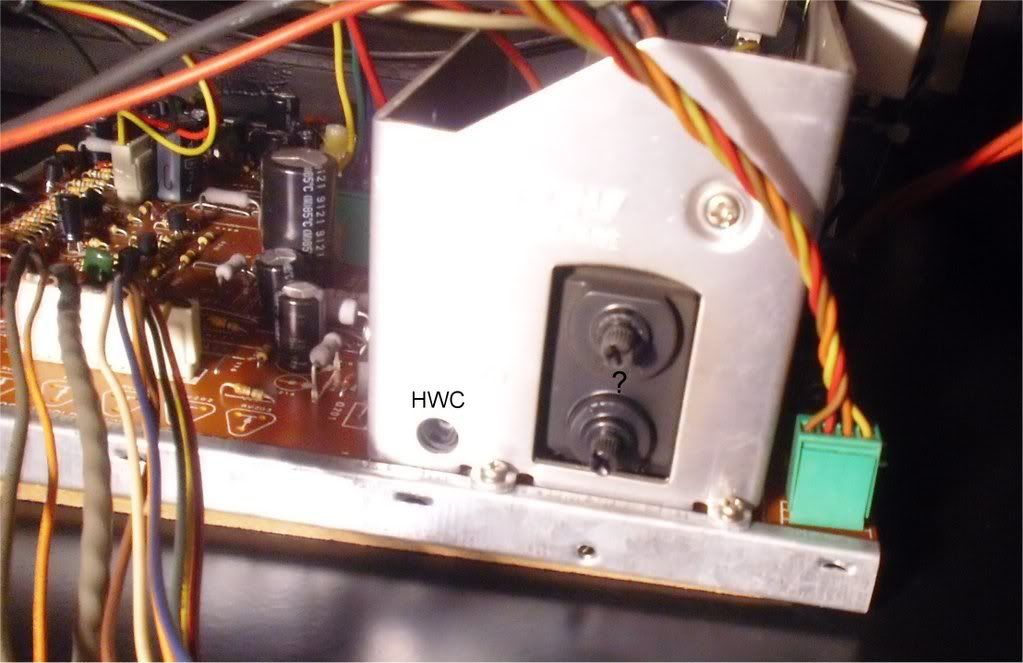

OK, I found the horizontal width coil on my chassis, at least I think I did. Is it the part next to 'E' in the picture below?
If so, how can I adjust it? I mean, it's not in an upright position, but laying flat down, at one end there is some big round black 'thing' with a white spot, at the other end there is the metal protection shield (which end do I have to reach anyway?). Taken the high voltage risks in mind I don't want to disassemble all kind of things or fiddle around in a tight and crowded space.
And I also saw another pot, marked 'F' in the picture, which on my chassis is secured with hot glue. What is it for?

« Reply #4 on: October 12, 2008, 12:36:43 pm »
"F" is the B+ power supply adjustment. Don't touch it.
Your particular width coil appears to adjust from the side of the flyback cage next to the focus and screen controls. Your picture isn't very good since I can't see the opening for the focus and screen adjustments. I'm guessing there is a hole in the aluminum frame to stick the plastic adjusting tool in there to turn the width coil.

The picture above is not a picture I made, I got it from Jomac.
But you're right, there is a hole, as you can see in the picture below (made by me, the picture I mean).
Now I need to find the right tool in a shop somewhere in The Netherlands to adjust the coil :)  How is this tool called?
thanks for your help, and here is my final question: what are the two pots at the questionmark for?  I won't turn them, there is a high voltage warning very nereby these pots  ;)

« Reply #6 on: October 12, 2008, 07:11:24 pm »
Top one is focus and bottom one is screen adjustment.
The tool you need is called plastic hex tv alignment tool. They come in different diameters and most are metric.
www.radioshack.com sells them and I think they have a picture of them too.
Check out item # 64-2220 or 64-2230.

Thanks, found the tool.  :cheers:
Edit: after I found out that shipping costs to The Netherlands are pretty high for such a tool , I decided to make my own tool. I very carefully used a metal allen wrench just to measure the size of the hole in the coil, and then I carved a little tool out  of some plastic thin stick I had  :D
Then I carefully adjusted the horizontal width coil (in my case about 12 half turns anti-clockwise, if I did more the screen become more wide again) and now I narrowed the screen so that I have an almost complete picture (only still a few milimeters loss on both sides, who cares).
