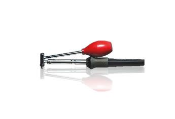

Yeah, I just de-blobbed a bunch of leafs today. Doesn't take a minute to do. reflow the rest around the tab you can't get, let it cool, and
test a connector on the tab to make sure it will fit post-deblobbing.
About $20 at the radioshock will get you set up. Bob has them as well.

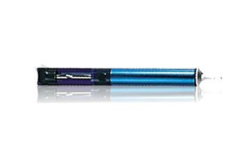

Don't forget the desoddering iron as well. Either the heated one
 or the simple suction thingy
will work fine. The blue suction one is what I prefer for most things.. one less heated item to worry about,
and there's never a stable way to set the hot one down it seems.
