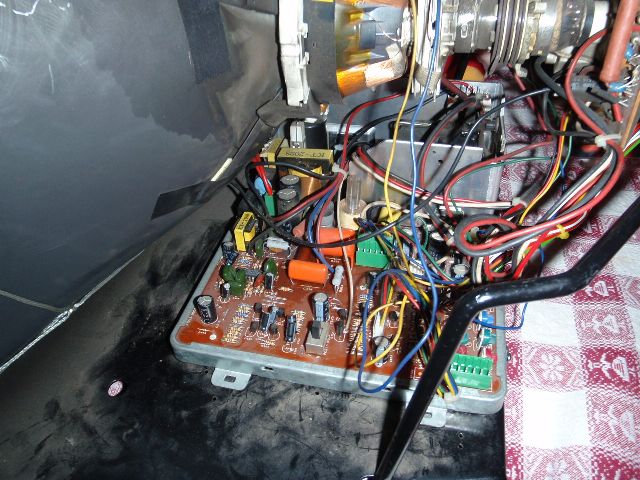

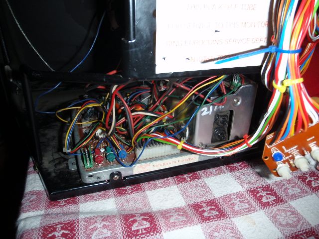

Saturday morning, I switched on the monitor (a Kortek with Smansung Tube 20") and POOF, smoke and sizzling noises from inside the cab, yikes!!!!
Opend the back, put the power back on and all sparks were flying out of the Line Output Transformer (Reading all these forums over the past 4 days, think I got it right).

there is no way you caused the flyback to fail,it just got old and flaky

well got it repaired by eurcoin for about £45 and as soon as i plugged it in, it started doing the same thing.

what model kortek is this,the early ones need to be run from 120vac and not 230ac
the hantarex polo range are all free voltage which means they run direct from any wall socket voltage in the world without the need for transformers-filters etc

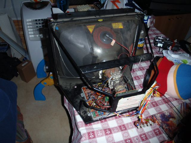

thanks for the response Grant, have just ordered a new Hantarex Polo 3 21" from them this morning!

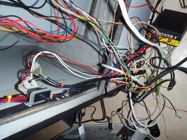

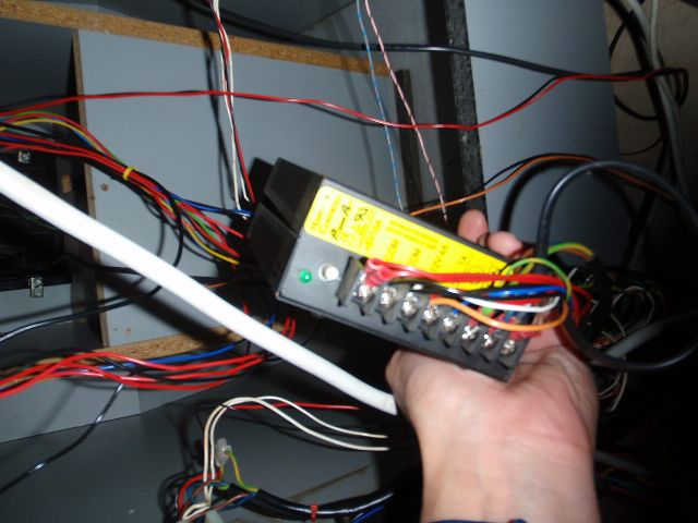

Here is the offending item, which is wired to the coin box and the power of the monitor:

the wiring is a disgrace,it needs sorting out

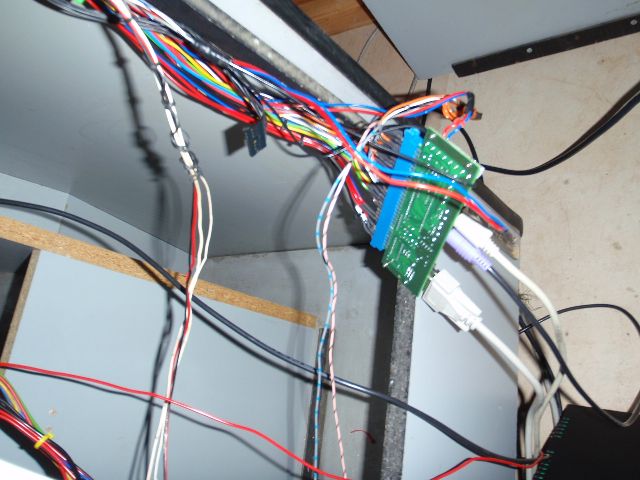

you are using a jpac,are you using soft 15k to produce the video signal or an arcade vga?

I am using Arcade VGA, infact, I bought a new one to replace the arcade VGA that was in there, and have opened a post in Software as I cannot get mamewah to work now :-(

if you were running the monitor from the correct avga output then there is no way you would have sent the wrong signal,unless your software/setup is wrong
i think you should email andy at ultimarc

its down to the horizontal output transistor,if its a meaty one then they can take some pretty off the scale frequency and survive
if its a crappy bu2520 then you only need to fart near it and they blow
as long as you feed 15khz then you will have no problems
