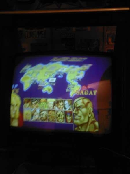

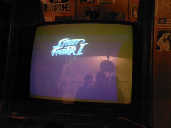

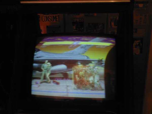

i recently bought an arcade machine  :laugh:  but , once i installed the board of street fighter 2 and turn on the machine , i had 2 problems ,
1- red color missing , i already fixed that changing a "potenciometro" (cant remember the English word right now)
2- (this one is driving me crazy) , the image looks like i show below and i couldn't find the cause , any ideas plz ?
i would love some help
cheers! and sorry for my English

nah,your tube is a nokia a66-your chassis is something else mate-thats why you can't find any info
to me it looks like either the sync is on the wrong connection or you need to tweek your horizontal hold pot

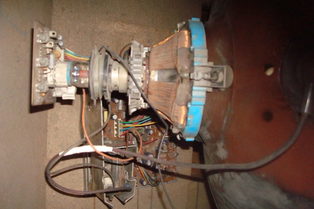

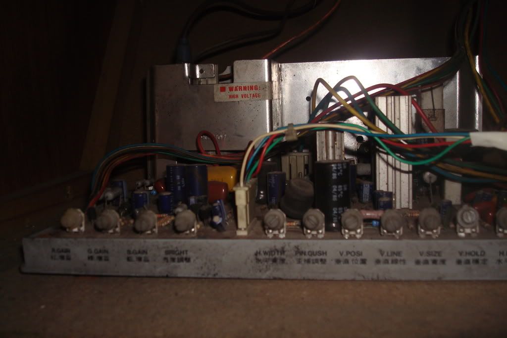

Some images:
thanks !

grantspain
  • Posts: 6181
  • Last login:Yesterday at 03:37:21 am
Re: Arcade monitor issues
« Reply #4 on: September 30, 2008, 02:50:20 pm »
your sync looks correct as it only goes to one place
i have the schem for this,i got it from www.pentranic.com website and it is marked as ch888 chassis
probably could do with some caps done on this,if you look at the schem and trace the sync then that should point you in the correct direction
wtf happened with the anode lead from the flyback :o
anarkotiko21
  • Posts: 18
  • Last login:October 09, 2008, 05:57:13 pm
« Reply #5 on: September 30, 2008, 06:07:32 pm »
hey , thanks for the schem , im trying to figure it out , so , you  mean i might need to change some capacitor ? how can i find the one making trouble?
he , the anode lead was looking a little suspicious , so i did that "fix" just in case

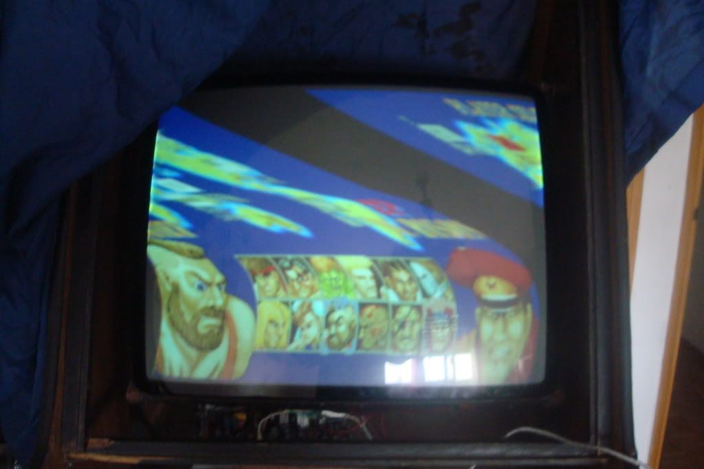

« Reply #6 on: October 01, 2008, 07:19:11 pm »
Hi !
A little update :
* I couldnt really figure out the schems , are you shre is the same chasis? (Rodo JW-888A)
* i replaced the caps : C801 , C313 , C901 , C407 , C326 and C499 - but nothing changed
* also , moving the H.Hold pot i coud get somthing like this :

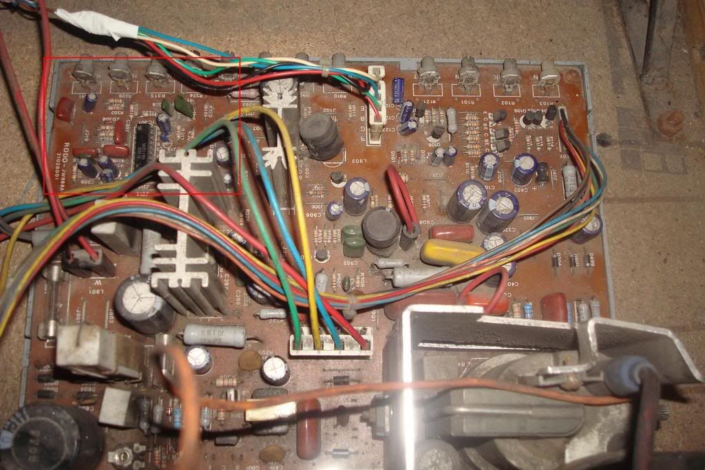

*and someone told , looking that picture that the wrong cap probably is around here : (look inside the red square) , wich im going to check now
thanks for any feedback
grantspain
  • Posts: 6181
« Reply #7 on: October 02, 2008, 04:29:59 am »
make sure the sync is showing continuity to the jamma pin  p and the video ground is good to pin 14
i am sure they are the same chassis,give me a random component value and position number

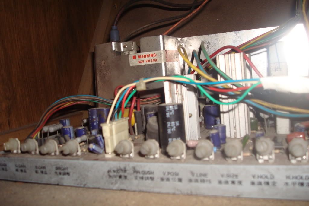

still didnt check what you suggested , but  i rplaced some of the clindric caps in the section inside the red square in the photo i showed to you ...(nothing changed)
but i have a couple of questions:
1 - the red caps (i think theyre also caps) should be replaced too - i ask becose they look to be diferent kind or somthing ...dont know?
2- see the 3 red caps , close to the 3 cilindrics blue caps , inside the red square ? , i noticed that if , being the machine working , i put a finger there (without moving it or pressing hard) the image start moving  a little in one , a lot in the other , could this mean tha problem is there????  ???  or is it normal ?
again , thaaanks a lot !
grantspain
  • Posts: 6181
« Reply #10 on: October 02, 2008, 08:33:57 am »
don´t worry about the red caps,they very rarely go faulty-they are polypropylene type
don´t stick your finger onto the chassis when its powered up unless you want a nice big electric shock,check around that area for bad solder joints
maybe that the wrong schem then

never heard of a flyback operating under it B+ level,maybe someone is confused
to meter the b+ you need to find the output from the power supply section
where are you based as i think you should think about sending for repair,to me this looks like a fault on the horizontal sync circuit only
anarkotiko21
  • Posts: 18
« Reply #30 on: October 08, 2008, 03:21:50 am »
I undersatnd , but in my country i dont know of any place who fix arcade monitors , and know someone who tried and the guys didn know how... and , im still feel like trying
anyway , i probaly wasnt talking about B+ , but theres somthing wrong where i check , becose must said 110 , according to the older chasis, but said 60, obviously the error could be originated in other place.how can i be shure about the outpout from the power supply ?
i found two other irregularities , in the zone you told me, and also in the zone where i get that mismatch of volt comparing with the older chasis.
testing continuity and comparing it with the older chasis i found that my chasis have this irregularities in the hor. sync:
1)the upper pin of the H.posi pot have continuity with boths the pin above him , when the continuity should be only in the left one.
2) Also , the resistence thats just above of H.pos gives me continuity , wich , not only is not suposed to give me according to the reference of the older chasis, also , and this may be false cose i dont know, isnt resistance supposed to not give continuity ever? ------wait , i just saw that the resistance pins are there , but in the other part , i dosnt sime to be one .... in boths chasis , so , i dont know if the mismatch is important
grantspain
  • Posts: 6181
« Reply #31 on: October 08, 2008, 05:14:26 pm »
try replacing the hor hold and position pots,what country are you from?
enusbaum
  • Posts: 7
  • Last login:October 27, 2008, 12:27:26 am
« Reply #32 on: October 13, 2008, 04:54:14 pm »
That CRT board looks a LOT like mine. In fact, almost identical to mine which is a Wei-Ya C829HR .
Might want to see if you can find anything on their site:
http://www.weiya.com.tw/
