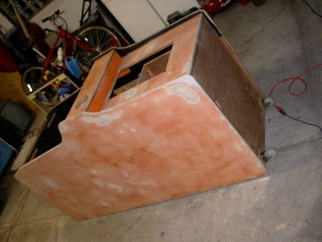

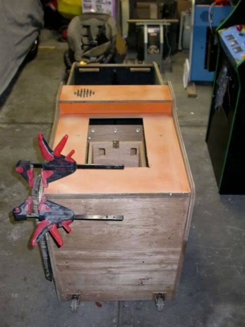

Here are some before photos. Didn't seem that bad until I actually started. But, still a solid machine
Cabinet Stripped

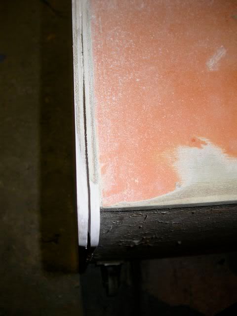

Corner / Plywood repair. Due to the base being gone the plywood was starting to pull apart on the bottom corner.
Time to bondo and sand the front and the sides.
New Base Installation
Finally standing upright
A coat of primer / sandible undercoat finally on.

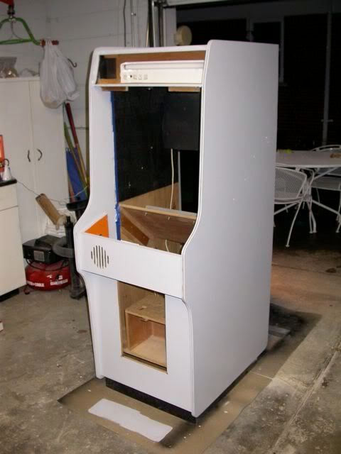

Thats it for now. I've painted all the black on the cabinet (no photos yet) and will be painting the blue this weekend and will post some more photos.

Here are a couple of updates from the last few nights.
Here are a couple of updates.
Black was applied over the last couple of nights.
Tonight got a coat of blue on. Looks pretty damn good if I do say so myself.

Looking good!  How long did it take to sand, bondo and put on the primer?   :cheers:
audiomidiman
  • Posts: 99
  • Last login:February 07, 2015, 11:40:00 pm
Re: Donkey Kong 2 - D2K Project
« Reply #5 on: September 20, 2008, 01:21:24 pm »
Bondo and sanding didn't take to long however the back edge had to be "LEVELED" which was a trip. Overall, I think it looks great so far. I have a couple of "THIN" spots but a second coat of blue should solve that.

Got the second coat of "BLUE" on last night and removed the painters tape this morning. Looks great!!!
The speaker grill repair turned out great!!!
Hoping to get the brackets and coin door sprayed tomorrow night (was hoping for today but it didn't happen) and possibly install the "T-Molding".
