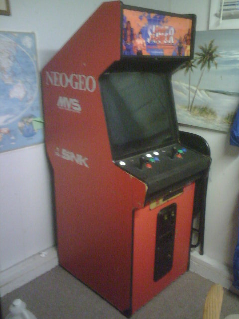

ahhh the trusty 2 slot cab nobody wanted:
then I got the idea to just restore it:
then I saw the South American NeoGeo cabs:

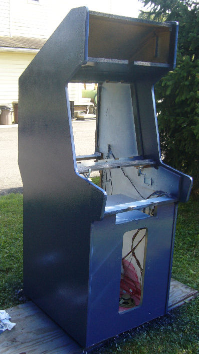

then painted it Blue:

« Reply #1 on: September 11, 2008, 10:18:16 pm »
Can you give some more information about what you did to the metal control panel?  I have one on a cab that I am MAMEing and would consider altering the current one if I knew more about the process.  Otherwise I may have one fabricated.
It looks as though you added a few holes as well as filled some in?  I have never used a metal punch, how is that?  How big of a hole can you make with one?  I am hoping to add a trackball to mine.

« Reply #2 on: September 11, 2008, 10:22:23 pm »
looks good.... :cheers:   Is that oil based paint or is this a latex paint?

« Reply #3 on: September 12, 2008, 07:44:15 am »
I double punched the hole. I drilled a 1/8" hole then ran a 5/8" punch through it. then I ran a 1" punch through the 5/8" hole. The metal punch I used is for conduit and therefor the holes come out a little bigger then the hole punch size. The 1 inch punch makes a hole about 1 and 1/16th which is just about perfect for a button. The biggest punch I own does a 2" hole but I think they make a 2 1/2" or 3" one. I didnt fill in the extra hole because I dont know if the lady wants a 6 or 7 button set up so its just covered with vinyl for now, and plexiglass later. I will say this, Samurai Shodown is weird to play on a SF layout.
If you have the option of fabricating one then I'd go that route then if you ever decide to revert it back, its easier.
Enamel  paint (oil based) sprayed with a nozzle hooked to an air compressor. The paint is a 3:2 mix of paint to thinner and the color is AMAZING in person. Im going to work on dremeling out the plexiglass holes
