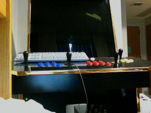

I have gold on mine. Might have pictures up later if I can find a camera to borrow.

Jban4us, I would be interested in seeing pictures of the gold t-molding on a cabinet. In the product photos, it is difficult to determine the exact golden hue.

« Reply #4 on: September 12, 2008, 12:34:06 pm »
It is pretty much gold  :P
here are some pictures (taken with a less than great quality iSight camera):
It's hard to see what it really looks like in the pictures, especially with the flash and fluorescent lighting.
I'll have more pictures when I steal my girlfriend's camera and finally make a project thread.
