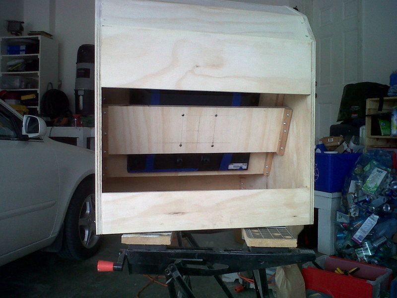

I got the idea to make a mame cabinet recently while i was deciding what to do with my old computer.
The computer is a pentium 4 with H/T 3.2ghz with 2.5 gigs of ram.
The screen is a 19 4:3 aspect ratio lcd screen i had sitting around from my old computer.
The cabinet is roughly based off of a forum user here who build a neo geo inspired unit i sorta just copied the design off of his and figured out what size it would have to be.
anyways here was the first day.
 :blah: :blah:
i cut it out of 5/8 sanded plywood, they were out of 1/2 and i didn't want to wait to get started on the build.
I used these 1" by 1" cendar square lengths of wood i found to make bracing for the unit.
I cut the both side with a traced out template i made earlier so i could make sure the size would be large enough, once they were both cut individually i clampled them together and sanded the edges at the same time.
spent a whole day doing the bracing and sanding, had to come back a few days later to construct the unit, i had some old sony speakers from my old computer and decided to use them since they are powered and amplified, took them apart and i will just extend wires to them later on.
Came back a few days later, decided to work on the bezel holder and sand the unit some more, fill some cracks in with wood filler, and decided to mount the monitor, it ended up pretty good but i may need to adjust it still.
I made the bezel holder out of some wood trim i found that is essentially a 90 degree piece rounded on the inside, but the nice thing is the inside has a groove that will hold a piece of plexiglass nicely, the blue tape is a covered piece, though i am going to have to replace it since i think its scratched. but it will just be a place holder for now until i do the final building and painting.
The plexi was 5/64, i think it was way to thin to work with and snapped more then it cut.
anyways im going to finish the edge of the plywood with a adhesive birch strip to make it appear as a solid piece of wood rather then plywood, for the back i have some hindges and a little hook latch that should close the back off nicely. local hardware store had them on sale for 50% off.
i have some zippyy joysticks with the quieter microswitches and some buttons or order from groovy game gear, didn't want to spend a lot at first since i tend to have a lot of pipe dream projects that i don't finish or give up on, so far it seems like i will finish this unit.  :dunno
i need to figure out a way to do the sizing on the front plexi better and a way to mount it nicely.
sorry about pictures not being the best, took them with my blackberry in low light.

I have decided i am going to make a wood bezel for the screen to surround it, and attach my plexi via some means of velcro, that way i have access to the power button and controls of the monitor easier in case i need to.
I was wondering what control board to get?
Im debating between the keywiz 40st and getting the wiring kit with it, or the ipac controller?
I have 2 8 way joysticks, 6 buttons per player, a 1 and a 2 player button as well as 2 horizontal buttons for either side, mounted sorta in a pinball flipper button location.
Thanks for any help.  :applaud: :cheers:
« Last Edit: July 19, 2012, 12:16:18 pm by teeuwen »

So i framed the front of the unit today and i think it finishes off the front of the unit. i was actually surprised i managed to cut the frame to the right size and centered it just right first try. unit is coming together pretty fast.
I also met a contact yesterday that i helped out with some plumbing supplies and found out that he worked at a local glass shop, i picked up a nice sheet of polycarbonet today for my arcade that should be very very nice for 25$
here is some update pictures.
i included some pictures of the back of the unit and the inside, the panel that is open on the back will have a hinged door, with a hook latch that i already spoke about early, hopefully should turn out well, i do plan to mount two 120mm computer fans on the door and aswell will make some holes in the top for a vent.

Looks really nice.  I like the shape(s) in the back.  I would suggest only that you put some sort of vent on the bottom, too so that the fans can suck air across.  I think Knievel did this on his bartop by leaving a 1/2" space between the bottom board and the vertical board just under the CP.
Nice job...watchin with pregnant anticipation.

Does anyone know a good way to make a hole for a fan without a proper size holesaw? i want to put two 120mm fans on the back of the unit but havent come up with a good way to cut them out, i don't want them to look horrible.
Pretty soon i should have everything together though, hopefully it comes out okay.
If you have a Dremel rotary tool, there are two attachments you might want to consider.
The first is the Model 678-01 Circle Cutter.
It cuts circles from 3/4" to 12" in diameter.
The other is the older style Model 330 Router Attachment.
The Model 330 is getting hard to find, but can make a perfect circle like this.
Protip -- When set to the smallest possible radius, it makes a perfect mounting hole for the Ultimarc U-Trak Trackball.

made some progress yesterday, i got up fairly early and headed off to my parents house to get started on the arcade.
I managed to borrow a 4 1/2 hole saw from a guy at work, so i could drill out the holes for the 120mm fans that i will be installing in the back.
My brother in law is visiting at the moment with my sister, so he helped me apply the paint to my arcade, did two coats and i will be letting it dry until Monday when i will go over it again
with a light sand and get it looking nice.
I also cut the polycarb for the arcade unit, man this stuff cuts awesome with a jig saw, i cut the first piece perfect for the arcade unit, as well i had some left over so i made a cover for the control panel as well as re did the marquee.
Does anyone know what hole size i need for arcade buttons? 1" was to small...... and i had a hole saw that was larger didn't have any stamping on it but it was to big.
What would be the best way to drill out the poly carb and the control panel at the same time ?
thanks  :cheers:

I use a 18mm spade bit for buttons, this will go right through the layers to limit blow out use a scrap piece of wood underneath (use plenty of clamps).
The buttons in your earlier photos are standard arcade button size = 1-1/8" (or 30mm if you want just a little more wiggle room.)
+1 on the scrap wood underneath and clamps.
Take your time drilling the polycarb to avoid cracking it.
You may want to do a a practice run with some scraps to be sure you've got the right technique and methods.

Actually, the best way to get the CP plexi done right is with a router.  When drilling with the spade bits, you MUST sandwich it, otherwise, you'll get cracking.
I'm guessing you don't have a router, so here's what I would do.
1.) cut the plexi overlay to match the CP.  If it's not perfect, sand the edges until it fits just a little tight.
2.) sandwich in the following order....a.) sacrafice piece of wood, larger then the CP b.) plexi.. c.) the CP flipped upside down...no matter how square you think something is, it's better to cut/drill/route them in their final orientation...and in step 1, you made it fit it its original place.  Make sure this sandwich is clamped VERY tight.
3.)  Drill slowly.
YMMV.

I've never sandwiched.  I drill a pilot hole and then go slow with the spade until it scores the circle then increase speed.  I usually have pretty good luck and haven't ruined any of the last few that I've done.  Sure accidents happen but I'm guessing it's at a similar rate to clamping and sandwiching.  I always cut the CP and plexi separately, I use a cheap-o printout of the CPO to mark my centers.  I like being able to see what's going on with the plexi and if it looks like it's getting stressed I can change tools.
Different strokes for different folks.  Same advice you'll see throughout is to go slow.

+1 on slow!!  Some say to even go backwards with the spade bit, so it's just burning through the plexi.
Personally, I found the router to be the best for me.  Like you said, I could see the material as I worked.  Plus I just laid the plexi down on the already finished CP, clamped it, drilled pilot holes big enough for the flush trim bit to fit through and zipped around the holes.  Then I put in a 45 chamfer bit and did the hole for the joys and trackball.
Once that was done, I put in several buttons to hold it all together and used the flush trim bit to do the outside edge so it was perfect around the perimeter of the CP.
