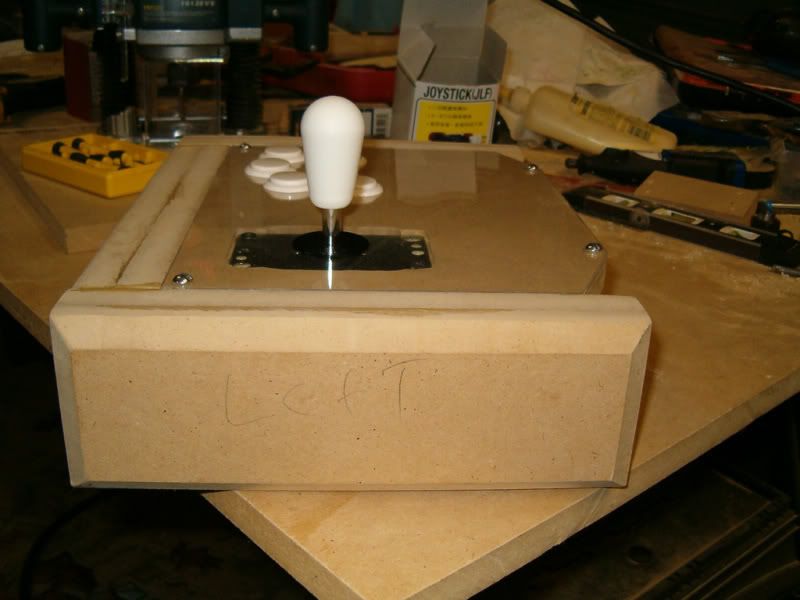

This has been an on and off project for a good 6-8 months now. And since I've moved in with my girlfriend I've had more free time on the weekends to get some stuff done. So I figured I'd take this project back up again.
I'm working on three sticks right now. 1 for PS2, and the other 2 for Xbox 360 (wired).
The first stick is gonna be painted to look rusty and muck covered (like Silent Hill). And will hopefully match the artwork.
The 2nd and 3rd sticks will be Street Fighter IV oriented. Probably gonna end up making a stick for every character in SF IV. So about 12 total.
Here be some starter pics.
The dimensions are 4"H x 10.75"L x 8.25"W.

Gonna keep the particle board sticks around as tester sticks....so those'll be for my little mame console once I get more buttons and whatnot ordered.

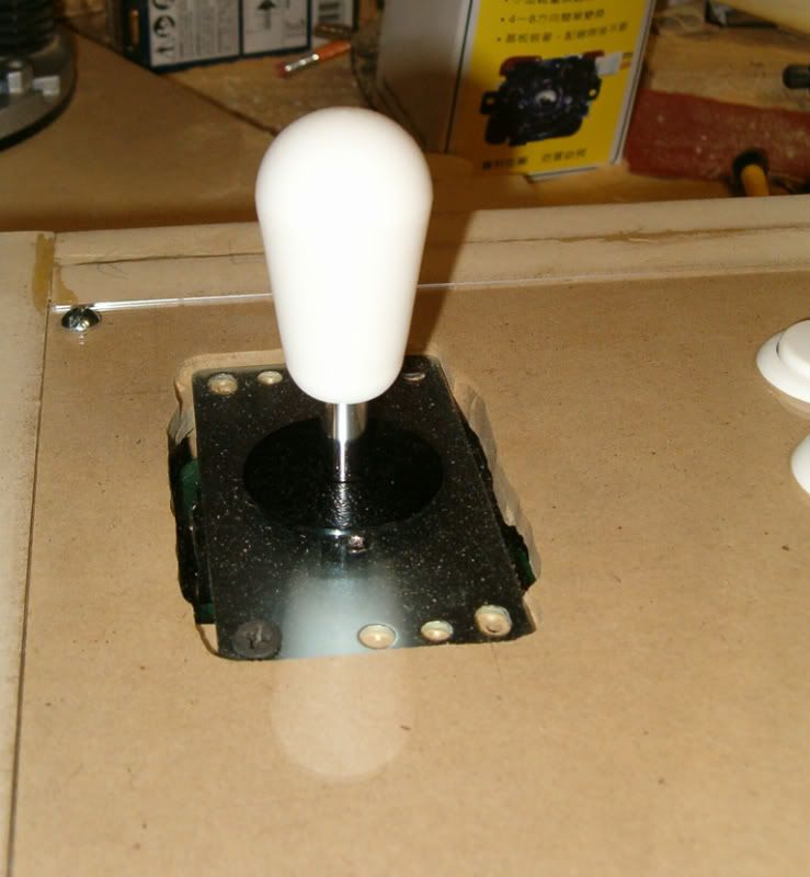

But I went to home depot and picked up some 3/4" MDF board.
Got the 1st stick cut out, the joystick area routered, and the whole case assembled. All thats left is cutting out the plexi, painting the box and beginning to mount everything in the case.
This one will be for PS1/PS2 (or PC is you have a usb adapter).
I'll post more once I get some work done today.

Now I'm stuck in a waiting period....since my pop doesn't have the tools necessary to cut down plexi-glass....he's gotta borrow it from his job.
Any tips or things I need to worry about when I cut the plexi down? and punch the button/joystick holes out?
Also...what size bolts do I need to use to mount the Happ competition stick in there?
As for the size of the PCB's in the case, the PS2 boards fit just right. No problem. The 360 PCB however....might be an issue. So I might need to make the 360 sticks bigger so I have more room for the guts & wiring. I just prefer the feel of Happ parts over Sanwa & Seimitsu.

« Reply #12 on: September 08, 2008, 01:33:38 pm »
The plexi tools he's bringing how are likely going to be something to "score" the plastic and then "snap it" like glass.  The problem with this, is that sometimes, no matter how deep you score the plastic, it may not break exactly like you want it. Forstner bit will be the best, but holesaw can be used. Make sure you put the plastic on top of some wood when drilling, keep the edges nice and clean.
As for the happ comps, it's best just to take the stick with you to the hardware store and look for yourself. I'd take the entire thing down there for the best end result.
I wish I had more advice, but thats it.

When I made mine, I tried first to use the hole saw, and it worked just fine for the first few, then I cracked the plexi on the fourth.
So its possible with a hole saw imo.  Practice a few first if you can.
What I ended up doing, is using a 3/4" spade drill bit with barely any pressure.  It was the perfect size for my joy stick, and on the buttons, it gave my a pilot hole to then stick my router pattern bit into.  Then the router works wonders with plexi.
As for cutting it down to size, I scored the hell out of it on both sides, and broke it to get it down to about 1/4" of the final size.  Then it was the pattern bit again to knock it down to exact dimensions.

just a little update. got the first sheet of plexi cut....my god what a mess.  I ruined probably a 3rd of the sheet. Thankfully I came up with a way to cut the plexi without shattering it.
Basically set the plexi down on 2 thick pieces of board and clamp it down real good. The boards should be about a 1/4th of an inch apart creating straight edge groove for the router to travel down. Use a bit with a ball bearing so it only cuts the plexi and not the wood. Easy breezy.
Once the piece is cut out, fit it to your joystick top, clamp it, then router the edges so you've got it nice and flush. If need be, you can use a dremel tool with a grinding tip to clean up the edge.
To drill out the buttons, had to drill a small pilot hole for the larger bit to go into. Otherwise it would try to grab too quickly and end up shattering the plexi. After the hole is driled out, lightly grind with the dremel and its good to go.
The key....do it slowly.
Thankfully it only took me ruining 1 small piece to get it right.

But here be a few WIP photos of the latest. Lemme know what you all think.
yeah...my routering is a little fugly. And I'm not really sure how to setup a template for future use. This stick has had a few challenges come with it, but thankfully with a little thought I've been able to use a few work arounds and get a good result. But this has also shown me that sometimes its better to just buy what you need to begin with instead of trying to get too creative with tools. lol.
Just gotta sand and cleanup the edges, fill in some of the seams....then its paint, wire and assemble!  :woot

I'll get you an exact measurement this evening. But basically I routered a square just deep enough on the top of the case, so the JLF mounting plate would be flush. But there was plenty of room for movement.
the trickiest parts to work with were the buttons. If you get the screw in kind, the wood will require alot of extra routering so you can actually screw the mounting pieces in properly.

Thanks alot for the kind words. This was oddly enough the simplest build out of all the other sticks I've done. And oddly I think this one turned out the best of all of them.
I've gotta find a thinner wood for the top piece though...the plexi sits just above the t-molding so I had to use a few screws to hold it down. But overall I'm pretty happy with it.
Kaytrim
  • I'm too nice a guy
  • Posts: 2095
Re: Console Joysticks in the Works. - NEW PHOTOS!! UPDATED 2/14/09!
« Reply #113 on: February 17, 2009, 01:16:02 pm »
Look for 5/8" plywood or MDF instead of 3/4".  Use a 3/4" thick piece to setup your t-slot cutter and route from the bottom side of the panel.  That will setup the slot so the Plexiglas is covered by the t-molding.
Michael  :cheers:
