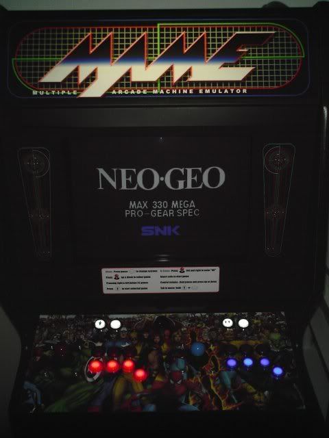

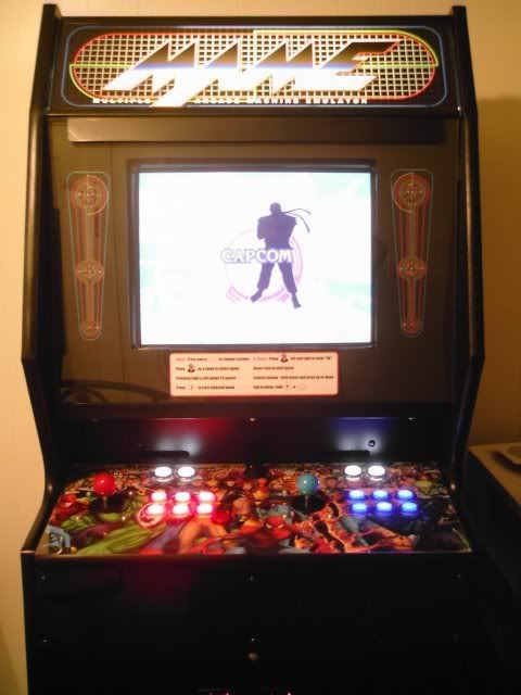

PICTURES:
Lights in room ON, pushbutton lights OFF:
Lights in room ON, pushbutton lights ON:
Lights in room OFF, pushbuttons lights ON:

Very cool, they look pretty bright. I love the ease of lighting, but the smooth evenness you can get with a wedge-lit Happ appears a little better to me, if not pretty underneath.
Rt
Ginsu Victim
  • Posts: 10093
  • Comanche, OK -- USA
Re: Ultimarc Ultralux lighted pushbuttons
« Reply #8 on: July 29, 2008, 10:38:09 pm »
Remember that these pics are on a low-end crappy camera. They look much better in person.
