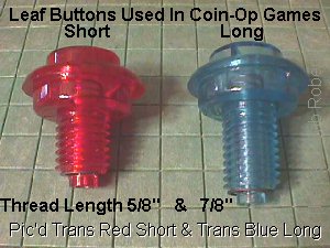

There are two types of push buttons:
1) Leaf buttons (in either short or long form)
2) Micro Switch buttons (always long)
As you can see the MS button has some "holders" for the micro-switch to click in. Without modding it (you could , in theory, cut off the holders and see if you can actuate a leaf with the end that gets pushed down with the button, but that is a clumsy mod I guess.)
Here's some more info about short and long leaf buttons:
http://homearcade.org/BBBB/metal.html
http://homearcade.org/BBBB/leafsw.html
