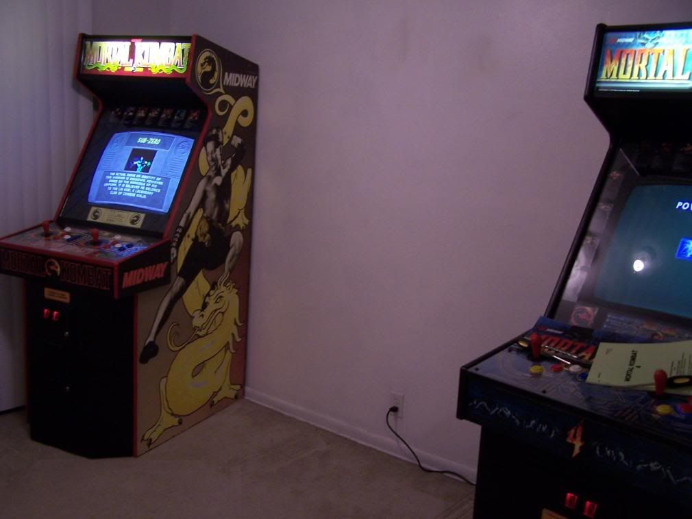

Hey...
I'm new here, seems like a great place though.

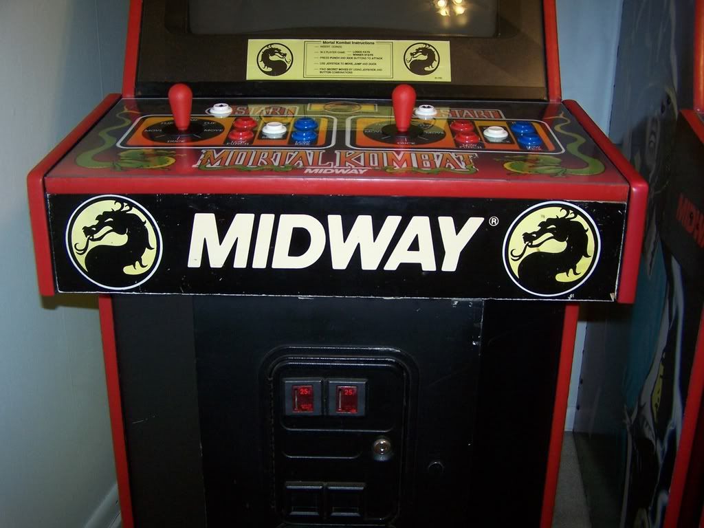

Just picked this up, never owned a cabinet before, and couldn't be happier with what it happens to be. I'm no judge on quality. There are a couple very obvious problems: The molding on the left hand side of the CP is gone, and there are some chipped bits on the CP itself, and some scratches in general, almost all of which are just on the plain black surface below, and not on the side art. I'm going to get some red happ competition joy sticks, and I'm in the process of replacing the pushbuttons.
I was having a 'problem' with the monitor doing a quick crackle type sound around once at each start up. It seemed to do it a couple more times if you hopped on to the controls right off the bat, but could be coincidence. It seems to have stopped all this behavior in the last day or two.

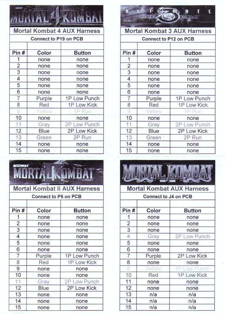

I'm getting MK2 and UMK3 boards to swap in. I still need to pick up a kick harness. Is my understanding correct? As follows:
1.MK, MK2, U/MK3, MK4 have the same wiring for high punch, high kick, block.
2.MK2, U/MK3, MK4 have the same wiring for low punch, run, and low kick, though run is not present in MK2, the others 'line up'.
3.MK1 has the low punch and kick wired to different pins.
The immediate plan is to simply swap a new board in every once in a while (marquees too), do our best to master the respective title, and then move on. It'll be a while still before we soak up all the MK1 even, we want to savor it. ;) And I've yet to beat the game with everyone on normal, let alone hard with anyone.
But the long term goal is to get a MultiJamma setup.
I know that everyone seems to go for Clay's hardware, and I've chatted with him a little. (He actually happens to be an owner of an arcade I've recently gone to, it turns out).
But I don't need 8 boards, and I would rather not deal with them all being on, all the time we play. (Electric bill, having to get a new PSU, etc). Plus he seems to not produce much anymore.
http://www.jammaboards.com/store/6-in-1-multijamma-switcher-pcb/prod_250.html
As long as we don't switch them while it's on... it sounds okay. My concern is the controls. I can't really understand how they would be wired up to all work whenever the switch is flipped, and I'm really stumped as to how I could possibly get MK1 working in the mix without swapping anything when I want to play (which wouldn't be the end of the world).
Oh, and though I'm researching, none of this is going to even be considered until I get myself an MK4 PCB. :D (My ears are open, hehe. And I'll post in the BST forum at some point.)

the kick harness in MK1 is the odd man out, I know because I have it and tried to put it in my MKII cabinet.
Do the world a favor and DONT drill a run button hole in the MK1 CP. if you're local I have an extra MK3/UMK3CP that I'd love to trade for an MK1 (it'd complete my set)
I'll break it down simpler:
MKII, U/MK3, MK4 all use the MKII kick harness
MK1 uses a different kick harness (might even be a SF-esque harness)
the rest of the buttons are the same in all of them

You have to use diodes if you want to connect the kickharness all up at the same time.  I tried it with MK1 and MK2 at the same time and it would cause all kinds of button issues.  this was with one of yatons dual jamma harnesses so it only has one game powered at a time.  I'll bet the others that have all the boards powered at the same time will really need diodes....

That artwork on the side looks PHENOMENAL!  Almost as if that cab never saw the light of day!   :applaud:

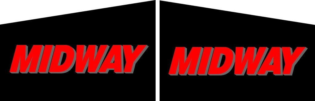

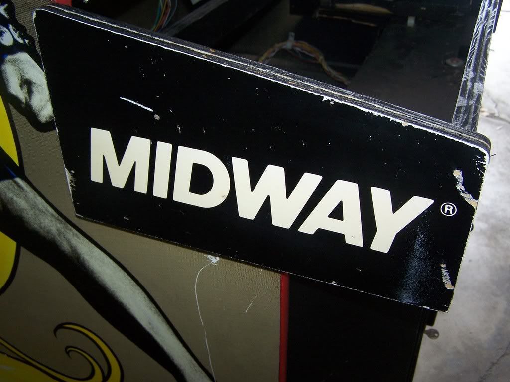

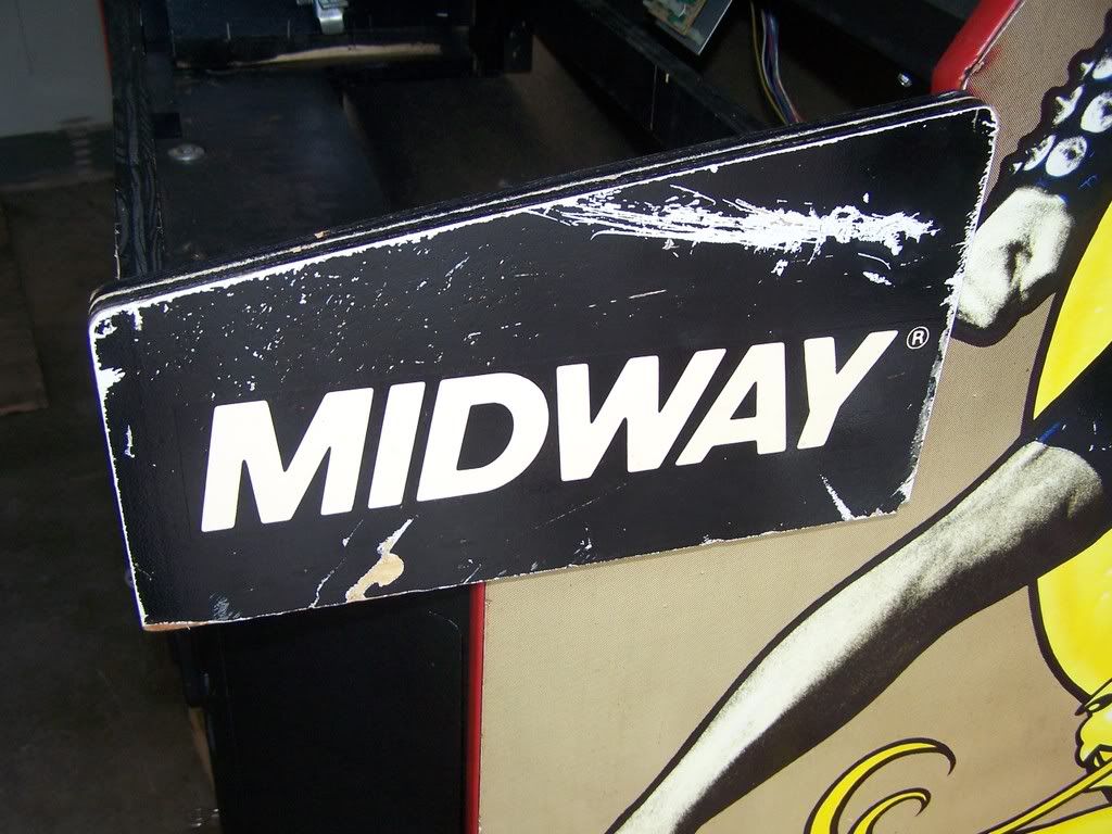

Here is the connector/harness layout for all the Mortal Kombat LP/LK harnesses....
And if you want to replace your "Midway" CP sides, you can have these printed off at any local digital printing shop...( I attached the actual Adobe Acrobat file below)
I was going to say the same thing! Mine's all faded... :(

WOW!  That sideart is kickass.  I actually thought that they came in black and white.

Was there originally any plexiglass or anything over the CPO?

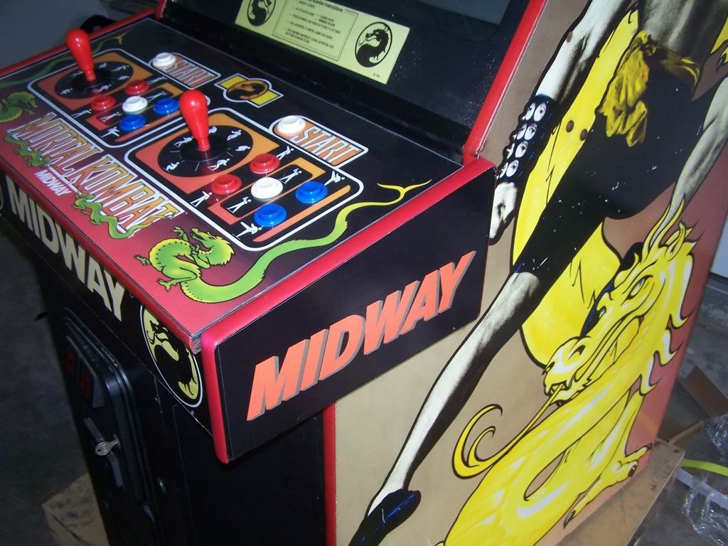

Yes. Here is an exapmle of how a the control panel should look...
And a custom front panel decal...

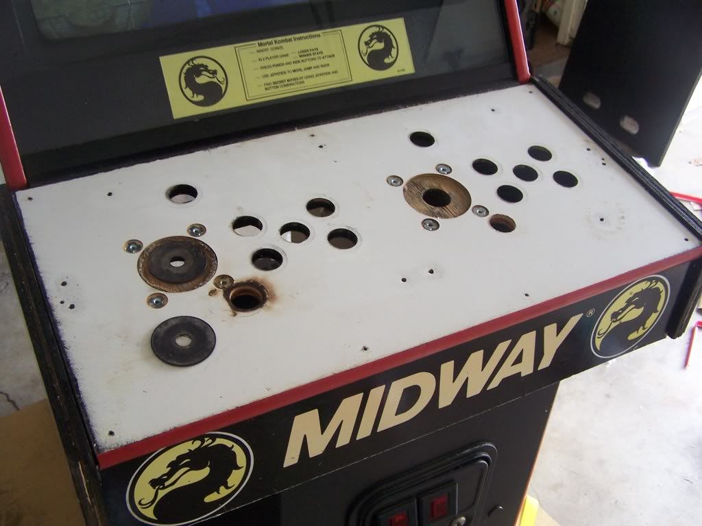

Thanks! Those CP pictures look much more like what I remember from years back. Explains why mine is a bit chipped up. What do you call those black discs that go around the base of the joystick?

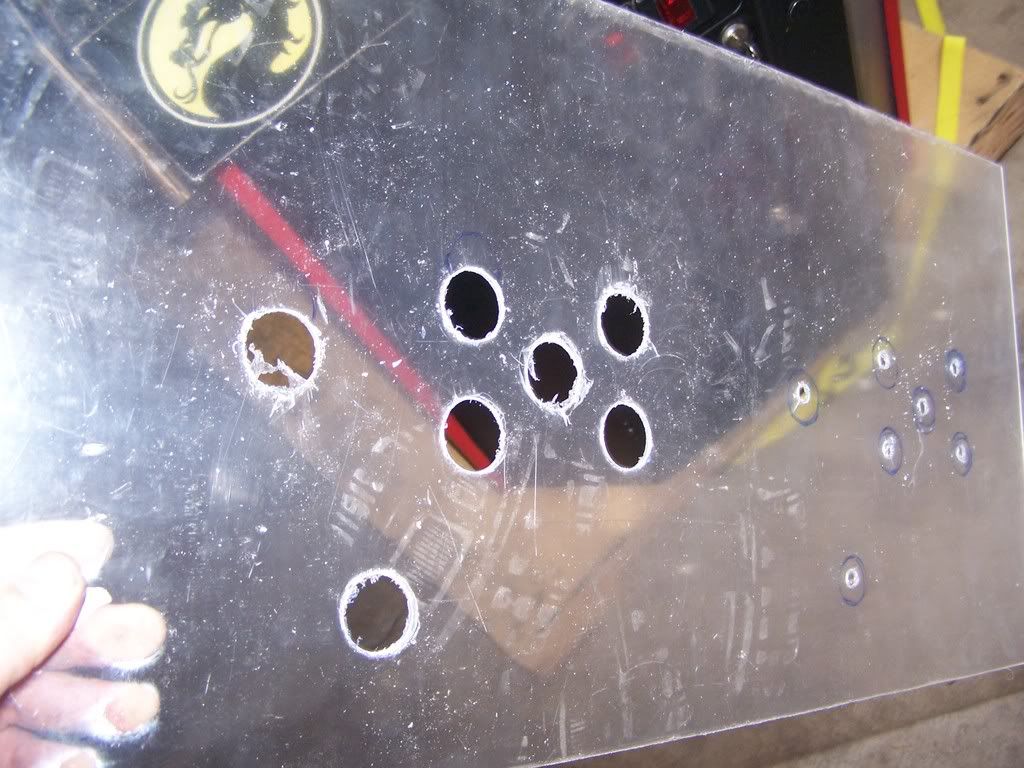

What you can't really make out in my photos is the fact that there is the melted in mark of a penny on the top left of the control panel. I don't know why... but it pretty much sucks.
They're dust washers.  They're supposed to keep debris from falling down into the joystick housing.  There is a never-ending debate about whether they should go on top of the CP or underneath it.  You may have them on your MK, just mounted under the panel.

thats how they come from the factory. as for the CPs, not all are vynil, my dedicated MK3 and 4 panels are metal. Im sure my MKII is vynil just never bothered to check
