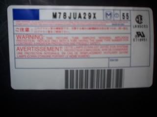

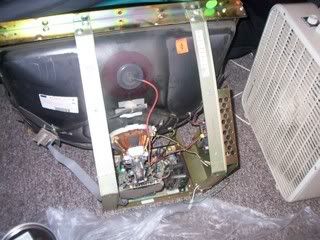

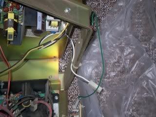

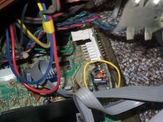

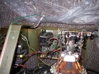

Hello, all. I am a newb of sorts in the arcade world... however I have been reading pretty much nonstop while beginning this hobby 4 weeks ago. I have reached the Arcade Monitor phase of my plan, and before I go poking around trying to get this thing up and running I want to figure out what I have... This monitor is a 32" beauty from an X-men VS Street fighter cab.
Here are the pics... sorry about the quality. I can post better pics tonight if you guys need.

I'll put better pictures up tonight.

« Reply #2 on: October 17, 2007, 12:06:28 pm »
And you read this first and visited the sites mentioned?

« Reply #4 on: October 17, 2007, 12:54:31 pm »
It's obviously a Wells-Gardner monitor, but it's not one i've seen since I only work on 25" or smaller monitors.

« Reply #5 on: October 17, 2007, 01:21:44 pm »
i have seen one like that on a konami gti club so its a medium resolution wg but the exact model i do not know-year around 1998

« Reply #7 on: October 17, 2007, 04:01:53 pm »
The fine folks at WG are telling me its a U3000 series monitor. Does that sound right?

« Reply #8 on: October 17, 2007, 06:04:54 pm »
Yes, that sounds right since it was manufactured in the larger tube sizes. I've never encountered one. Nor do I want to.

« Reply #13 on: September 19, 2008, 10:03:35 am »
I just wanted to ask a couple more questions... I have had this monitor for a year now... and really it is a very dull monitor (color's aren't very bright or vivid). Also there is a bit of an hour glass shape to it (the picture comes in towards the middle). It never bothered me before, but now I am diving into better emulators that have really nice colors and graphics and aren't quite the same. What do you guys suggest I do to bring this Monitor back?

« Reply #14 on: September 19, 2008, 01:19:43 pm »
Capacitor kit is probably needed.
Wells-Gardner parts department has a capkit for this monitor:
S-KIT CAP U30 Capacitor Kit for U3000 monitor.

« Reply #15 on: September 20, 2008, 09:52:16 am »
pin cushion correction malfunctioning
for starters,  check d705,c720,q705
