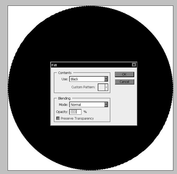

how do i find out the actual size of the hole and implement it into photoshop, never done this before
BASS!
  • Just have fun.
  • Posts: 837
Re: control gfx
« Reply #5 on: April 19, 2008, 11:24:40 pm »
I've got a little trick for you.
make a new document at the same dpi as your document that you are laying out. Make the size the same as the button diameter (ie .345"). Once your document is open create a new layer called button hole, and grab the marquee tool. Hold down your mouse on the button until you are able to select different shapes, and choose the circle.
Now hold down shift and make a selection on the canvas, and fill it the full size of the document.
Once you fill this you will have an object that you can drop into your document that is the perfect size of what you are using.
