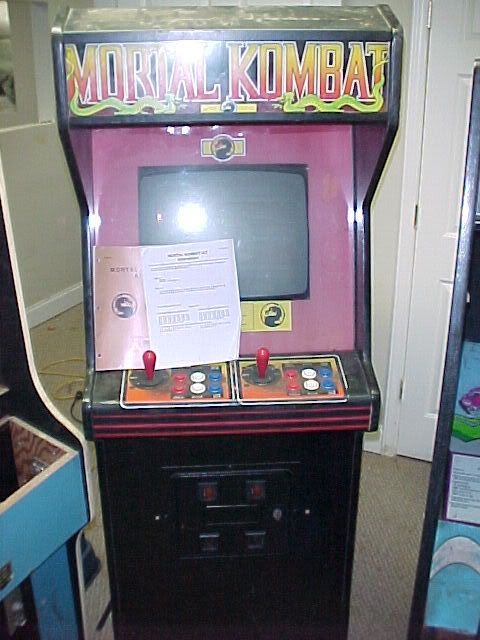

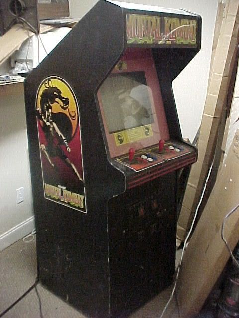

Okay, this is my third MAME machine. The first one was a big six button Midway cabinet (Made for a dedicated Killer Instinct actually) with a 25" monitor and an Xbox in it, really nice for fighting games. The second was a 3KOAM Z-back cabinet with a 25" vertical monitor, for shooters and other vertical games as well. Now, I could use the Midway cabinet for most of the games that I play. But the size of it, the 25" screen, games like Bad Dudes and Golden Axe, classics like Robotron, etc. Just didn't feel right on that thing. A smaller cabinet with a smaller monitor would feel closer to the original machines. Plus, using a PC instead of an Xbox would have more versatility. Oh, and I just wanted another machine in the room. ;D
This was a Mortal Kombat conversion job I bought from a fellow Digital Press regular, in "the great $99 coin-op sale". He was cool enough to swap the board with an original Capcom SF2CE,which I've been meaning to get, and for an extra $50.00 he swapped the monitor for a 19" 1982 Electrohome G07. It has an incredible picture for such an old monitor, I was floored when I saw it.

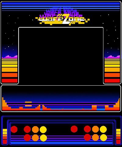

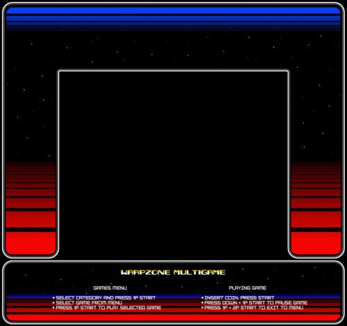

As I worked on the design, the classic nature of the Atari cabinet drove me to a retro look. I started with the bezel, because it's like the centerpiece, and I would design the marquee and CPO after it. I wanted it to look like a video game world, and after a month or so of rejecting other ideas, here's something I came up with- (Note how the borders on the bezel mimic the Centipede bezel)
I thought it was rather fitting for a classic machine, and I liked the little 8-bit video game stage on the bezel, which was also going on the front part of the control panel. But after doing a mock-up on a picture of the Mortal Kombat, It just wasn't doing it for me. It's rather cartoony, and it was just too dang colorful; games like Double Dragon and Ninja Spirit would seem out of place to me. So I wanted something a bit more monotone, and in the end the 8-bit stuff had to go. It was too hard to make something that really strikes me with that motif. So I stuck with the same basic design, the horizontal lines, and made a red/black scheme, with a little blue to accent it. I threw in some stars and a blue glow on the horizon in the lower section to make it look like the landscape of another world. I think it's a more flexible design than the 8-bit mountains.
I feel a lot better with this design, it has a little more sophistication than the last one. Present-day fighting games, space games, swords & sorcery kind of games, they all fit well with this theme.
Now we need a control panel! Actually, one thing that influenced the new design was Nintendo's Playchoice 10 control panel. It's a cool design, and I think it's good for a multigame theme. After designing the bezel it was easy to come up with an effective CPO. Right away I imagined this control panel with red balltop Sanwa joysticks, with the chrome shaft. And shiny new Happs buttons! At first I'd cluttered it up with borders and lettering, but in the end I decided to keep it simple-
I think it's pretty effective. The only additional graphics here are the little "Atari start people", just a little nod to the original machine. The middle of the CP has the "Warp Zone horizon" graphics, and I made the logo using a lowercase Transformers font, modified a little bit.
And to top it all off, the marquee! The overall design is dark, and I hate black marquees.  But I think this one is colorful enough to work out, I took the same basic design and tilted it for a nice dynamic effect. I added an image trail to the logo, like it's "flying through the warp zone!"
When I put it all together in a mockup, I really liked it. It has sort of a retro look to compliment the classic nature of the Atari cabinet, but modern games will look right at home as well. And the "Warp Zone" title is not only a snazzy name, (Titles with a Z are always more dynamic, aren't they?) but drives home the whole point of "video games".

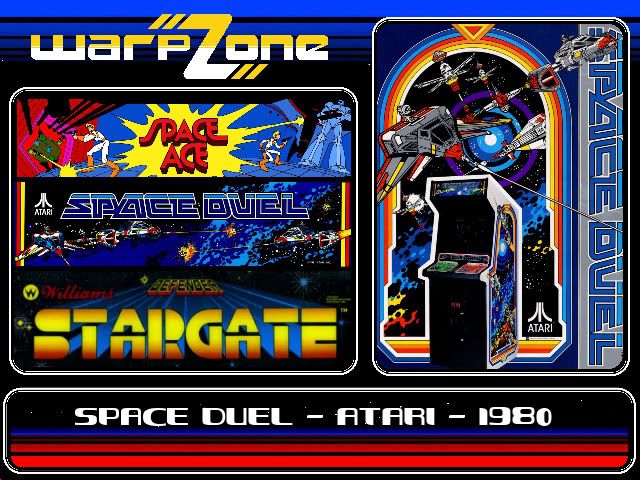

The software is a Tiny XP build, MaLa frontend with MAME+ 124a. I have Daphne for Dragon's Lair and Space Ace, and ePSXe for the port of a laserdisc arcade game called "Time Gal". All integrated into the same MaLa gamelist using SGT's handy guide.

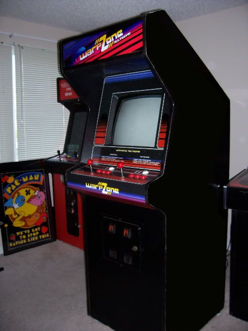

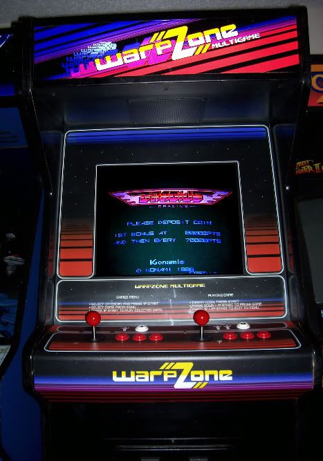

And now, after about 4 months of work, it's done.
Before-
After-

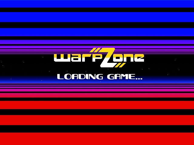

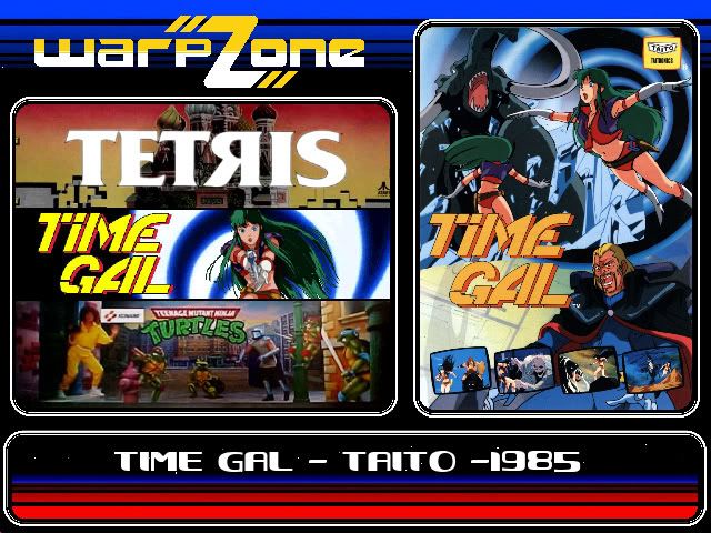

Here's the MaLa layout I made to match the graphics on the cabinet.
So what do you think?
