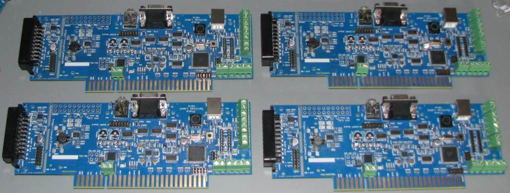

Hi !
After searching for a long time for a hardware that can connect my original JAMMA arcade cabinet to my PC and game consoles, i decided to build it on my own.
All commercially available things (J-PAC ...) need a lot of additional hardware or wiring and none of them can handle a trackball for my favorite game marble madness.
The Project is in the final stage and i would like to hear your opinion if there is a market for it or not.
What does this hardware in principal:
- Connects PC and gameconsole (psx, SNES, more to come) to JAMMA Connector of the acade cabinet
- Makes a full ATX power supply from a arcade supply
- Works with MAME and other PC based emulators
- Emulates the joypads of SNES, Playstation (more to come)
- On board video Amplifier and 8W stereo sound
- Can be configured via USB
- Firmware update via USB
I made some Fotos, that you can see how it looks like.

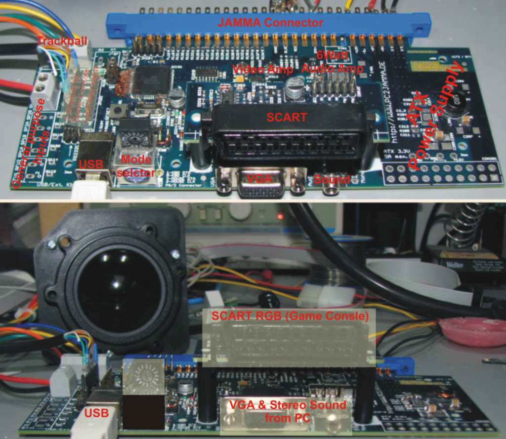

All features in detail:
PC2JAMMA 1.4 Features
On board 5Amps 3.3V switching power supply
Original arcade power supply (+12V +5V -5V) is enough to connect the PC mainboard. Arcade cabinet can stay original
ATX power connector for PC mainboard
4pin. ATX 12V Aux connector
Harddisk + floppy power (+5V / GND / GND / +12V)
15 programmable keysets
5 x USB for MAME or other PC based Emulators etc.
3 x PSX (digitalcontroller, analog "red" and "green")
1 x Super Nintendo "SNES"
1 x Nintendo 64 (planned)
1 x GameCube (planned)
4 x reserved for future use
Keyboard and mouse emulation via USB
Keyset configuration from PC via USB
Defaults for all Keysets in ROM
Stereo 8W/6W audio amplifier
2 video inputs VGA & SCART (selects automatically the correct source)
Controllable video amp (0.7 .. 4Vpp)
Arcade monitor protection from wrong line frequency
Built in SYNC signal divider (configurable)
Extented JAMMA connector with 4 buttons
Additional 12 general purpose inputs for buttons, Spinner, Trackball
Gold plated JAMMA connector
3 status LEDs
Firmware updates via USB

Would you be planning on having a full 6 button layout available for all the 6 button fighting games out there?
what would be the cost?
4 Buttons/Player are standard on the JAMMA connector, you can have additional 6 per player if your emulator supports this.
The only thing to do is the wiring to the screw connectors on the PCB.
The price is at the moment difficult to mention. One prototype PCB costs me approx. 50 EUR (75 US$) plus components, which is another 65 EUR. Population of the prototypes was done by hand.
As a first guess i'd say 150 EUR if i build more than 25 units.
Regards,
Dirk

Some news...
I received the first 4 final PCBs, fully populated.
All of the features are working properly. I'm working now on the configuration software for the PC. When this is ready i'll post some screenshots.
Regards,
Dirk

pc2jamma
  • Posts: 7
  • Last login:October 11, 2021, 08:05:01 am
Ultimarc is using their own cable which fits into the consoles AV output. They are routing this with some electronics to their connector. PC2JAMMA does it in a similar way. Instead of using a special cable it uses the (in europe) common SCART cable from the game console to the pc2jamma.
Dirk

Is there just a pin set to plug the extra one right in?
Yo. Chocolate.
Stephen Hawking
pc2jamma
  • Posts: 7
Look at the photo, the green screw connectors are used for the extra buttons.
Dirk
