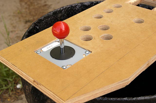

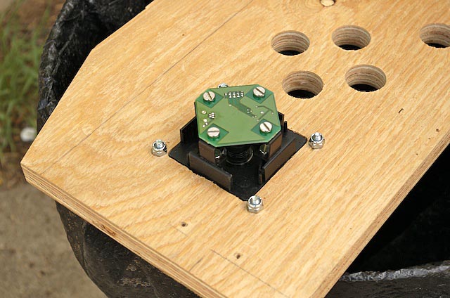

« Reply #2 on: March 22, 2008, 09:34:43 pm »
It was getting on toward 6PM when the FedEx guy finally made it around here.  It must have been a long day for him, he just had two small packages in the van to deliver after mine.  It was a long day for me too, waiting!
The PC is a Dell 2.8 GHz P4 system, refurbished from some corporate IT department apparently.
The huge old Mitsubishi CRT that I saved from the cow barn didn't work with the PC.  I don't know why.  It worked with the Mac Mini when I tested it earlier, so I just don't know why it's compatible with the Mac and not with the PC.
Be that as it may. . .  I brought the PC in the house and connected it to my HDTV set, and I was in business.  I've been surprised at how well things have gone during the short time I've been messing with it.  The computer appears to work fine.  I got MAME running on it, no problem.
I even did some speed testing and comparison with my Power Mac, which is a 2.0 GHz G5.  My quick test showed they are performing very similarly with MAME.  Some games run a bit faster or slower on one or the other, but on the average there's no difference worth mentioning.  STUN Runner at 100% speed is my benchmark for acceptable performance.  The Mac hits about 125%, the PC is getting about 120%.  That's good enough.

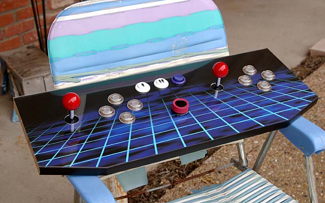

I installed the U360 software, tested the sticks, upgraded firmware and assigned ID numbers.  I gave Ms Pacman a spin.  All working as it should.
I want to put the U360s into my old HotRod controller next, for testing purposes.  Problem. . .   I need the button encoder harnesses for the U360s.  I ordered them with the sticks, I paid for them, the packing slip that came with the sticks listed them -- but I didn't get any harnesses.
I sent email to Andy letting him know what happened, but it's been four days now and I still haven't heard any response.

I ripped all the electronics and wiring out of the old HotRod controller and put the two U360s and TT2 into it.  I thought the U360s would be a drop-in replacement for the original 8-way sticks, but they were actually a bit too wide to fit in the same recess.  I had to go after the recesses with a dremel tool and a mallet and chisel to enlarge them.  The controls are working, except for buttons.  Andy assured me the missing button harnesses are on the way to me.
I'm having more trouble than I expected getting used to the U360s.  I may end up having to get the restrictor plates and stiffer centering springs.

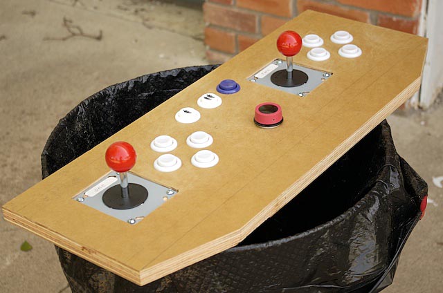

« Reply #5 on: March 29, 2008, 06:58:24 pm »
MDO still not here, but I decided to create a pattern. . .

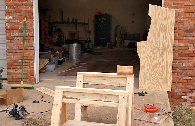

Zobeid
  • Posts: 238
Side Panels

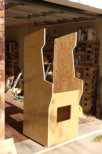

« Reply #6 on: April 02, 2008, 08:04:17 pm »
The MDO arrived on schedule yesterday.  Today I used the previously made pattern to fabricate the side panels.  I cut out the rough shapes, mostly using the jigsaw, then trimmed them with my router and the flush trim bit, then went ahead and did the slot-cutting.  I hope I got the slot centered well.
Handling full 4x8ft sheets of MDO was a bit of a strain.  It makes me glad I didn't use MDF, I would have needed help for sure.  The MDO is 7-ply, it's nice.  I got three sheets but I'm not sure if I'm actually going to need the third one.
I revised and simplified my plans a little.  So tell me. . .   Why do I actually need a back on my cabinet?  I was planning to have one.  It seems not having a back panel means:
  • less wood used
  • cabinet weighs a bit less
  • easier access when tinkering. . . I mean, maintaining it
  • no need for vent holes or cooling fans
Disadvantages?
  • Somebody might stick his head behind it and say, "Hey, this thing is open in back!"
  • Light might spill out from the marquee lamp and be distracting?

« Reply #7 on: April 02, 2008, 08:45:47 pm »
I don't have a back on the upper half of my upright cabinet (based on LuSiD plans).
I agree with your second point of light spilling out, so I inserted a small panel behind the light to block any light coming out of the marquee area... this stopped the 'halo' lighting effect the cabinet was getting on the wall.

The back of my cab is only covered above the back of my monitor.
I have handles built into this panel, so when I tip it back uit rolls on the back casters.
The rest of the back is open.
As long as it's against a wall, no one will see it.
BG66

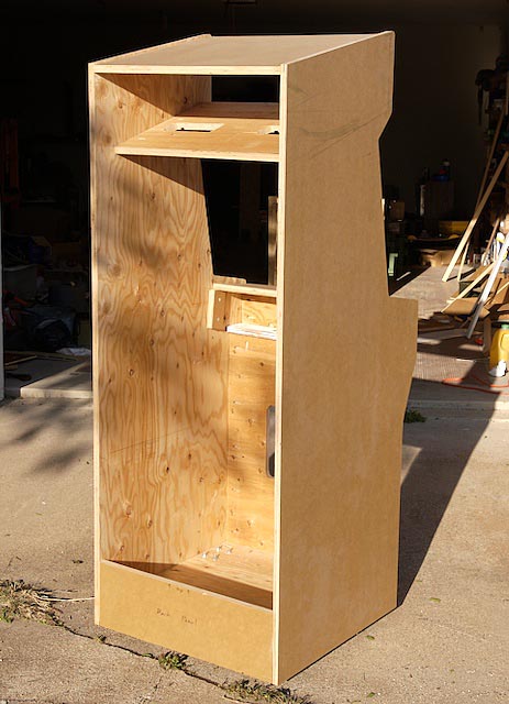

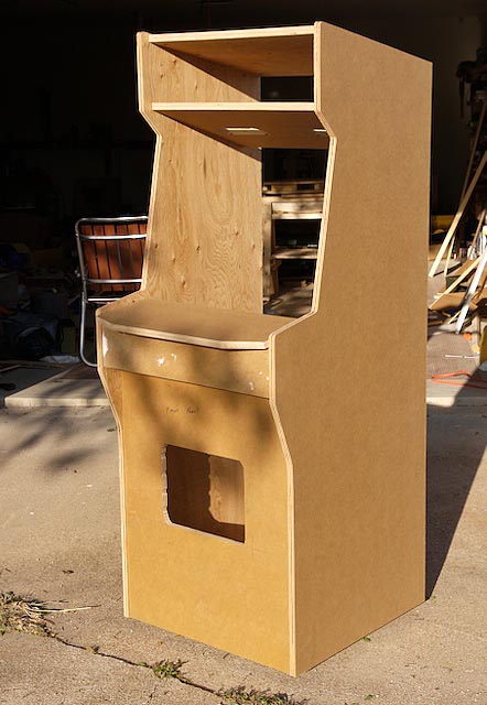

Zobeid
  • Posts: 238
Now in 3D!

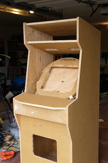

« Reply #11 on: April 06, 2008, 07:51:17 pm »
Today my project made the transition to a three-dimensional structure.
Progress slow but steady.

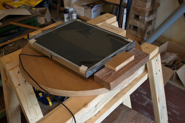

The monitor arrived yesterday, I worked on the frame today.  I rough-cut the two circles with my jigsaw, then made a circle-cutting jig for my router and trimmed them.
The weather was drizzly all day, and while trimming one of the circles my goggles fogged up so I could barely see.  I stopped and decided to step outside and clear the goggles.  As I stepped out of the garage and pulled off the goggles, I glanced down and saw that I nearly stepped on a large snake.
Next job will be cutting an opening for the monitor into one of the wooden circles.
I'm curious how you're going to center the rectangle inside the circle now that it's cut out all ready.  I had a rough time aligning my opening, and I marked mine when the wood was still an uncut square!  Any hints on how you mark this once the circle is cut?
-csa
Not sure why this would be difficult?  Just mark "crosshairs" through the center of the circle and use them to center the monitor, then trace its outline.
Zobeid, not trying to sound like a tool for asking, I just couldn't think of a way to do it once I left the comfort of a square before the cut.  With a square piece of wood, finding direct center was a sinch by drawing two diagonals from corner to corner.  Then using a compass and a ruler, it wasn't so bad marking the rectangle to be perfectly centered in that circle.  On top of that, I had 4 perfectly strait edges to cross check any measurements to ensure dead center.
So you drew the crosshairs before cutting the circle?  If so, then I can see how you might work it out.
If not, how can you guarantee dead center?  You also have a hole drilled out of the center now due to routing, right?  So you can't even depend on an mark being dead center on the wood circle.. you'll have to eyeball that location, and all other marks on the wood would be off by that imprecision.  Perhaps I am being too concerned about exacting math on that part.  Eyeballing the monitor cutout to me, was not going to be good enough to ensure that during rotation, everything was properly centered.
-csa
EDIT:  Guess it is possible after all.. Center of a circle after cut
Ahh, now I get it. . .  mostly. . .
The center of the circle is the 1/4" hole that I used as a pivot point for my improvised compass when I drew the circle outline to begin with, and then used again for the circle-cutting router jig.  Now it's my turn to wonder:  How did you manage to draw and cut circles without a hole in the center?
For what it's worth. . .  If I had to find the center of a blank circle, I'd try using two arcs.  I'd use a compass with a radius greater than that of the circle.  Using the edge of the circle I'd draw an arc across it, then go to roughly the opposite point and draw a second arc.  The arcs should intersect at two points.  A line drawn through those two points will bisect the circle.  Then turn everything roughly 90 degrees and repeat the process, and you have a pair of lines crossing at the center of the circle.
I drew everything first, including the rectangle cutout, then drilled my center hole, routed out the circle, and finally jigged out the interior monitor frame.  I think I'm up to speed now.. and I think I'm now armed with the info I would need should I ever repeat this process again.

« Reply #19 on: April 13, 2008, 07:56:32 pm »
Got the speaker panel installed. . .  I did the cutouts for the Klipsch speakers before putting the panel in.  Also made a blank control panel.  It's starting to look like a cabinet.
Also put together the whole "rotavator" assembly. . .
Not sure how I'm going to support that thing inside the cabinet while I position and secure it.  It needs to be placed at a rather awkward angle.

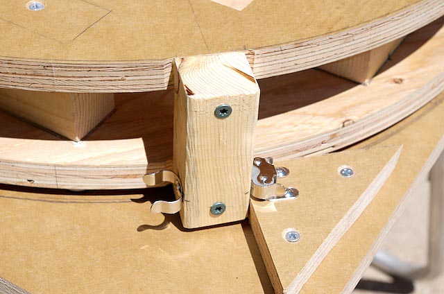

« Reply #20 on: April 15, 2008, 04:09:23 pm »
I thought some of you might like a peek at this. . .
I used roller catches to secure the monitor frame at either end of its travel range.

« Reply #24 on: April 16, 2008, 07:07:22 pm »
I can hardly believe I reached this point.  Today I installed the monitor support panel, which is the foundation of my whole "rotavator" assembly.  This was the last major step of assembling the basic cabinet.
This photo gives a good idea of how it's positioned in the cabinet, the screen angle, and you can also see the handle at the top which the user will grab and manually rotate the monitor.  It will require a fairly elaborate bezel with one part fixed and the other part rotating with the monitor.

Control Panel
« Reply #25 on: April 26, 2008, 11:29:48 am »
After a number of experiments, I decided to have somebody else paint the cabinet for me.  I dropped it off at his shop yesterday.  Then I went back to work on the control panel.  Check it. . .
Top-mounted U360 goodness!
And the full layout. . .
I love it when a plan comes together.

Looking good! Are those U360's mounted 90 degrees from normal? Mine have to have the plate wider in the horizontal direction. (Although it's quite possible you can take it apart and change that, or that you're just remapping in software...)
Fairbanks, Alaska (<-- anybody else from AK? pm me)
One (crappy but usable) desktop/laptop control panel
Williams "Smart Set" EM pin (webpage to come)
Zobeid
  • Posts: 238
Re: Project A-ko / Rotavator
« Reply #27 on: April 27, 2008, 03:37:48 pm »
All it takes is a few seconds with a screwdriver, to remove those top plates and turn them 90 degrees.  So you can orient them either way.

Today I wired my control panel.  Biggest problem I had was crimping. . .   First I had a cheap Chinese-made crimper that just wasn't going to get the job done.  After replacing that, I found the U360 encoder harness has wires so small that they still didn't want to crimp too well.  Ah well. . .  I eventually got it done.
I also made a crude box, hastily cobbled together from some old, water-damaged 1/2" plywood, that I have set my panel in.  This way I can test it and play around with it until my cabinet gets back from the paint shop.
Unfortunately, I think I have now hit an unforeseen obstacle that threatens to stop my progress dead in its tracks. . .   It's called Typhoon 2001.
This game is incredible.
I always wanted to play Tempest 2000 with a spinner, and I've got to say it's as good as I imagined.  I had to turn the mouse speed adjustment way down -- I ended up with it set on the minimum, but it works well with the TT2 spinner.
Oh yeah, Tempest works quite well in MAME too.

I put extended discussion of the rotating monitor into its own thread here:
http://forum.arcadecontrols.com/index.php?topic=80459.0
