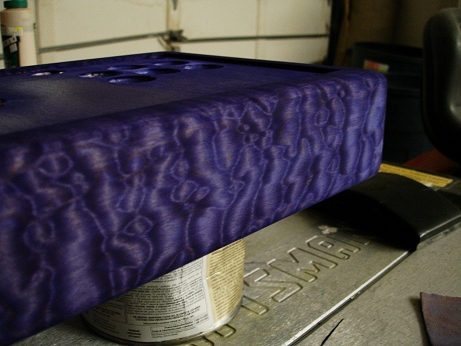

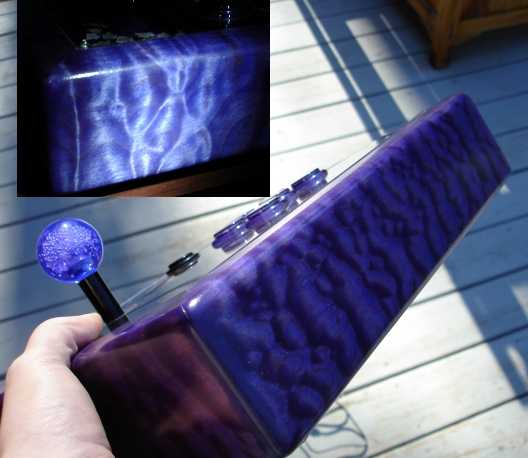

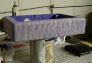

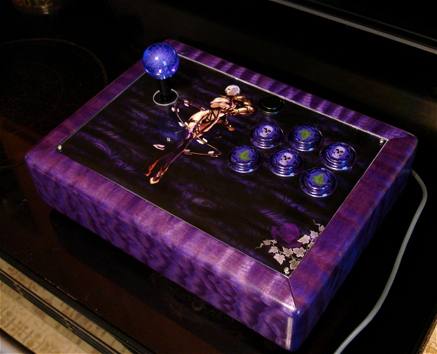

I was going to wait to post more of these since I have a few almost done but I'm waiting on some materials and figured I've waited long enough. Anyways a while back, last June to be exact I happened by Byrdo's site and thought his sticks were pretty cool. I then saw Timoe's post shortly after detailing the process of making sticks and I decided to try and make some of my own. Then I saw Kaytrim's as well. I bought some wood on eBay last August, some quilted maple and curly maple. Finally got parts ordered in September but I put things on hold because of the Mother Brain project. I figured I'd like to build two sticks for every console I have.
I purchased some Xbox 360 pcb's from HarumaN who does most excellent work soldering and hot gluing the pcb's and this is the first stick I made with one of them. I wanted to try and get a "PRS" (Paul Reed Smith) style guitar finish on this one by using 7/8" quilted maple and purple TransFast water based wood dye. First, I cut the wood pieces, glued it together then rounded over the edges with a router. Sanded by hand (of all the tools I don't have, a sander is one of them hehe) until 220 grit. I then took a damp paper towel to the maple and sanded again with 220 after waiting an hour or so. Repeated the damp cloth/sanding two more times in order to raise the grain several times and then lightly sand it back down so the water based dye wouldn't raise it too badly. Then I applied the TransFast purple dye diluted in warm distilled water with a foam brush. Waited a few hours, then lightly sanded with a flat rubber hand sander with 220 again in order to leave more dye in the grain areas and thus darken them for the second coat of purple dye.
Threw on a second coat of dye...
Then waited a day and then began clear coating with Minwax Polycrylic. I chose this because it is more of a true clear coat for going over colors and supposedly won't amber the color as much as polyurethane. The "lightning-like" quality of the quilted maple really started to show once the clear coat was on. Sanded up a few grits 400, 600, 800, 1200, 1500 and then used 3M rubbing compound and Mylan's wax for an almost-mirror finish. The cp is made from baltic birch and the Soul Caliber Ivy inspired artwork I had printed by MameMarquees. I originally planned to use clear Ultralux buttons so the button discs I made out of MameMarquees marquee material would light up, but when I saw that Seimitsu came out with the new screw style translucent buttons I opted for those in purple. The stick is about 2.75" tall because I originally planned on longer buttons. I actually like it tall like this, it sits well in your lap and it's quite heavy. The small pic within the larger pic shows some of the luster of the quilted maple but its brighter in person.
It's interesting to me why there are no translucent purple buttons aside from Seimitsu's? They must have the market cornered on translucent purple goo.
I wired the Xbox guide wires to a red Wico button and fitted the base with a red led a la Knievel's leaf lighting method 101tm :) The red guide button led is wired in parallel with a few other red leds and they are powered by the 360 controller's rumble wires. No resistor necessary since the voltage is about 2v or so. I used violet transparent plexiglass I found off ebay for the bottom of the case. The light from the violet leds (violet leaning towards blue more than uv spectrum from superbrightleds) serves as a bit of an "ambilight" hehe along with the light from the red leds as well. I took the pcb off the Sanwa JLF joystick and used cherry microswitches instead since the 360 controller has no common ground. The red wico but is quite blood red but it shows up orange in the camera.
The violet leds/buttons look much more purple in person too. I'm pretty happy with how it came out. One thing about the areas that may look brownish in the pics, this is from the quilted maple being golden (still expensive but not as expensive as the lighter kinds) so its kind of darker wood in areas and in some areas the dye didn't adhere quite as well as others. Still the brownish areas are not pronounced at all like they are in the pics as opposed to in person. It was easier for me to make I think because I have a few cp's under my belt now and can look at other people's projects like Timoe and Kaytrim and pick up a thing or two (like the 400-2000 grit sanding stuff... never sanded much at all in my life til now hehe) One area where I didn't do too well or well, neat, is the wiring, that is hidden though behind the violet plexi! I must give special thanks to HarumaN for the excellent pcb hack and Timoe and Kaytrim especially for detailing their methods of stick making. Oh yeah, one more thing, I used a black 24mm Seimitsu button for the start button, because of the artwork I dropped the back button. I'm hoping that one doesn't come back to bite me at some point!

I haven't done anything to this yet, but I'm thinking of making a thin profile 2 player stick with this 1/4" piece of quilted maple. It's about 22" or so, and it's the lighter variety of maple that should have a bit more pop. I was thinking of dying it deep red, clear coating with gloss and housing it within mdf sides of gloss black to make it sort of evil. Perhaps if it came out pretty well I'd even build some kind of cab for it.

Finished! Xbox 360 controller with Chun Li theme. Curly maple dyed sapphire blue with polycrylic clear coat and Ultimarc's Ultralux buttons w/ Groovy Game Gear's MicroLeafs w/ MameMarquees marquee material cut for the button discs. Works real nice the marquee material illuminates just fine in the clear buttons, the buttons are a bit brighter than the pic, but I switched my camera's setting to nighttime to get more detail. When I got an arcade marquee printed from Mamemarquees I put some of these button discs in the extra space and cut them out to fit the buttons. I tried to make them look like Chinese lanterns and coordinated the colors of the 360 buttons in the lantern graphics. I made the button designs sort of transparent too so they seem like they are printed on rice paper. The Mandarin letters are Chun (spring) Li (beautiful)
Thanks to HarumaN once again for the hack, he also hacked the rumble motors for this one. I took two mini-sd card holders and drilled a 3/8 hole in each of them. Then placed two white superbright leds in each hole, hooked them to the rumble motor wires and screwed down the sd card holders. Didn't use a resistors for these rumble leds as I think it's somewhere around 2 volts they're getting when activated. Used translucent blue plexi for the back. Took out the JLF's pcb and used cherry microswitches instead since no common ground.
