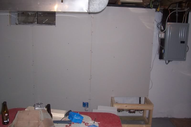

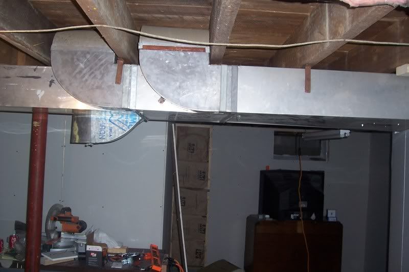

« Reply #4 on: March 11, 2008, 10:31:59 am »
and finally here are some pics.  the job site was eerily quiet this weekend.

Why such narrow drywall pieces?
I actually sort of fear doing drywall because I have to do everything by myself... I don't know I'd do that great a job with hugeass brittle sheets alone.

« Reply #6 on: March 11, 2008, 11:01:07 am »
some of the pieces are narrow because my 6'3 240lb little brother is a beeyatch.  I can call him that because he's family, he owes me a small fortune and I've bailed him out of numerous jams. Twice he came over to help me hang some drywall and twice he came down with some mysterious illness.  On his final trip I just had him help me hang some big pieces.  I then went back to hang the odd shape pieces myself by cutting it up into manageable pieces.
** caution - carrying and hanging drywall is a man's job.  I never thought I would say that, but it is **
Finally last week some help arrived to get me started on the ceiling.  For those keeping score at home here's a quick tally of the cash I spent so far.  Keep in mind I didn't touch the plumbing and I didn't move my breaker box as the old lady suggested.
