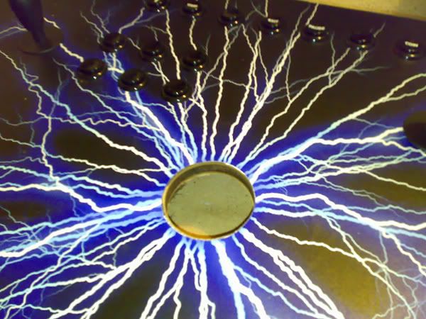

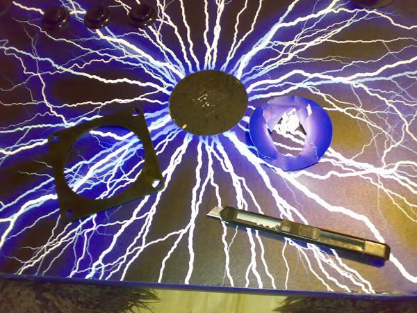

not the best idea but i didn't think i'd want a trackball but after much thought i decided i'd have to get one but i'd already stuck my cpo on as it was the adhesive type and not the paper with plexi over it so i set about put the trackball in without a mounting plate

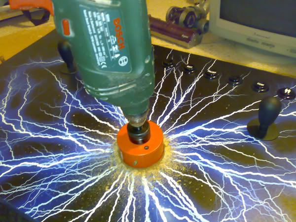

first of all i cut the center circle out on the cpo with a craft knife and the mounting ring that i got with the trackball
then i used a 3"hole saw to cut it out
thankfully that went alright

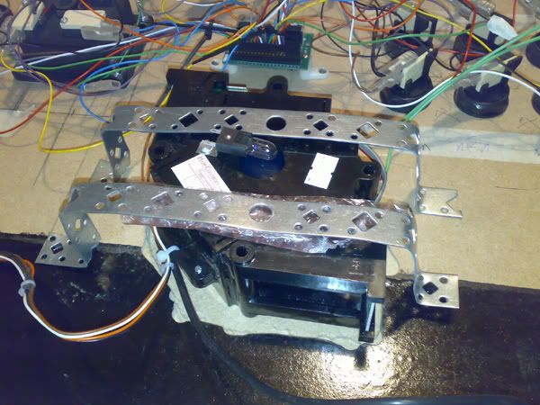

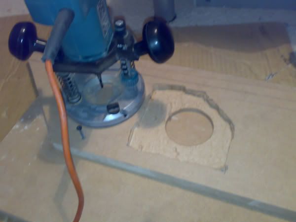

then i tested out my mates router on a bit scrap mdf to see what size recess i'd need

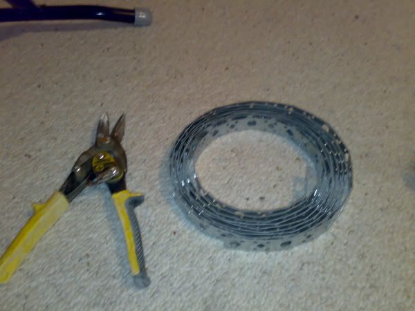

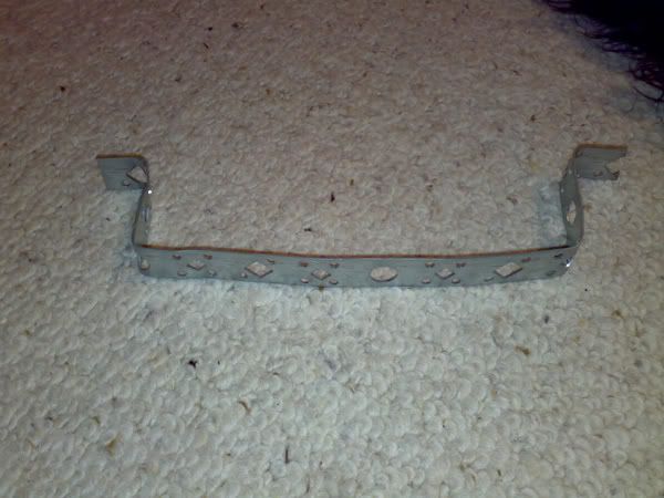

then i made some brackets out of some metal that i'd got from work(used for metal stud partion walls)
with brackets temporarily fitted

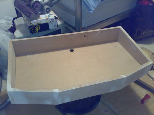

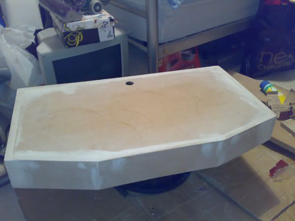

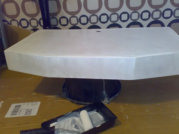

then i had to make the cp box larger to accommodate the trackball it used to flat across the front but now it's angled the same as the cp

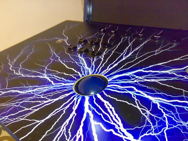

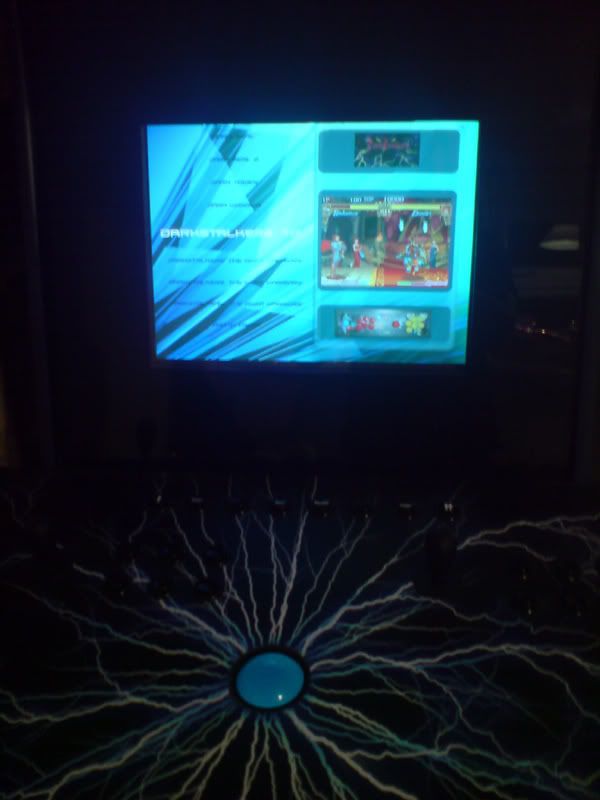

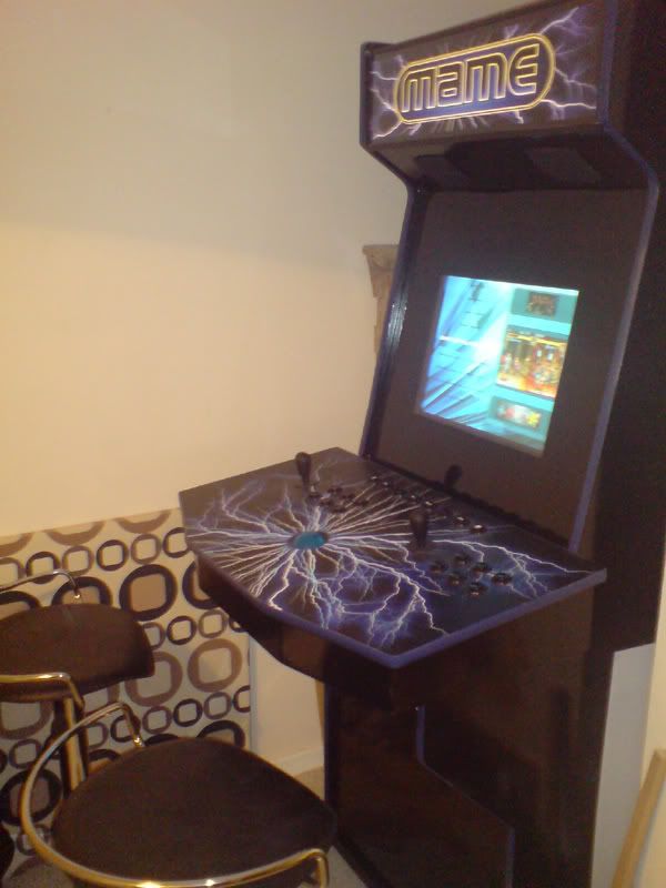

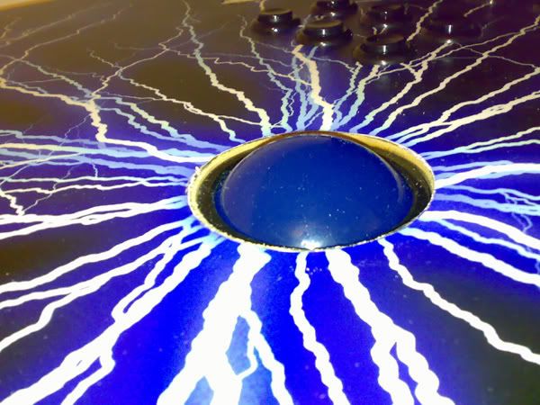

this is with it in(still got to paint round the edge in these photo's)

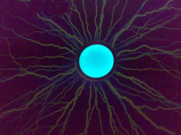

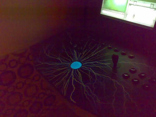

illuminated
finished(i doubt it!!)
next up some translucent buttons with blue led's and can you get translucent balltops(with blue led's fitted) in the uk? and i need to get a 4 cluster blue led for the trackball as it's a bit dull
