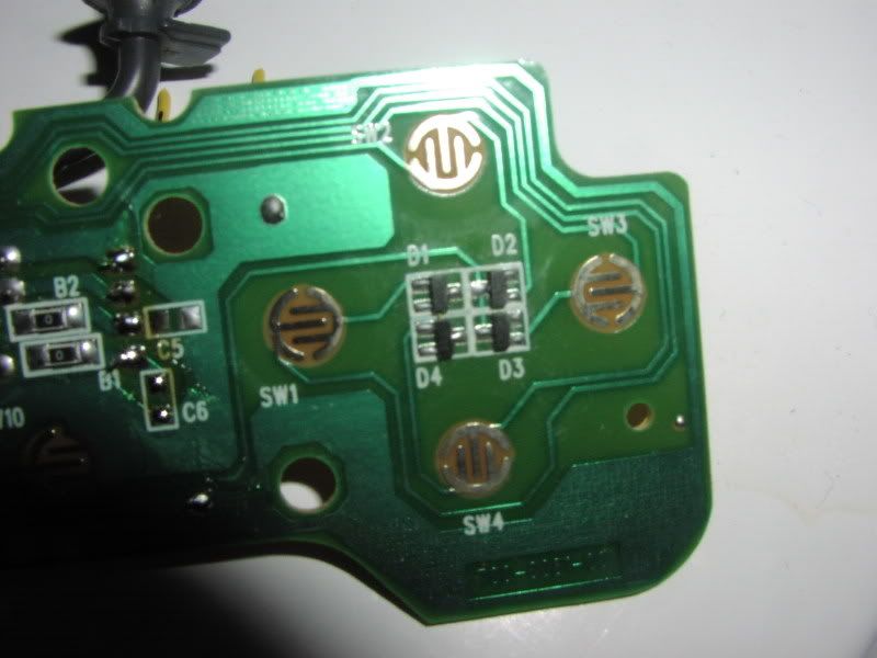

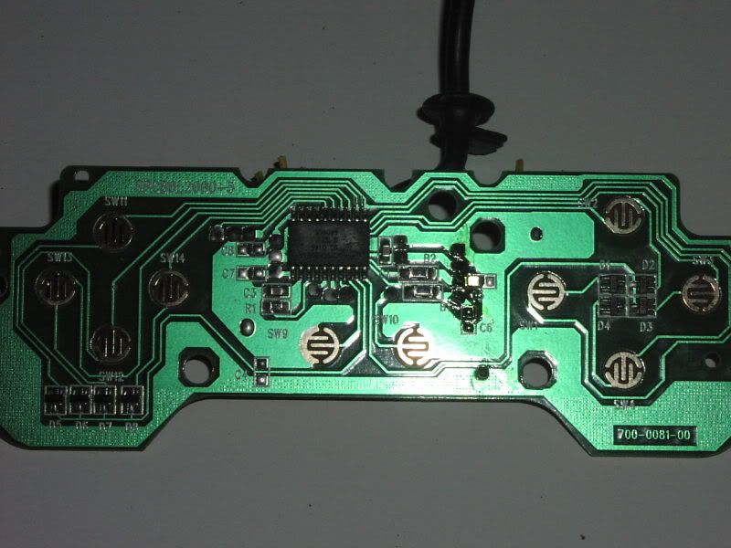

Hi,
I am making a guitar controller for use with the guitar hero clone, frets on fire.  I have a bunch of microswitches, and a gravis gamepad pro (usb).  Thing is, I don't know where to solder the micro switch wires to on the gampad.  I can't tell the power connections from the grounds.  Could anybody help me here?
NiN^_^NiN
  • Posts: 921
Re: diy budget guitar controller
« Reply #1 on: November 20, 2007, 06:46:14 pm »
It's quite simple
For you to use a switch you need to solder to either side of the button on the pad
You need to solder to one of the half circles with the 2 lines in it
Then to the half circle with the 1 line in it
Se how they dont touch? well thats how the button will work if you solder onto each side the microswitch with trigger the pad button :)

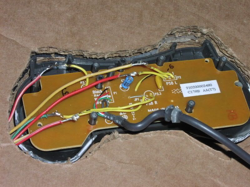

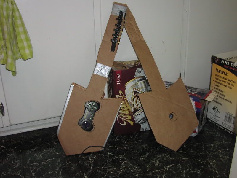

Thank you for all the replies guys!
I only needed to wire up five buttons.  Which is good, because I've read that using the four diamond layout colored buttons on gamepad pro's results in ghosting.  So I used the R1,R2,L1,L2,and Select buttons.  I'm using the D-pad for strumming.
The total cost of this project was $0.  I had the gamepad and switches laying around, also had the wire and solder.  To be honest I think this project may be the most punk rock thing I've ever done.  I made the guitar out of cardboard.  Not just for ease of use and lack of sawdust, but for maximum endurance durring jam sessions due to it's light weight ;D  I still have some tweaking to do, and I may actually make a wooden guitar in the future.

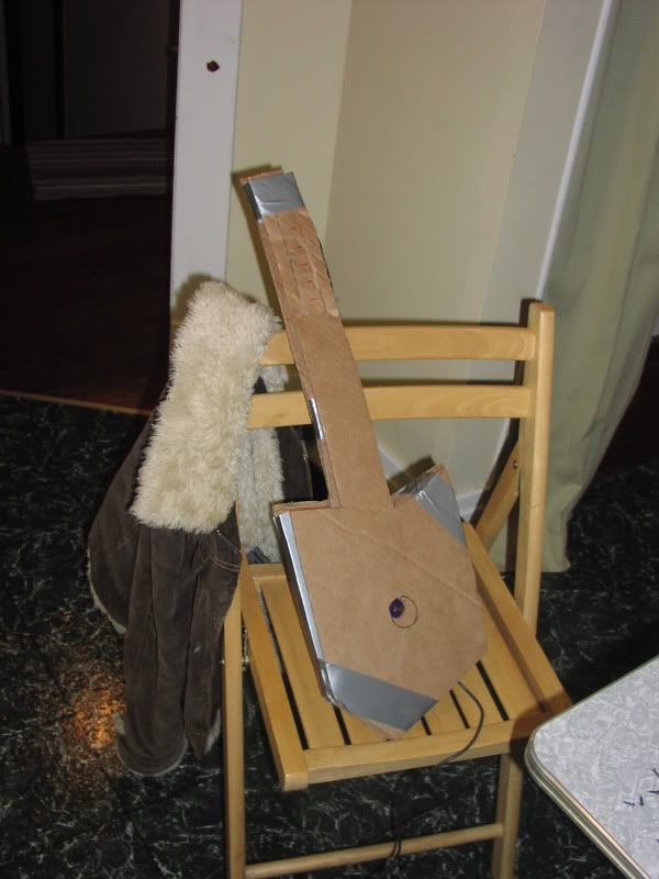

Yeah, my fiancee actually seems upset by this 'card-tar' i made.  Hah!  She want's me to go to goodwill or walmart and get a toy one to modify.  I'm thinking of making my own though.  I would like to design one in the 'flying V' style. http://www.rocknrollvintage.com/prodimages/1981%20gibson%20flying%20v%20large.jpg
But in the mean time, this 'card-tar' works really well.  The strummer is a suction cup ontop of a screw.  The screw threads right into the gravis d-pad.
