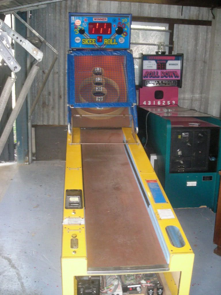

I have seen the threads on the DIY Skee-ball and have decided to start one for myself...however I was wondering if anyone could send me the dimensions of the cabinet / runway and also some idea on the size / shape of the ramp?. On another note I would like to keep this project on a budget and as such how can I do the scoring on a budget?...Dosent have to be anything special just a basic system to keep score?. Thanks.

I don't have any dimensions for you, but I have several ideas as to how you could approach the scoring.
1.  Build a control circuit that takes inputs from switches in each score tube to add the apropriate number of points to a readout.  It would take a reasonable amount of electronics understanding, but the parts would likely only be about $30.
2.  If you have a spare computer sitting around, or look for a free old one on Craigslist or similar places, you could hack a keyboard or joystick/game pad to send inputs to a simple program that added points to a running total and displayed it on a monitor or LED readout.
3.  Same old computer, use an encoder from http://www.GroovyGameGear.com, or http://www.ultimarc.com to do the input and a monitor or led readout to display the score.  Still requires some custom software.
4.  Hunt down an old dead skeeball game and steal the electronics out of it.
All those options would need refinement, and I've not done any of them myself, but none would be too difficult.  The cheapest options depend on what you have laying around, and how resourceful you are.

Oh, yeah, you were probably hoping for a useful answer...  I would suspect that a switch similar to what the coin mechs use.  It's a momentary switch with a wire, if you rigged it so the ball had to push past the wire on it's return path to the hopper it would trigger an input on the circuit.
As far as the scoring circuit itself, I imagine a hybrid version of some digital readout counter project that counts button presses or something, if you had a series of them that increased the readout by a set quantity (corresponding to the ball switch points) and an input that would reset, based on a timer or number of balls that would basically handle it.  It may be a good project for something like a nutchip that DaOldMan has talked about in another thread, or a programmable micro-controller of some sort.  I'm not too well versed in circuitry, just basic electrics.  The switches make sense to me, but the logic control is something I am just now trying to understand myself.

Many of those dimensions were in some of the posts by UncleT.  If I remember from reading them correctly, he'd be the best person to hit up for some of this information, have you dropped him a PM yet?
I also read through the skeeball posts and anything they linked to.  There is a link to a simple counter circuit that could easily be made into the score system, especially if you wired the switches to be 10 points each and the ball passes multiple switches to accumulate higher scores.
The easiest solution though would be to buy a Key-Wiz from RandyT at Groovygamegear.com and then hit him up for the skeeball software he created.

Well, I just found this thread myself now .... a little late.  However, I did recently receive a PM from "lamboman" and thus have placed all the dimensions of my Skeeball machine on my site for him ...... just click the skeeball machine picture and then click on the "Photos" link on the bottom:
