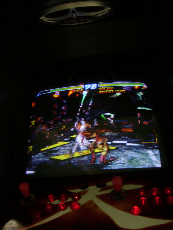

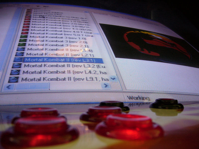

MAME32 select screen from on top of the CP and My fave MK, Mortal Kombat II running from the same perspective.
One of my all time favorites (other then SF and MK), Killer Instinct 2 and it runs 100%

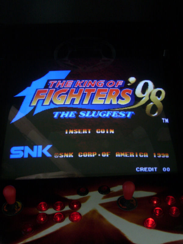

My buddy Sam's all time favorite King Of Fighters game

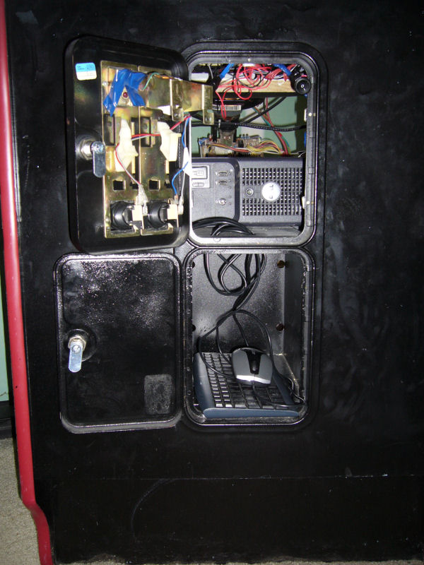

Sega/Gremlin Cabinet, Originally a Pengo, still has factory papers inside
Painted Black, new red T-Molding.
Eygo 27" VGA CRT Monitor, limited to 640x480
Control Panel is based on a HotRod SE but is slightly wider, IPAC2 encoder
14 translucent Red FXbuttons, each has a red LED inside with Cherry micro switches , red cold cathode under the coin door illuminating the kick panel
Computer is Dell Optiplex 210L 2.8 GHz Pentium 4 w/Hyper Threading  1GB of RAM, on board sound and video because its a 1/2 size case
the wiring is an absolute nightmare, if I ever redo it, I'll do it much better, I was just anxious to have it done. I took the camera, and pointed it up from inside the coin door and got this beauty:

back door removed, so you can see the insides; including my drivers license from 12 years ago.
plenty of room for storage at the bottom!
it runs KI2 and UMK3 and SFA3 and KOF2000 all perfectly at full speed (when I hit F11 it says fskip 0 100% 60/60 fps   on KI2 , same thing but 53/53 on the MKs)

I've really been trying to get MALA to work the way I want but it doesnt like me as much as I like it, so for now, Im using an updated MAME32 (.118) with updated ROMs.
in my play Ive found I really dont like the translucent red buttons, they feel too stiff and since Im not using an LEDWiz there really isnt a point in using the LEDs considering I dont like the  translucent buttons, so out they came.... man that wiring was HIDEOUS!
