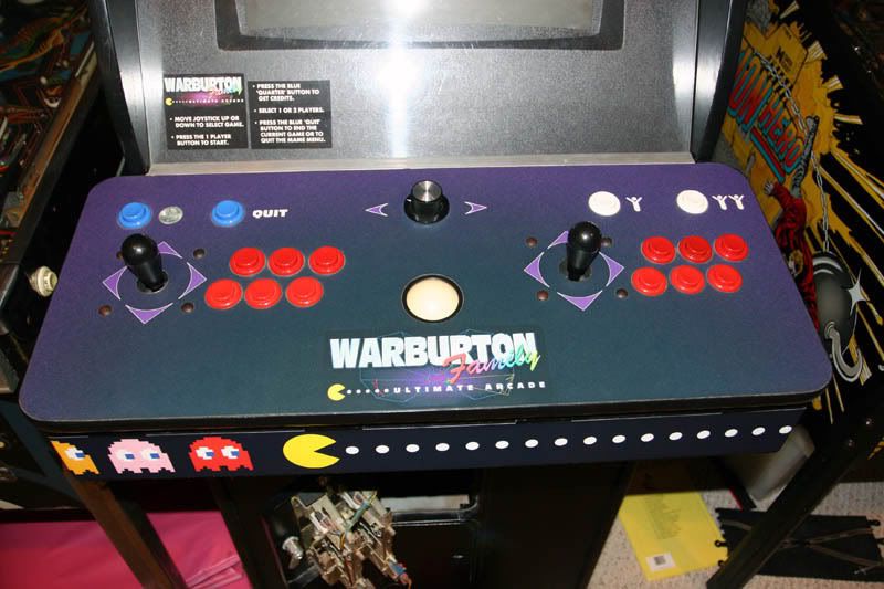

this is what i have. i don't know anything about it. where can i start? the computer is taken apart.

Looks like you have a Jpac and and Optipac.   Means that your cabinet is JAMMA wired.   Your buttons and monitor interface thru the jpac and the spinner and trackball interface tru the optipac.    You can choose to have someone set up a hard drive or computer for this configuration or you can hang in here  a while and you will be able to do it yourself and maintain it yourself.
My first question is what is not working?   Did the computer die completely?  Something as simple as a new PS could revive the computer.   Who took the computer apart and what has been done with it?  A little more into may help resolve your problem.

here is another pic or two.

"Out of range" and your new pictures indicate that the builder used a real arcade monitor instead of a PC monitor.  That's why the HD won't work in another computer- it's forcing the video card in the computer to output a 15k arcade signal instead of a regular VGA signal, and the computer monitor doesn't like it.
If the problem is that somebody broke the video card on the computer in the cab, buy an exact replacement for that video card on ebay- same brand, same model. By now it'll be old and cheap.  Put the PC back together and cross your fingers.

Could you take pictures of the old video card?  Since everything else was ultimarc it might also be an ultimarc product like an avga card.  If it is  it is not quite as easy to get a cheap replacement for it.
