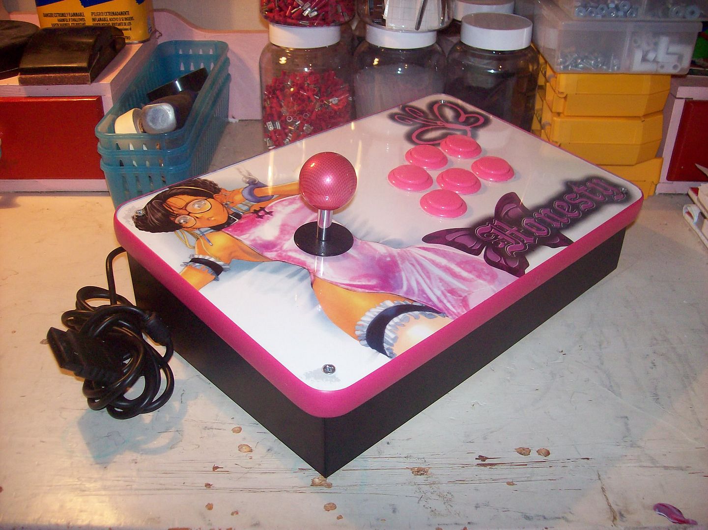

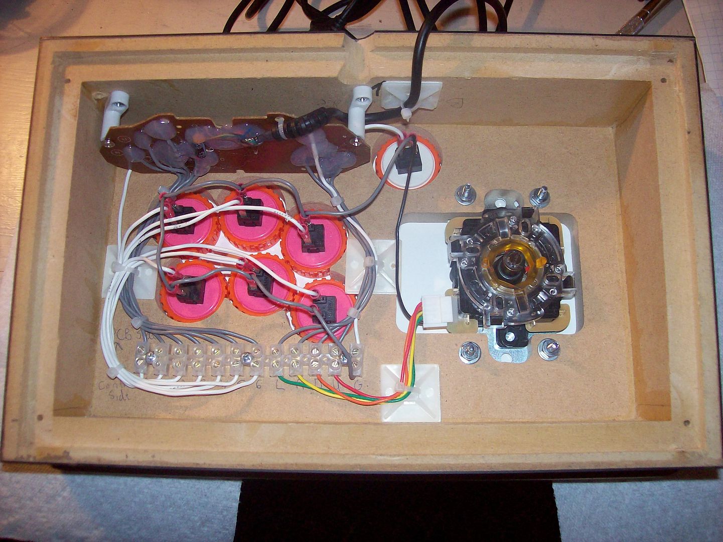

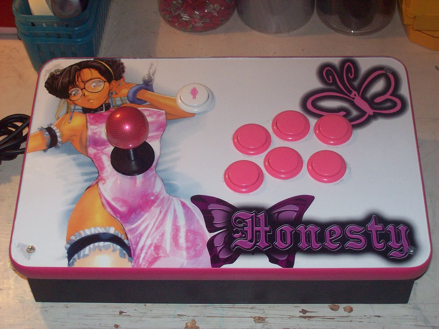

The 2 best materials in my experience have been baltic birch plywood for the body and MDF for the top. Baltic birch plywood is very light and very sturdy. I like MDF for the top as it is uniform in thickness and flatness and because it machines very easily. What style of joystick are you building?
Here's a couple of mine.
I really like that stick with the sanwa parts on it.  It looks amazing.  I'm just starting out and I just wanna get as many tips as I can.   My gf bought me a router for my bday, but I have yet to even touch it.

Looking at the middle pic bottom row I see tones of quick disconnects and wire ties and other parts in the background.  Where do you get your supplies?
TTFN  :cheers:
Kaytrim
Here's most of my sources. I generally buy in larger quantities to save a bit. A lot of my sources are ebay sellers.
Here's the list:
.187 Quick Disconnects for Happ buttons and sticks and seimitsu sticks.
.110 Quick Disconnects for sanwa buttons.
Euro Terminals for wiring up the insides. No more paying $2.59 each at radio shack. ;)
Acrylic or Polycarbonate sheet for making control panel overlays. Fast shipping and much less than what you'd pay at Home Depot or Lowes.
This is the seller where I get my rubber feet from. They're not listed at the moment, but the ones I use are 15/16" diameter.
Plastic Jars, just in case you were interested.  ;) I buy the 26 oz size. Check out his site as he has a lot more sizes and styles.
A good source for Baltic Birch Plywood. Sells decent sized pieces for not too much. Good quality stock. This place is especially useful if you only need a little bit for a project. I'm favoring baltic birch plywood as a building material now because it's stronger and lighter than MDF.
That about covers my online sources for the most part. I get my glue, gluesticks, exacto supplies, and cable ties from wal-mart. I get wire (22 awg stranded) and soldering supplies from radio shack. Hardboard (for joystick bottoms), plastic laminate, contact cement, wood glue (titebond FTW), and other misc items I get from Lowes (closer than home depot). I got the square cable tie mounting plates from home depot a while back, but would do an ebay search if I needed them again. And I get most of my tools from amazon. ;)
Hope this helps you out some. Let me know if I left anything out.
