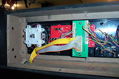

I'm now also having that issue where the board won't startup all the time and it takes multiple power cycles to boot.
I've read earlier that replacing C2 (10uf @ 10v) on the board fixed that.
Where is this board located in this machine? Is it in the plastic box that also hold the cartridge? Or is it that green board located under the joysticks?
Pictures from RetroBlast:
The circuit board is in the "cartridge" which is the top part of that picture above the blue tv.

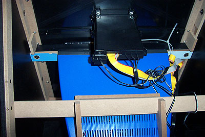

« Reply #123 on: May 09, 2022, 04:28:56 pm »
Has anyone here successfully removed that cartridge in the Midway machine? Doesn't seem to remove from the front of cabinet, so I removed the 4 screws holding it in from the rear of the cab (as shown in the reply above mine). Pulls out perhaps a 1/8 inch, can't get it to budge any further. If I pull any harder I feel I might break it right through the backboard. The front of the cartridge is preventing me from pulling it out from the back due to two "latches" holding it in from the front. Seems like it should just pull out from the front (to insert another cartridge, implied by the "series 1" marking on the cart), obviously no other cartridges were made though. Should I just keep pulling from the front or rear until it comes loose? Could it be inserted that tightly? I wonder if it's actually glued in due to Big Games knowing there would be a further cartridges.
I was encountering  that issue that other owners have had in this topic of having to turn the cabinet on/off a couple times until it successfully booted (you would just hear a buzzing and a non-image on the screen). Was going to replace the C2 as discussed earlier in this thread. But about a year or so ago I just wiggled the cartridge, from the front of the machine, and have had no issues the entire year until yesterday. I figured the cartridge slots might need cleaning, the reason I'd like to pull it out.
The cartridge does NOT pull out.  It is not removable or replaceable without taking it out and taking it apart.  You have to detach it from the back and then it's in an outer shell that has to be unscrewed.  Inside the case it's the "cartridge" with RCAs for AV, a flat ribbon connection to the control panel, and power.  I also feel like there was a clip that held it in place too, but I have mine out because I replaced the bezel.  Hopefully some pictures will help.
The only "cartridge slot" is the ribbon cable/connector for the control panel.  Not sure that would affect boot up.
