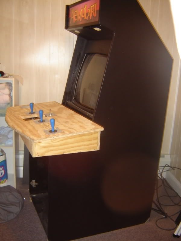

Hey guys, Since I have been working on my cab for about 2 yrs now I figured it was the perfect time to announce it, since noone is really interested in the whole progression thing </sarcasm>. I actually had the cab finished, minus artwork but it wouldn't fit into my living room with the 5' wide frankenpanel on it. So I tore the panel off and began constructing a more normal sized CP.
Currently I have the new panel about halfway done. I am also working on a custom intro video for my cab, so far the logo screen is finished, but I am having trouble finding "exciting" game footage without recording it myself. Perhaps someone has a suggestion?
I will try to get some photos up tonight so everyone can take a gander.
**UPDATE**
Ok so here are some pictures  ;D
and here is my logo video:
It is nearing finish but I still need to finish the cp and few other small things. As you can probably tell the artwork was influenced by Dragons Lair. Actually some of the parts came from an original DL (coin door, speaker grills, flourescent light fixture). Be easy guys, this is my first cab and I will just say that I have learned a lot during the 2 years of this build. Let me know what you think.

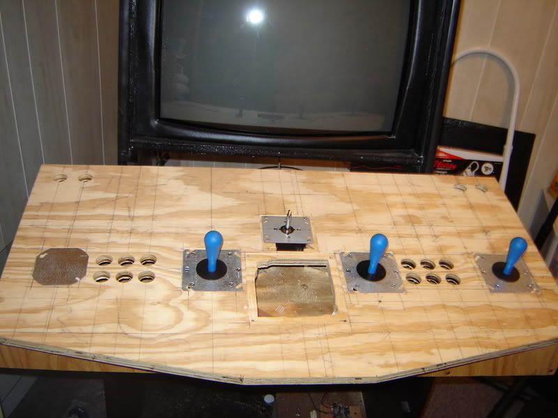

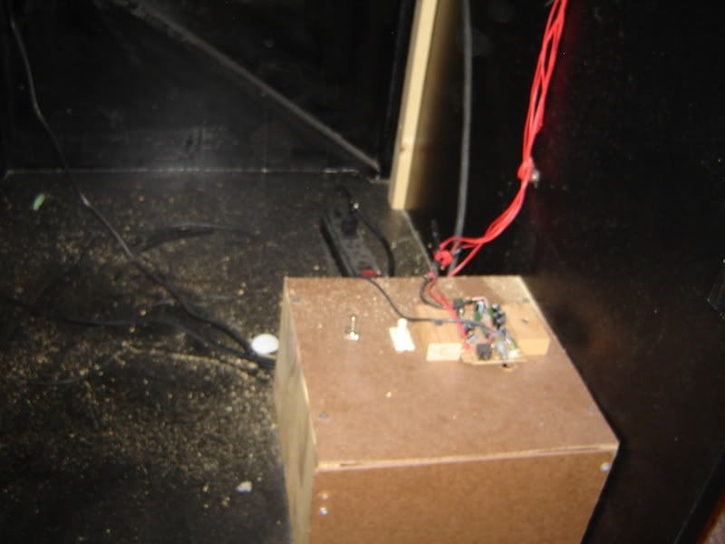

What was your reason for using electrical j-box covers as mounting plates for joysticks?  So that you could change them (to something else) later without having to re do the woodwork?
What cha got in that there electrical box?
Sounds like youre having fun... good stuff

mounting plates: so I could flush mount everything and for easy removal if I want to switch out anything.
electrical box: A ham sandwich, incase I get hungry  ;D Actually it is just the wiring for my toggle switch, momentary contact switch, and speaker amp. I made it to have something I could mount my controls too as well. The toggle switch interrupts the main, it puts power to everything in the cab. The momentary contact switch is to turn the TV on (easiest way for me to do it since all other options were ruled out). The speaker amp is ripped from a pair of cheap altec lansing speakers and well you know what that is for. Nothing spectacular really.
