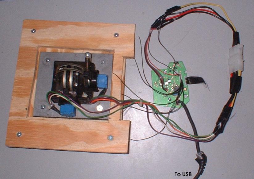

I wired up 2 Leland spring analog joysticks using 1-Up's hack, using the MS SideWinder Dual Strike.  It was very easy, and it meant that I could use the original pots from the arcade joystick.
Here's a picture of the setup:
Using 1-Up's instructions, the hack was almost too easy.  It was very straightforward, so I won't try to complicate it by explaining it myself.  If you run into any questions, though let me know and I can help you out.
I ended up getting several of the Sidewinder Dual Strikes for around $12 shipped apiece I think (ebay).

This is an old topic...new question -
I have succesfully hacked a dual strike to a leland stick (ala john elway QB).
When I use the Dual strike test program, everything works and reacts as it should.
 Problem is I can't seem to get Mame to work with the stick correctly (sometimes the stick moves, sometimes it doesn't, when I release the ball isn't thrown...etc) ...anyone else had any toubles with this?  I just wanna play John Elway QB....!!!
Thanks in advance.

You guys are the bomb...Turns out on JE QB I had to adjust the sensitivity to 220% and the speed to 200 to get a playable game - but all is good now.  I have JEQB!!!  The original  mapping has the game joystick in sync with the analog stick...which makes no sense to me.  Had to re-map P1 to just up,down,left,right, and then the AD stick X/Y to the leland stick only (original map had U/D/L/R and AD stick X, Y combined in one joystick)
Interesting.  I'll test my computer tonight (hopefully) and see if I need to set the values as high as you do.  Just to be clear, you adjusted player 1 AD_STICK's sensitivity to 220%, and keydelta and centerdelta to 200?  (Or are you using an older mame before centerdelta came up?)  Or are you talking about a different "speed"?
FWIW, here's what's going on.  Since most games only have an 8-way or (exclusive) an AD_stick (analog stick), not both, mame's default mapping is to map your physical joystick to both "8-way" and "ad_stick" type inputs.  This means the few games that have both 8-way & ad_stick need to be remapped like you did.

Turns out on JE QB I had to adjust the sensitivity to 220% and the speed to 200 to get a playable game - but all is good now. ....  Had to re-map ... the AD stick X/Y to the leland stick only ...
I tested with a gamepad + rubberband on the analog stick, not a real springstick, but ... I didn't need to change the sensitivity or speed.
Your needing to set the speed so high might mean you mapped the springstick to both the analog and the digital inputs for mame's AD_STICK?  (Or more likely, left the digital part as mame's default.)  I know you said you remapped, but it might have been "almost perfect"?
As a general rule, the analog springstick should be mapped to the analog part of the game's analog input port, not the two digital.  IOW, the tab, "Input (this game)" should look something like:
AD Stick X Analog     J1 X axis
AD Stick X Dec         None
AD Stick X Inc          None
AD Stick Y Analog     J1 Y axis
AD Stick X Dec         None
AD Stick X Inc          None
(And the same for player 3 AD Stick and your second springstick, if you have them.)
The above example assumes your springstick is Joystick 1 in mame.  In general, you do not want "AD Stick X Dec   J1 X axis -" if J1 X axis is an analog axis.  This is because the "... Dec/Inc" is for using digital inputs (keyboard, 8-way sticks, etc) to simulate the analog signal that the game expects.  If you have an analog device (analog stick, spring stick, analog pedal, 270 steering wheel, etc), always map it to mame's "... analog" instead of the "... Dec/Inc" or mame will convert the original analog into digital on/off and then fake simulate an analog signal based on how long mame sees the (converted to) digital as ON plus the speed setting.
If this is the reason, you'll get better play if you remap correctly (and maybe reset the sensitivity to default).
Another possible reason for needing to set the sensitivity so high is that the springstick isn't calibrated properly in windows, and needs the extra sensitivity to "reach the ends".  See if the springstick is calibrated in windows.
Then again, I may also be way off. ;)
