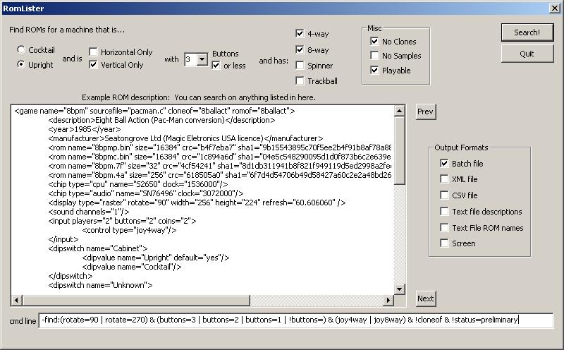

check out my ListGen utility which implements a SQL-based search on the XML information.
I just can't figure this beast out.  I have downloaded the listgen.zip file and put it in a directory \listgen on the same drive as the mame installation.  There are *no* instructions that I can find in the .zip file.  So, at the prompt I type listgen and I get an .XML file with all the games in it along with a couple of errors:

I'm okay with SQL.  I just can't figure out what to do ...

I was wondering about your example of your your cab (with the 4-way & 1 button) - your resultant list would have only games with one button, but no games with zero buttons, correct?  How did you handle this (as I assume that you wanted a list of games that could be played on your cab, not just games that actually used that one button)?  I'm guessing you've already ran into this, as [ms.] pac-man would have gotten filter out...
This leads me to wonder if there is a way to exclude/include a range of button amounts, IOW create a list of games that used 2 or less buttons.  Is it possible to "-find:buttons<=2" to get the output to have all games that have 0, 1, or 2 buttons?
Or is it necessary to run multiple passes first excluding 10 button games "-find:-buttons=10", then on the next pass "-find:-buttons=9", then "-find:-buttons=8", then "-find:-buttons=7", then "-find:-buttons=6", then "-find:-buttons=5", then "-find:-buttons=4", and finally "-find:-buttons=3"?

I did some testing with this and mame 0.110.  Your example instructions to sort cocktail games don't work with the xml format generated with 110.  When I did the steps you listed in the first post, the generated list contained 0 games.  Here's what I discovered with those search terms:
  • "cocktail" - This term is only used in dipswitch settings, so this seems effective to find games for your cocktail.  I'm not sure if there are other games that don't have a dipswitch labeled cocktail - if so they wouldn't make the list.  RL found 1997 matches (of 6283)
  • "vertical" - This term is only used in dipswitch settings on games that allowed you to change the orientation.  Searching for vertical in the resultant cocktail list only found 15 matches (of 1997)
  • "-cloneof" - Works fine.  Reduced list from 15 to 10.
  • "buttons=1" - Seems to work as expected, even though the xml is buttons="1".  Hmmm   List is down to 3.
  • "joy4way" - found 0.
The main problem is the orientation.  Perhaps the xml format changed this info from saying horizontal or vertical to what it is now (plus number of sets that have those attributes):
  • rotate="0" (4370 of 6283) horizontal
  • rotate="90" (890 of 6283) vertical
  • rotate="180" (116 of 6283) horizontal
  • rotate="270" (907 of 6283) vertical
I found that to generate a list of only vertical games, you need to do 2 steps:
  • rl -in:cocktail.xml -out:not180.xml -find:-rotate="180" (1979 of 1997)
  • rl -in:not180.xml -out:vertical.xml -find:-rotate="0" (1192 of 1979)
This results in a list that includes 1192 sets rather than the 15!
Next up is parents only:
  • rl -in:vertical.xml -out:noclones.xml -find:-cloneof (540 of 1192)
Now for buttons.  Using -find:buttons=1 only generates a list that includes sets that have buttons="1" in the input field.  I'm no expert on the mame xml format nor did I check each set (!), but it appears that when a set doesn't have any buttons, there is no buttons="x" tag in the input field.  IOW- it doesn't say buttons="0", rather the buttons="x" doesn't exist.  Going with:
  • rl -in:noclones.xml -out:1button.xml -find:buttons=1 (222 of 540)
This list filters out sets that don't have a button="x" tag - for example, Crush Roller and Frogger are not in the resultant list.  However, Ms. Pac-Man is since it has a tag that (incorrectly?) says buttons="1".  :shrug:
It seems that if you want the games with zero buttons in your list, you have to either add them in manually at the end (which would be time consuming to do), or do a progressive button removal such as:
  • rl -in:noclones.xml -out:lessthan10buttons.xml -find:-buttons=10 (found 0)(540 of 540)
  • rl -in:lessthan10buttons.xml -out:lessthan9buttons.xml -find:-buttons=9 (found 0)(540 of 540)
  • rl -in:lessthan9buttons.xml -out:lessthan8buttons.xml -find:-buttons=8 (found 3)(537 of 540)
  • rl -in:lessthan8buttons.xml -out:lessthan7buttons.xml -find:-buttons=7 (found 0)(537 of 537)
  • rl -in:lessthan7buttons.xml -out:lessthan6buttons.xml -find:-buttons=6 (found 2)(535 of 537)
  • rl -in:lessthan6buttons.xml -out:lessthan5buttons.xml -find:-buttons=5 (found 5)(530 of 535)
  • rl -in:lessthan5buttons.xml -out:lessthan4buttons.xml -find:-buttons=4 (found 12)(518 of 530)
  • rl -in:lessthan4buttons.xml -out:lessthan3buttons.xml -find:-buttons=3 (found 33)(485 of 518)
  • rl -in:lessthan3buttons.xml -out:lessthan2buttons.xml -find:-buttons=2 (found 238)(247 of 485)
  • ***just checking***rl -in:lessthan2buttons.xml -out:lessthan1buttons.xml -find:-buttons=1 (found 222)(22 of 247)
You wouldn't want to use that last one, as it filters down to 0 buttons.  It does show that there are 22 sets that have zero buttons that would not be in the list had you only ran the single "-find:buttons=1".  These 22 would also have to be found and inserted manually if you don't do the progressive filter shown above.
Let's go on to joy4way:
  • rl -in:lessthan2buttons.xml -out:4wayonly.xml -find:joy4way (73 of 247)
73 with 4 way joysticks.  This excludes both up/down and right/left 2 way sets, such as galaga, mappy, space invaders, pooyan, zzyzzyxx.
Well, I've come this far so....  I manually searched through the "lessthan2buttons.xml" to find just what other controls were listed in that file to be excluded.  They were:
  • rl -in:lessthan2buttons.xml -out:no8way.xml -find:-joy8way (found 99)(148 of 247)
  • rl -in:no8way.xml -out:no8wayorpaddle.xml -find:-paddle (found 5)(143 of 148)
  • rl -in:no8wayorpaddle.xml -out:no8wayorpaddleorball.xml -find:-trackball (found 7)(136 of 143)
  • rl -in:no8wayorpaddleorball.xml -out:no8wayorpaddleorballordial.xml -find:-dial (found 3)(133 of 136)
  • rl -in:no8wayorpaddleorballordial.xml -out:2or4ways.xml -find:-doublejoy4way (found 2)(131 of 133)
That finds 58 more parents that don't have a 4 way joystick, but can be used with the 4 way.
This gives a grand total list of 131 parent sets that can be used with a control panel that has a 4 way joystick and 1 button on a vertically orientated cocktail that has dipswitch settings for cocktail mode.
Hope this helps someone!

Got some more time today to work on it, and it's getting crazy pretty quick.
Added () operators, and the ability to do multiple & and |'s on the same command line:
-find:"((orientation=vertical & cocktail) & (joy4way | joy8way) & (buttons=1 | -buttons))"
should pull out all the vertical cocktail games that are 4way or 8way, and have 1 or 0 buttons.  sheesh.  (I realize the orientation=vertical stuff is now obsolete-I really need to get a fresh xml file to start with!)
This should also work:
-find:"((buttons=3 | buttons=2 | buttons=1 | -buttons=) & (joy4way | joy8way) & cocktail)"
Although I'm 2nd guessing myself that the straggling & will work there.  I've run out of development time for the day, but just wanted to give a status update.  I should be able to test this tomorrow, and I'll look at the csv format as well.  I still need to go through the "unplayable" feature as well, as mentioned in the other thread.   Yikes.  Lots of work to do!
I should probably switch the not operator of - to a ! to be consistent with C programming languages. (I'll allow either)
rockin_rick, you are officially my guinea pig for testing this stuff, so get ready!   ;D
-jeff!
NOP
  • Posts: 916
  • Last login:September 19, 2017, 08:22:27 pm
  • I stole my avatar.
    • winterMAME
Re: new rom list generator thingy.
« Reply #18 on: January 04, 2007, 03:53:44 pm »
ok, version 1.2 is finished. (and lightly tested)
http://www.waste.org/~winkles/rl_1p2.zip
New stuff:
-csv  Creates a file containing comma separated values (for importing in spreadsheets and databases) of any criteria you want.
      Specify the criteria in the -find: option.
rl -in:allgames.xml -out:outdata.csv -find:"year,game name=,description,buttons=,control=" -csv
Results in a file like this:
1981,froggers,Frog,-,joy4way
1982,amidars,Amidar (Scramble hardware),2,joy4way
1982,triplep,Triple Punch,1,joy4way
1982,knockout,Knock Out!!,1,joy4way
1981,mariner,Mariner,2,joy8way
The search routine will find any criteria located inside of quotes, such as buttons="3" or inside <> </> such as <year>1984</year>
Any field where no match was found, the program will simply insert a - to keep the separated fields in line when importing into a spreadsheet.  (such as froggers above, there was no "buttons=" statement in the ROM description.)
And as detailed in the previous post, support for multiple search criteria and operators is now fully implemented.  With this new support, my initial search for roms can now be done in nearly 1 command line:
rl -in:allgames.xml -out:jeffsgames.xml -find:"((orientation=vertical & cocktail) & (buttons=1 | !buttons=) & joy4way)"   :)
I don't think having detailed # of items found messages are going to work anymore now that you can do & and | operations all on the same command line.  It would just get ugly quick.
I've not had any inspiration for the runnable tags request yet either.
-jeff!

Here's a prototype GUI that I came up with last night:
1) shows a full rom description in the main window that you can look at, copy-n-paste from, etc.
2) has basic checkboxes and radio buttons to do a very quick search for what you're looking for.
3) has an advanced mode on the bottom where you can type in your own search criteria.
4) the gui will build the command line for you as you click stuff, so you can always edit it.
5) select various output types on the side, and hit the search button.
6) there will be another screen prior to this one where you point it to MAME.EXE.  It'll spawn out and generate the allgames.xml file for you.
At least that's what was in my head.  Hopefully I can get it out of my head in a couple days.
-jeff!

Wow, gui isn't looking bad...
Just opened excel, and it allows: tab, space, comma, semicolon or other, and you can type in whatever you want in the field.  If/when the GUI becomes available, I will have a similar dialog.  If you pick comma, then I'll maybe pop up a warning that the descriptions could cause import errors.
I just checked mine, the delimiter chooser is just like your number of buttons 'chooser'.  It has in the drop down: comma, semicolon, and "\t" (which seems to be TAB).  It also allows  you to highlight and type in what you want.  So if it was like your buttons, you could highlight the "3" and type "7" if you'd like.
Your gui delimiter plan sounds good, but it would still be nice if the command line version did something about the comma problem.  Maybe you could add the delimiter to the -csv switch?
  • -csv:";"  (or similar)
Then the gui could just pass that to the command line.  I'm guessing that's what you are planning?
That's cool.
IMO, I would not use the texts "Find ROMs for a machine that is..." and the "and is" "with" "and has:"  instead I would simply:
Use an outlined box (like you used for misc) for each.
Label the first 'cabinet'.  Add a third option - 'either'.
The second label 'orientation', change to radio buttons, and add an either/both.
The next outlined box label 'buttons'.  Keep the drop down like it is, support up to 10 buttons.  Perhaps put the 'or less' checkbox under the dropdown. (for horizontal compaction)
The forth label 'controls'.  Keep the controls as checkboxes but add all that are possible.  A quick -find:"control type=" -csv and then a column sort in the spreadsheet makes it easy to find out that they are:
'null'
dial
doublejoy2way
doublejoy4way
doublejoy8way
joy2way
joy4way
joy8way
lightgun
paddle
pedal
stick
trackball
vdoublejoy2way
vjoy2way
Fifth label 'misc' (as it is).  Perhaps another checkbox for named "Working" that would add an emulation="preliminary"?  (see previous post)  Perhaps we should verify that is the tag that determines working or not....
Change the Playable label to Runnable (expecting that there is also a 'working' checkbox)?
Perhaps a sixth box labeled 'savestate' with a set of 3 choices via radio buttons: "supported", "unsupported" "either"
Maybe a seventh labeled 'display' with a set of 3 radio buttons: "raster", "vector", "either"
Maybe an eighth labeled 'coins' with a setup like the buttons (drop down, or less checkbox)  FYI - checking the allgames.xml, there are 1,2,3,4,5,6,8,null choices.  I'm not sure how important this is in the end, as I don't know what mame means/does with this value.
A must.
Nice.
Cool.
Perhaps you could skip this and instead, when search is clicked check to see if allgames.xml is found, if not then open a dialog that does what this initial screen does.  That way, the 'generate allgames.xml' screen is not seen every time the program starts once you've done it once.
What will the Prev and Next buttons do?  Next game for display in the example box?  If so, perhaps a game name entry box could be added to find the one you want to see.
What does No Samples equate to (what command line text is generated)?  Games that do not require/use samples?  So then an empty check box = all games, and a check is games that don't require/use samples (-find:!samples)?
I checked out a few sample searches:
-find:samples = 370
-find:sample = 371
-find:"sample name" = 237
Why do records have:
      <chip type="audio" name="Samples"/>
but no sample names listed?  Are these games that require samples, but none yet are available?
I think that the one extra found with "sample" is rom=jumpshtp  It's description is "Jump Shot Engineering Sample".  Make sure to search for samples, not just sample.
I'm assuming that you are going to have in/out file buttons that open dialogs to select and/or enter filenames, huh?
Gotta run,
Rick

Rick, on the GUI version, I'd decided that I wanted a super simple interface that was easy to use for beginners, so I think the text between the checkboxes acts as a sort of "wizard" to help people comprehend what the tool does.  With that in mind, I didn't want too many checkboxes or combinations that would end up being overwhelming for first time users.  Of course, eventually we all would like to have all 16 different controller types and all the various monitor orientation filters, so perhaps an "advanced mode" checkbox is in order.  The more checkboxes the more potential bugs, so release 1.0 of the GUI will probably be as stripped down as what you see, or perhaps even more stripped down, but we'll grow it from there.   :)
As for browsing for MAME/generate the XML file, I currently have it so that you can browse for MAME or if you've already generated the xml file, you can browse for that instead.  The main reason that I need to do that (for now anyway) is that the program will need to know where the file is located on the hard drive.  Later revisions can save paths into the registry, but for now you'll have to browse every time to get it started.  (the standard file browser somehow figures out where the previous path was, so it's not that much of a headache.)
headkaze: thanks for the code offer!  (and I didn't know anyone else was reading this thread!)
I'm currently just using:
                        CString arg;
         arg = m_fileName+" -listxml >allgames.xml";
         system (arg);
Which seems to do just fine.  You do get the DOS black screen popping up, but I'm ok with that at the moment.
Yes, the next/prev buttons will jump to the next <game></game> in the xml file.  I like the idea of having a search box there.  I think I'm also going to have a "hide roms" so you don't end up seeing so much of the ROM names/CRC/SHA1's that clutter up the game description.  (probably not in release 1)
So the next question is, should I continue working on the GUI, or do I do another release of the cmd line app to fix up the delimiter in the CSV file output?  Rick, I have a feeling you're the only one using it at the moment, so if you don't mind waiting for the GUI, that might be the best use of my time.
-jeff!
