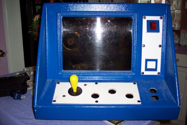

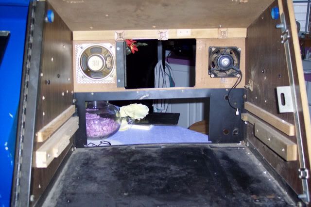

  • I want to build my own MAME / Hyperspin cab
 on monitor, and  how to do the  wiring ..
 I want to rebuild this counterTop, to a MAME  and what kind of monitor should i put in there . I
 believe a 13" fits in there .  and how do i do the wiring??/
   Can you guys and gals tell me what would u do ? and where can i read up on building a small mame .
http://i21.photobucket.com/albums/b267/janey6152/100_1662.jpg
http://i21.photobucket.com/albums/b267/janey6152/100_1652.jpg

If I had that cab, I'd buy a 13" LCD screen for the front and a mobo for the back. Hack a Sidewinder for the controls. Wiring would be a breeze.

Sidewinder is a control pad by Microsoft. It has nice solderable holes on the PCB and is USB ready, so it'll be a cinch to hack. The flat screen monitor can plug right in to a VGA card.
You won't have to fool around with JPACs or Arcade VGA cards this way. Just a little drilling, and wham, you have a killer bartop game.
Good luck, and let us know how it goes!
