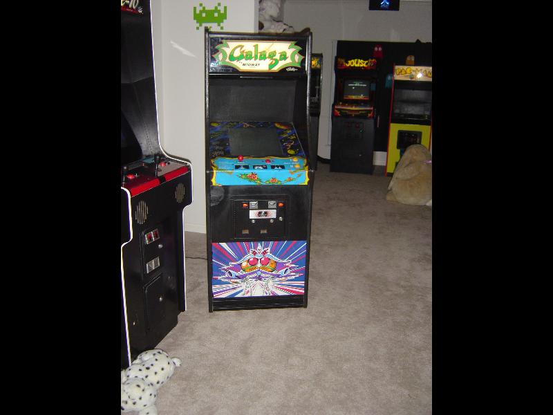

The Galaga had a bad PS board, transformer was fine. I pulled them both and went with a switcher. Now I have two working Galagas.

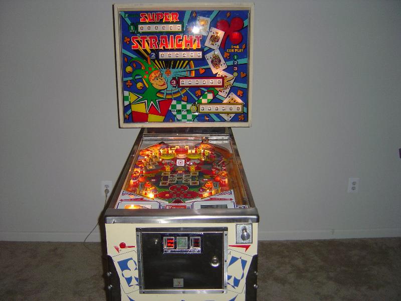

Unbelievable, nothing like this has happened to me. But here they are. The Super Straight would power up but no action. I repaired the start button and dangeling flipper solenoid and once you inserted a credit then hit start the game would still not feed a ball. I fixed the ball sensor switch and now when you hit start it feeds a ball and plays great. However, when the ball returns  to the outhole the next ball does not get fed to the plunger. If you press start the ball still does not feed. I tried it with one, two and three balls in the machine.
Here is the Super Straight:
Here is the Galaga, It was so nice I slid it into the place of my other Galaga, put on the new side art, and that is that:

Fixed the pin, some tard had put a ball sensor switch in with the wire frame actuator half way between the leafs. It could not have slipped. Game works 100% now!
