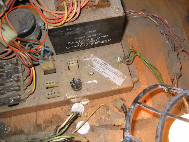

Here's the view of the power supply :
WHat can I check on it ?
Do you think it's the first thing to check ?
Thanks for your advices.

Don't worry about posting in the wrong section, I just wanted you to get more exposure from people more knowledgeable on repairs.
Usually on Atari's the power supply is the first thing to check.  I think I see the big capacitor on the other side of that transformer.  You should also check to see what kind of voltages you are getting out of the power supply.

Is it the BIG capacitor you're talking about on this picture ? the BIG red one ? :

The big blue cap is the one just to the left of the main power transformer in that picture.  It's bolted into the power chassis, and has leads screwed into the terminals on the underside.

I don't know WHAT that red thing is.

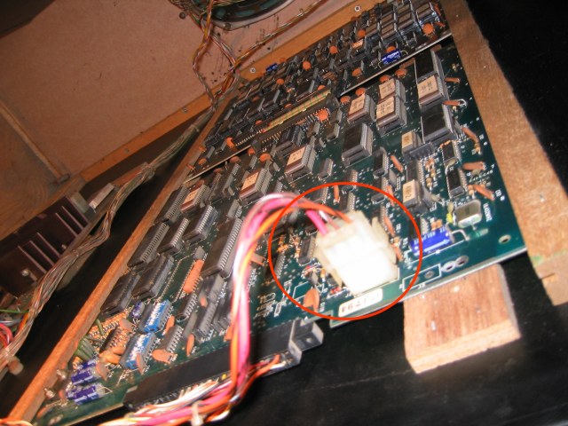

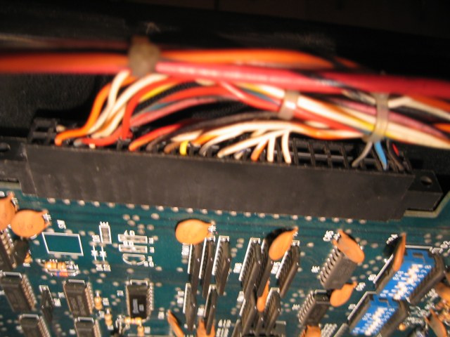

Re: Xevious ...PCB problem :-(
« Reply #14 on: November 11, 2005, 06:23:50 pm »

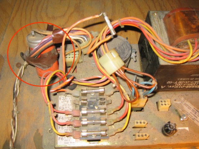

OK, I need to know what exaclty is the 'Atari Big Cap'  ???
So, here's pictures :
or
The Big cap is on picture 1 or 2 ? How can I check it ?
Thanks for helping a 'newbie' in electronic  :-[
« Reply #15 on: November 11, 2005, 06:25:30 pm »
Picture 1. The black one. Originally they were blue. Looks like yours may have been replaced at some time.
That red thing also looks like a cap. I have no idea why it's there and "loose" like that. Looks like that thing and the fuse are NOT original. They were hacked in. Which I could figure out why.
NO MORE!!
« Reply #16 on: November 11, 2005, 07:30:21 pm »
Like Rayb said the black one.  I still wonder since your overseas if Atari Ireland actually used the blue ones, but that doesn't matter just curious.
No clue why that red one is there and why it is hanging, I wouldn't think that that is a good thing.  You should probably put the fuse back in the holder.
Also, the Atari Regulator board, ARII?, is inside of that enclosure just so you know in case you have to get in there to replace anything.  (Is that correct?, RayB)

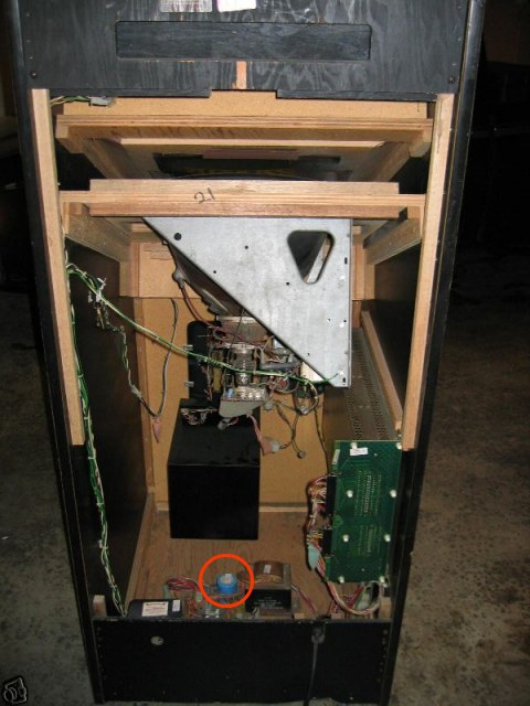

Ok, I've found a picture of a Xevious cab with the famous 'BigBlueCap' :
What is the purpose of that component ? Is it common to found it in the shops nowadays ?
Something I don't understand : How is it possible the monitor works if the power supply has a failure ? Can I use a common 5V alimentation from another arcade game to test the pcb ?
Thanks for help  :-\
Monitors typically run on 110v, which is what comes out your wall socket. The power supply would have a fuse on that line but other than that, power is probably direct to your monitor. It's the OTHER PARTS of the power supply that do other conversions and output lower voltages to the AR-II board (for further conversion). I don't know if it is standard, but in my Missile Command, it outputs 36v to the AR-II. Then the AR-II converts to DC and outputs 5v and 12v to the game board.
The Big Blue *I think* is suppsed to keep the voltage "clean" and steady. If it gets so old and doesn't function right, then the voltages will vary, be too low or be too high or spike. Basically, wrecking the AR-II board. (but the point is, your monitor voltage isn't affected by this cap).

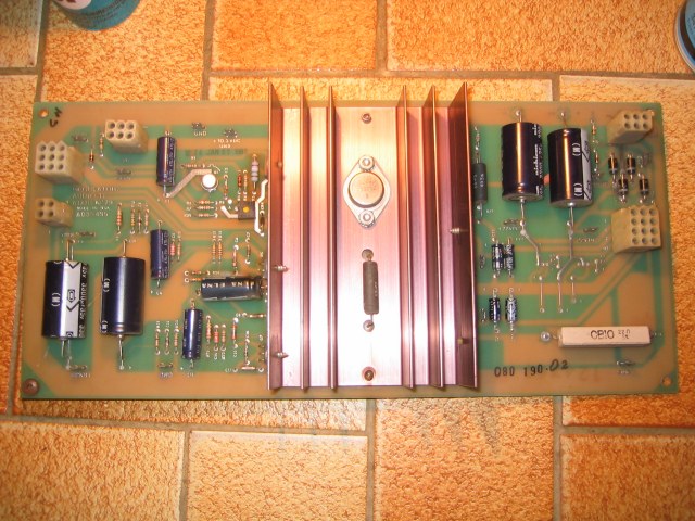

« Reply #20 on: November 14, 2005, 03:17:10 pm »
Thanks for the explication RayB.
So the purpose of the AR2 board is not only sound ? but it also make a output conversion.

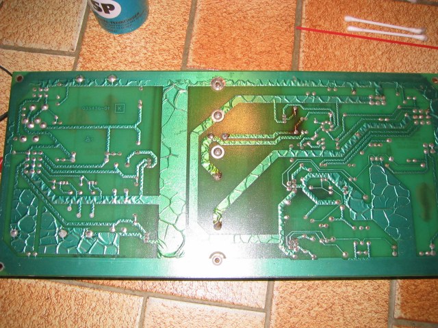

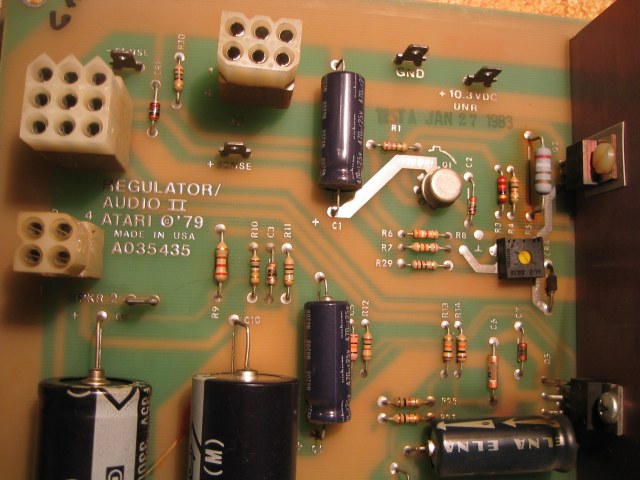

Here's pictures of the AR2 :
Closer ...
On the back of the board, I notice this :
What is the url of Bob Roberts website ?
Oh, for information my Xevious is an EURO version. And I'm still not able to identity the PCB... this is not written Namco or Atari, except on the AR2 boad...
« Reply #21 on: November 14, 2005, 03:47:17 pm »
OK I am not familiar with Euro boards, so take what I say with caution...
Your AR-II looks really clean. Almost as if it has already been rebuilt. Once again, your capacitors look like modern ones instead of the blue style I usually see on those. Could be because it's a built in Ireland one or could be that whoever you bought it from has already rebuilt it and it still didn't fix the problem so they gave up and sold it to you!
NO MORE!!

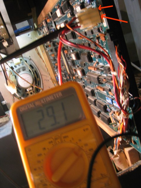

OK, before take mesure, I need to know which Xevious PCB I have  ???
There's nothing written on the PCB  :o
Can you help me to identify it ?
Here's the CPU pcb :
and the VIDEO pcb :
...there's no ATARI or NAMCO indication  :o ???

but according my harness :
...it doesn't seems to fit the documentation... So I presume it's a Namco pcb... and I'm not able to find pinout description for the Namco pcb  :-[
OK, so I decide to check what I can... and I try to found the +5V
The power come in wires from AR2 in two places :
- On this connector :
- and on the main harness.
A strange thing... When I remove this cable...
... and I power on the game, there is a bad smell and some smoke seems to come from the AR2  ??? >:(
What do you suggest ?
I would like to know which PCB version I have, in order to get the right pin out, and check at least the voltage  ???

Wow. OK, it could be a bootleg...???

A bootleg board wouldn't bother with a ar2 or use the original custom namco chips.
I looks to be similar to a galaga boardset pinout wise.

Btw, smoke from the ar2 is BAD!!

Ok, so like to suggest me, a get some mesure on the pcb.
First on this connector :
3P Plug
# +12VDC          -> 29.1 on my digital Multimeter :o
# GND
# +5VDC            -> 10.3 on my digital Multimeter :o
How can I get so HUGE value ???
See on pictures :
When I got these values, everything was plug ON and powered.
I'm not sure my Xevious PCB has the same pinout than the Galaga...
Here's some value I got on the PCB :
no value   A  1     no value
14.5         B   2    13
1.4           C   3    30.1
1.4           D   4    1.4
no cable   E   5    no cable
11            F    6    10.8
no value  H    7    no value
10.8         J    8    10.5
10.8         K   9    10.5
10.8         L  10   10.5
10.8         M 11   no cable
10.8         N 12   no cable
10.8         P 13   no cable
10.8         R 14   no cable
10.8         S 15   no cable
no cable   T 16   no cable
no cable   U 17   no cable
no cable   V 18   no cable
10.8        W 19   no cable
no value   X 20   no cable
no value   Y 21   no value
no value   Z 22   no value
Can I use an other power supply for output correct +5V and +12V ?
What do you suggest me at this time ?  ???
Thanks a lot

« Reply #30 on: November 16, 2005, 06:13:13 pm »
WOW. What I want to know is why your board is still working and not just frying up.
Actually, you CAN use another power supply. You will probably also need an amplifier for your sound output.
But on the other hand... Why not keep it original? Do you have a power supply lying around? A rebuild kit and big blue cost about the same or less than a new power supply.
« Last Edit: November 17, 2005, 08:09:59 pm by RayB »
