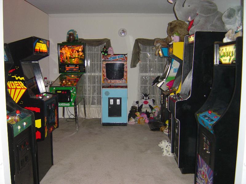

Made 5 good scores, Teed Off pinball, Joust, Mappy, Bubble Bobble, and Donkey Kong. They are in the arcade after a very long day today.
Better pics of each here: http://www.subarubrat.com/arcadeandauction.htm
