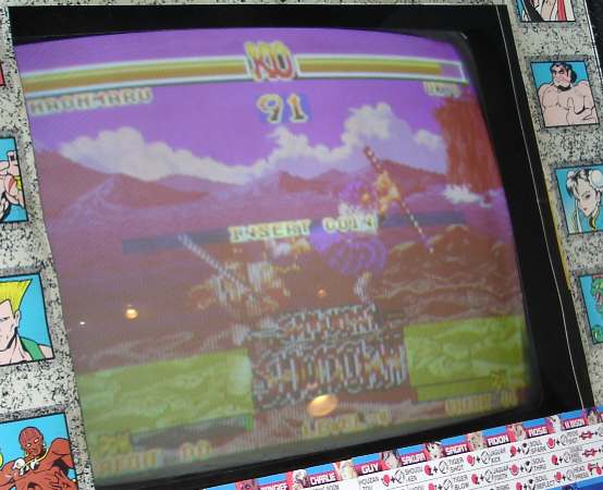

I just purchased a Neo-Geo 1 slot board and a Samurai Shodown (from different people on eBay), and when I plug them into my SF3 Alpha cab, all of the screens are filled with red lines, and there are red boxes around all of the text. I have 2 other cartridges, but they were sold as-is, and I get only a grid when they are plugged in (no red lines, but the neo-geo splash screen looks normal as well).
My question here is, would this type of issue generally be a cartridge that is bad, or the mainboard? Also, is there anyone near downtown Dallas that might loan me a known good cart to test? Maybe the monitor needs adjustment? If the cartidge was bad, that would suck, but I got it cheap. If it's the mainboard, I'll need to get upset with someone...
Note the blue area next to Insert Coin and the green blocks on either side of the title. They look red in real life. I'm having trouble getting a good picture.
Thanks

My brother has a neo geo one slot and he gets weird graphics when the cart isn't in all the way.  Try reseating the cart.
I'll ask him if it's the same as what you're seeing.
NEO MVS carts are also very prone to oxydation of the contacts. Take the cart out with power off of course. Take an eraser from a pencil and go over the contacts of the CART with the eraser. Blow out the contacts with air before inserting in the NEO board. This will resolve this sort of problem 9 times out of 10 with the 10th time being a bad cart or imporperly seated.

Goz is right on the money. That looks & sounds like dirty contacts to me. I have several carts that gave me similar problems before I cleaned them.

It's also worth nothing that MVS carts tend to act up if they're inserted all the way into the slot.  I find that the best results happen by pushing the cart all the way in, then backing it out very slightly.  Every sound or image problem I've ever encountered with MVS was solved this way (and a good cleaning helps, too!)

Yes. I cleaned the contacts with an eraser, then cleaned again with alcohol. I re-inserted the cartidge, and pulled it out slightly. Everything is perfect now. Thanks!  ;D
