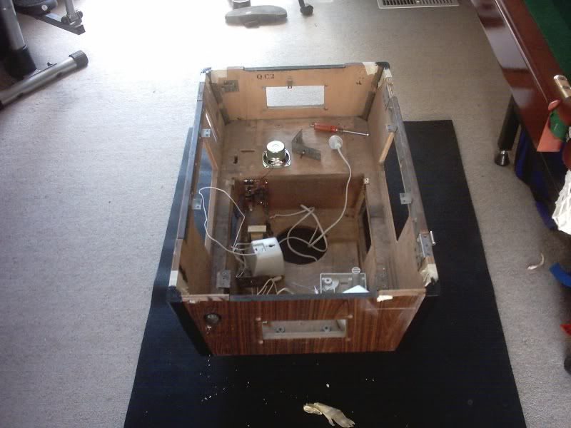

Ok
I havent been to this site for ages I've been working on my carputer and a few other projects lately :)
Now that i've installed the LCD and setup the software for the carpc i will save for a few other things to do to that project.
So i dragged the aussie cocktail (yes i know there really japanese cocktail cabs) out fromn under the house from 2 years ago and i thought i'd try to get the body done this weekend.
http://www.ninja.doomportables.org/arcade/cocktail.jpg
http://www.ninja.doomportables.org/arcade/cocktail2.jpg
http://www.ninja.doomportables.org/arcade/cocktail3.jpg

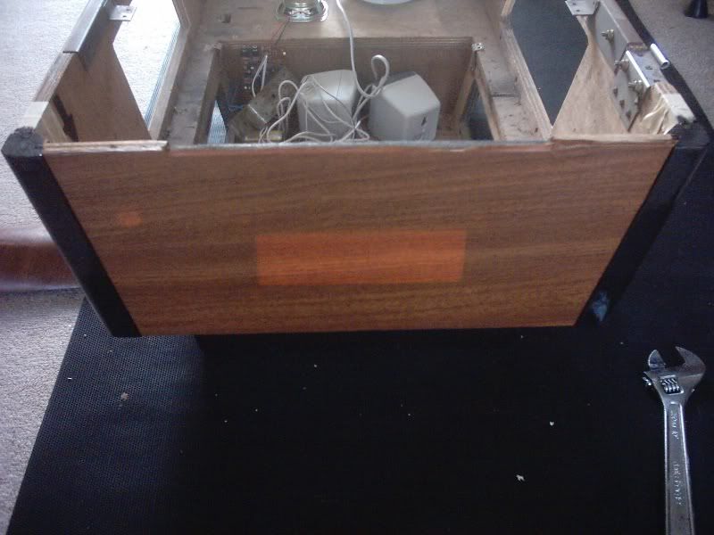

As you can see from these pics the veneer isn't that good and it's real hard to put some new veneer onto the cabinet.
So what i'm asking of you guys ;) is some advice
What should I do?
Get new veneer?
Paint it all black (i don't like this idea it makes it bland)
Paint it diff colours (please give me some examples)
Id really like some idea's on what kind of colours you guys think would look good thats if you don't think i should veneer.
I like the veneer but it's really gonna be hard to apply it with the way it's sitting on the wood.
So what do you guys think :)

Finding cocktails in Australia is bloody hard.  Though this is not an original Lesiure and Allied Industries (LAI)  cocktail, I do recall seeing some of these around as a kid and teenager.
Keep the veneer if at all possible, it gives it the real retro effect and keeps it more original.
Use Marveer, it is a polish and wood toner.  The veneer on my cab was scratched and it did a good job in covering/blending them.
Should be available in supermarkets.

It looks pretty beat.
Why not keep the legs, then rebuild the top.
Make new panels to the same dimentions as the original, just use them as templates.
Just an opinion...

This is a original Lesiure and Allied Industries cocktail.
If i remember correctly neer the end they started to use a different designed cocktail for whatever reason so It's orignal but not the orignal orignal u know from your childhood ;)
I'll get some pics of the Metal plate :)
As for painting it black NOWAY it just looses it's charm
And i can't get rid of the scratches cause the veneer has been chipped aswell so it have to be brand new veneer.
I don't wanna remake the top frame again it's just a waste of work it never get finished then.
I was thinking of using filler to fill the chips then applying new iron-on veneer then adding a gloss ontop of it to make it look more wooden like how it is now but im not sure if that would work.
I know the iron-on stuff looks fake-ish but if gloss is added i dont think you will know it's the iron-on veneer.
I'm not sure what to do  ???
But i better make up my mind before the weekend  ;)

You'll have to decide if the original veneer is worth restoring. If it's gunna look crap I wouldn't bother.
The top of the table is what usually tops off these tables. So people may not notice small blemishes if you restore the veneer.
You could get the fake woodgrain stuff from junked TVs like Corey Feldman did with his table. Looks really good.

I'm not to fussed bout money i would like to get the wood-grained laminex (which is has on right now) but it's very hard to get it off and id end up wrecking the cabinet trying to rip it off.
And applying it over the orignal will throw it out
It would sit over the edge which would look funny.
I think i'll see how thin i can get the laminex and if it's thin enough i'll get it :)
Otherwise it's that woodgrain contact paper going on the cabinet with lots of glodd  8)

Well i grabbed some Contact paper with woodgrain pattern on it and it looks like it would look fine on the cabinet.
Should go over the orignal veneer well :)
Only problem i have really is the contact paper will basiclly start to peel off
So i'm guessing i should put some PVC glue on the old veneer then apply the paper onto to keep it extra strong hold.
That should keep it there right?

hmm, pvc glue plus the adhesive on the contact may cause an issue. Why not test it out first.
I'd just sand the old veneer an make a good clean surface for the contact to join to.

I'll get some filler and fix the spaces between the chips of the veneer then apply the contact paper after i sand it all :)
I'll then see if i can find somthing to seat the edges of the contact paper and the wood :)
I hope all goes well  ;D

what could work really well is to use contact adhesive. you would only need to apply it to the cabs surfaces as the vinyl already has a contact adhesive on it. that should stick like stuff to a blanket!! as always, try it on something else first!

« Reply #23 on: February 11, 2006, 10:46:06 pm »
Well im back AGAIN!!!!!!!!
I havent had any time off since march last year :(
I have holidays (1 week left) and im ment to be working on a clients website but i need a break so i found the cocktail cab from under the house and have started to work on it again :)
Here are some recent pics not much has been done i got the 4 cornrs painted (needs another coat) and i have started to apply the woodgrain :)
The orignal was chipped and scratched deeply but now it looks nice :) only difference is the wood pattern is going lenghtways and not up n down like it orignally was which is cool  :laugh:
I love the new smiles aswell nice job  ;)
Ok on with the pics i better get back to applying the woodgrain.
Old wood grain with scratches and chipped bits filled
http://i7.photobucket.com/albums/y279/aussie_ninja/old-wood.jpg
New woodgrain need to cut the holes and a clearcot will go ontop to make it look nice and durable :)
http://i7.photobucket.com/albums/y279/aussie_ninja/new-wood.jpg
