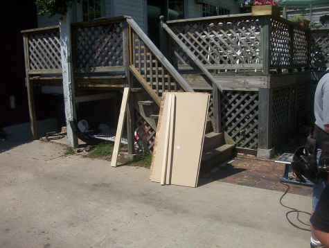

Welp just got back from the local hardware shop and got all my wood and other materials. So Tomorrow I should have atleast the Cabinet built and ready for paint. I have decided since it will be for my daughter I am going to do a Little Mermaid theme. I figure if I take my time and do a Mureal Style it will help bypass the time that it takes Ultimarc to send me all my controls and supplies. (What is usual ship time for them anyway?)
But anyway here is some pictures of some wood and supplies just to show ya I am in it for the long haul ;).
Keep in mind I only have until August 13th to hopefully get this thing done :).

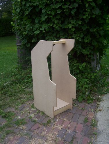

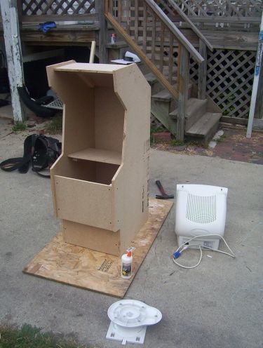

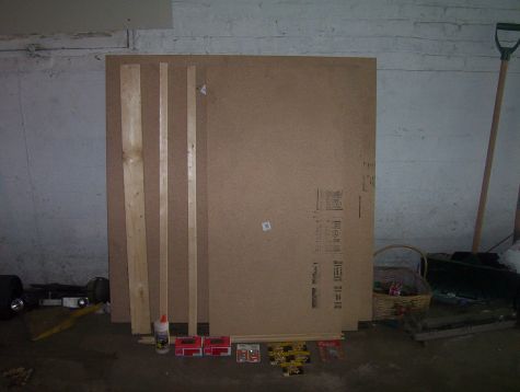

Welp Got to work today and wow I must say this was a sheer blast. Only had one little oops on the base but that got ironed out real quick. So I will shut up and get to the Visual splendor ;). Atleast for me that is I am the bald one. The other is my Carpenter Neighbor who came in oh so handy :). Welp on to picture posting so I can get to puddying and primering. Enjoy
Here is the supplies sitting pretty waiting to be defiled.
Here you can see we have the inside panels cut out and the oops'ed base.
Hey look its me after we measured and cut out the side panels.
Here is our assembled sides, base, and top connector.

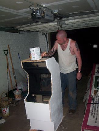

Well got the Puddy (stinking stuff I hate it.....) done and the primer. Also I was to antsy so I spray painted the inside too. :) So here are two more pics of where the Baby Cade has led me to this fine and wonderful day.
Here is Me priming the Baby Cade!
And last but not least the Primed and spray painted Baby Cade!

OK! Today you should get pictures Scrounged up some cash and bought batteries ;). But here is what I got done yesterday.
1. Routed the Cab all in all went pretty well for never routing before :). Had the bit slip down on me so I had to shave a 1/8 inch off the top. "Oops" The funky molding I got can't make the tight corners so I have to jigsaw the sharp corners and round them out so that the Molding can bend easier. Then I will route what I jigsawed and put up the molding. Should look nice :).
2. Setup Mamewahs sounds and put some nice menu music for my daughter. Also recorded my own voice for start up and stuff like that. When it boots up it now says "Daddy loves you"
3. WIRED THE CONTROL PANEL............................... That was probably the most fun and infuriating thing I have done :). But worked first time out so I am one happy camper. Ipac2 rocks the peruvial caspa!
