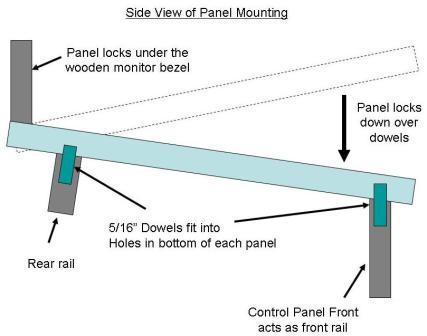

I have one question about the dowels.  Did you drill the holes in the panels at an angle?
I'm referring to this image http://www.beersmith.com/mame/panel_mount.JPG
The rear rail is set at an angle as shown, so there was no need to drill the holes at an angle.
One of the issues with my existing cabinet was the fact that the pinball flipper buttons were already drilled and installed, leaving no room for  another rail.  I had to use the front CP edge as the front rail.  The dowels are set vertically into the front edge, but the holes in each panel had to be drilled at an angle.  In this case, my CP is tilted about 12 degrees, so I just tilted the drill press clamp 12 degrees while drilling the front holes.
  If I had more space, I would probably install a separate front rail tilted just like the one in the back.  It would go right behind the CP edge.  That would allow you to drill all of the holes vertically.
