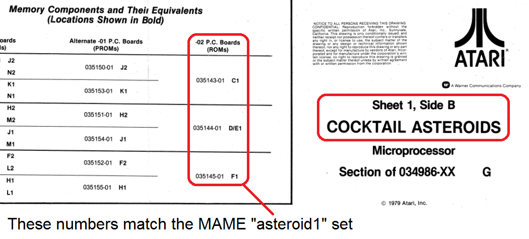

Problem, I don't have sockets for H2 and J2....hmmm, I'm not exactly sure which ones to replace besides 035143-02. But even that one seems to be in the wrong spot...
You have a 034986-02 PCB so the locations are a bit different than originally anticipated.
If you look at your Sheet 1, Side B schematic, you'll find this section that shows that there are a different number of chips and different locations on the -01 and -02 boards.
- Looks like the PROMs at J2+K1 combine into the 035143 ROM located at C1 on your board.
- Looks like the PROMs at H2+J1 combine into the 035144 ROM located at DE1 on your board.
- Looks like the PROMs at F2+H1 combine into the 035145 ROM located at F1 on your board.

So, if I'm following correctly, which I think I am. I only need to burn / replace these two chips.
Pretty sure you're right.   :cheers:
