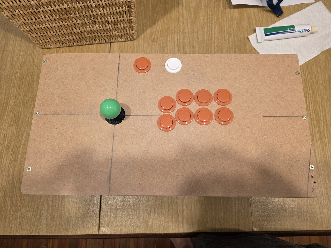

Hello, won a Capcom vs SNK cab off a auction sight unseen. While it did turn on and work it's in rough shape. After evaluating the cab and seeing it doesn't have a CRT (has the cheapest 16:9 monitor I've ever seen in it) and how the wiring has been spliced and cut a whole bunch I've decided to pull everything out and just rebuild it with a emulation PC in it with a 35 inch Arcooda monitor in it. I'm mostly a console type of guy so I don't know anything about arcade sticks and buttons. My first question is what buttons and sticks do I put in it? It can with IL button that take a microswitch in the bottom and oddly I had a ton of that style switch from modding lightgun triggers, not sure if that's the way to go. I've heard of the name brand Sanwa before, not sure if that's the move? For the stick I have no clue, I know you have different gates and I see so many styles. Can anyone shed some light on this for me? The buttons are 30mm and the stick hole is 45mm. Is the Ultimarc I-PAC the way to go to get this to interface with a computer once I'm done? If not what do I use?
Here is the current control deck. Thinking of just doing a fresh vinyl wrap on the metal deck, shouldn't be hard. I do want to replace the plexiglass, I see sources online for the 1/8th thick sheets online. Any tips for cutting it and drilling the holes? I haven't worked with plexiglass in 20 years and then I just made a custom cluster for my old Mustang.
Thanks for reading, sorry if these questions are super basic.

The first thing you are going to want to do... is to replace, or re-drill the control panel.
Angled sticks are a Horrible user experience,  and never should have been installed like that
The reason is... you are always looking at the screen, not the stick.. and so you will automatically be thinking
that  "UP"  is towards the monitor.  But since your stick is angled.. Up will be diagonal... so you will end up
making the wrong move.
Its different from holding a gamepad in your hand, and sitting at an odd angle... because the gamepad's UP,
is always locked in place.  Its always UP in the controllers orientation.. in your hands.
With a control panel, you cant really Feel which way is Up.  Especially since a Joystick doesnt have that
gamepad Cross shape, for even a Tactile feel.
 As for Sticks and Buttons...
 Ive personally always preferred the Happs Competitions, for Fighting games.. and an overall decent stick for everything.
 If you Only played older classic games like Robotron, Mr Do, Dig Dug.. etc..  then you would want Wico Leaf-Switch sticks.
 These are not good for Fighting games, however.
 For buttons...
 In Most cases... I prefer the standard Happs Concave buttons.  The concave shape automatically cradles your fingers into the center of
the buttons... making them more comfortable, and easy to tell which button your fingers are on.
 However... I would choose at least one button to be a Pinball Leafswitch button, for playing certain classic games.  Leafswitch buttons
are perfect for games where you need really fast fire rates, and or where you have to repeatedly press them, through the entire game.
They are faster than Microswitches, and are FAR less fatiguing... If you know how to use them in the correct way.
 To use a long-travel leafswitch button properly... you must realize that you dont need to press them all the way to the bottom.  Instead,
you want to do something called  "FEATHERING".   You push the button down to the center.. where the leafs will make contact, and fire...
And then.. you lightly "Vibrate" your finger.
 The two leafs can make and break contact, within the thickness of a piece of paper... so it barely takes any distance or effort, to easily
cause the button to fire rapidly, and repeatedly.
 The length of the long travel leaf buttons.. help prevent you from accidentally pushing them, when your fingers are just resting on them.
This is a problem with certain MODERN made leafswitch button offerings... where even light finger pressure will accidentally trigger them.
 With microswitch buttons... games like Galaga can be very fatiguing, after only 5 minutes worth of play.   Meanwhile, with a leaf button,
you could play that game for hours, without any fatigue.   This is because standard microswitches have a pretty strong spring resistance
that has to be over-came, each time its pressed.   Over the years, new microswitch offerings have came out, that require less and less
spring resistance.. making them easier to press, and thus less fatiguing.  However, even the lightest pressure Micros, are not as easy
and non-fatiguing as using a long travel leafswitch.
 Microswitch buttons are also very loud and "Clicky".  This is most notable, when your game volume isnt that loud, and you are not in
a loud arcade environment.  But in a quiet room.. it can get annoying, especially at night when others in the house, might be trying to sleep.
 As for Leaf Sticks vs Microswitch Sticks... you get a more quieter experience, AND... since the centering is done by a rubber grommet,
your stick does not tend to slam to the edges hard.. like with a microswitch stick.   The rubber helps to absorb impacts based vibrations,
leading to less hand fatigue.  HOWEVER... just like the Leaf-Buttons.. you often dont want to push the sticks all the way to the edges.
The leaf contacts will often register long before your stick hits the outer edges of the stick.  If you push all the way to the edges... it will
feel very fatiguing... as the further away from the center your stick is... the greater the resistance levels.
 So, IMO..  I would recommend two rows of 3 Happs concave micro-switch buttons.  And at least one Leafswitch button, placed slightly
diagonally under them... similar to the layout of Mortal Kombat 3's  "Run"  button.   In that way, you can use it for Rapidfire games,
shmups, and classic games... as well as the run button for MK3.
 For the stick, Id use the Happs Competitions... in line with the buttons.  HOWEVER... Id ALSO place a leaf-switch stick diagonally
up above the Happs sticks.  In that way, your hand can reach either stick... and you can choose whichever you want to use, depending
on the games you choose to play.   You could even potentially use a wico command stick, that has a trigger button on top, so you can
play games like Tron, Mad Planets, and other Dual Control games that also feature a Spinner.
 Id also add a Spinner or Two to the Control Panel... for Spinner games like Tempest, Arkanoid, Star Trek, Tron, Mad Planets,
Supersprint, and many other Driving / Racing games.

 Note - Do not stack the sticks directly on top of each other, or your wrist/arm will hit the bottom stick, when using it
By adding a slight diagonal mount, your arm wont hit the other stick.
 Also... Do NOT curve your button rows !!   This is a very common mistake that so many people make.  My former self
included... which caused me to have to redo my entire Control Panel as a result.   While curved buttons look nice visually,
and save you almost an inch in space... It causes you to lose track of where they are, when you are playing.
 Your keyboards keys, are in a straight line for a good reason.  Your fingers sit directly above them.. and you know exactly
where they are located, because they are in a straight line.  If the keys were on a curve, and you were not looking at the
keyboard when you tried to type on them... you would accidentally hit the edges of the buttons, or potentially hit the
wrong buttons.
 I think a lot of people also try to make buttons aligned by tracing their fingers, while their hands are flat on a surface.
The problem with this.. is that when you play.. you dont have your hand flat.  You bend your fingers at the first
knuckle, downwards, to give you better leverage / strength, and control.
 Trying to push a button down with your fingers being flat.. would be very fatiguing, and give you far less strength,
and control.  Again.. think about how you actually Type on your Keyboard.  Your hands are not flat, when you type.
 The other thing about Curves.. is that every hand is different in size, shape, and finger lengths.  Where as if you use
a straight layout, it fits everyones hands / fingers.
 If you intend to add a trackball..  do not simply place it perfectly in the center.   Make sure that the nearest joystick is
about 10 or more inches away from the center of the ball... else you are likely going to smash your hands into it, when
rolling it hard and fast.  Buttons are very low.. so you generally dont have worry about them... as long as they are at
least like 5 inches away from the balls center.
 Do not expect to use a Trackball for Spinner games.  While you can technically do it... since your ball will often move
at an odd upwards or downwards vector.. your control of the speed of your character will be "Off".  It will never be as
precise as needed, to play spinner games "Good".
 If you do add spinners..  Id also recommend adding pull out racing pedals, for each player, under the cabinet.
That way you can play 2 player Supersprint, Championship Sprint, and other Racing games like Sega's Turbo,
TX-1, Pole Position, and many others.
And finally...
 To add Tactile Feedback..  rather than using a Subwoofer..  buy a set of  "Bass Shaker"  Transducers.  I recommend
the ones they sell at Parts Express.  Use the ones that are at least 4" in diameter  (as the smallest ones are not
reliable).   These things are like subwoofers, but without the cone to move air.  They merely make extremely
powerful vibrations.   This is AMAZING for games.  You will feel every Hit, Thump, and other vibrational effects.
This is very different from a vibration motor... and much more Powerfully Tactile, than a typical Subwoofer.
 Mount these to the under side of the CP, or maybe on the rear side of the panel, that is nearest each player.
The vibrations will travel pretty far.. but you should do some various positional mounting tests, to see how
well the effects are felt.. before choosing a permanent mount.

Thanks for the clear information. Your point about the angled stick really makes sense. I booted it up and played a little SNK vs Capcom before I tore it all apart and it felt awkward. I figured I just needed more time on a stick vs D Pad to get my combos down. My friends group and kids play on D pads, Sega Saturn controller with adapters for most cases. But now you mention it the angle of it wasn't helping. If I'm going to redrill the entire deck I'd like to figure out how to also make a 4 button Neogeo pattern work. Should I just do two rows of 4? or can I do a top row of 4 and a bottom row of 3? That sounds silly now that I mention it. Do you know of any templets I can download and print out to make this easy on me? Have to poke around for a decent price on the sheet metal for the deck, I'm assuming I can use wood but if I was going to still do plexiglass on top it would have to be pretty thin and require bracing. Though As I look at it I got plenty of wood on the mounting lip if I wanted to router down so I have the depth for a thicker plywood. Will have to think about that one. I was planning on putting a 5 inch spacer between the pedestal and the control deck anyways since we are kinda tall people and at stock height even my wife has to hunch over to play. My wife is dying to get classic games like Pacman and frogger up and running haha. I wouldn't mind a track ball, mostly for Golden Tee but in my head i'm kinda thinking i'd eventually build multiple control panels and just have them quick connecters for the wiring.
Good tips on the sound setup as well. I really like high quality sound with all my setups and was already looking at speakers to mount that would fit where the factory ones are.

Most every Arcade game that exists... uses a wood control panel, topped with Plexiglass.
- Happ Buttons are adjustable in depth, and can be mounted to Wood or Metal panels
- Happs Joysticks are designed to sit under a wood control panel
 (Which tends to be particle board, maybe 3/4" thickness... I cant recall exactly)
 (However, if you want to raise them higher, you can partially route the wood, or use a Metal Mounting Bezel)
- Most Japanese Controllers, might be designed for metal control panels.. as they started using a generic plastic cabinet design
  *That said, I think many people route wood thinner, or use metal mounting bezels, or mount them on top.. under the plexiglass
   (only problem with mounting under plexi/artwork.. is if you ever need to service them, it will be a bit more work)
 Ive came up with a Mockup idea... based on your specs, and other games Id highly recommend playing...
- The top blue buttons, would be for Neo Geo. The straight line is better than the original method
- The Green sticks are Happs Competition sticks
- The Left Red stick, is a Trigger Stick.  This could be a Tron Handle stick, or a Balltop/Bat with top button
- The Right Red stick, is a Dedicated 4-Way.. for playing Pacman, and other 4way games
- The Purple Button, is the Pinball Leafswitch button
- The Gray Button, is for Defender (reverse button)
- The Orange things are Spinners.  You an could use Up/Down spinner on the left side, for Discs of Tron.. as well as to use an another button (such as Defender Reverse, MK3 Run, etc)
 This will allow you to play Most Arcade games, with the best Controller Options.. while still having extremely good Comfort  (You dont have to rest your arms on top of other controllers, as everything is adjusted to your arms playing angles)
 I recommend making a Cardboard mockup (use a few sheets thickness, glued together), and mounting the controllers to it.. for a Comfort Test, before settling on Exact Spacing Positions.  Have another person testing at the same time, to make sure both of you are not getting in the way of each others limbs.
 Note:  If you dont care about a dedicated 4way,  add another 8-way leafwitch stick... which will make Robotron easier to play (otherwise, you will have to use the Comps, or the trigger stick + a comp)
 I dont know what the current options are for Trigger Balltops, and Bats.  Though, one might be able to
hack a button onto a stick, as another option.  Or hack an older Computer stick, like the Wico Command stick, to the Panel.
 - The Trigger stick is needed for games like Tron, where you aim with the spinner.. move with the stick.. and fire with the top button.  Even if you are not a fan of Tron.. Mad Planets,  is worth having these controller options.  There are many other games that you can play, using these controls as well.
- There are only a few games that use an UP/Down spinner. Discs of Tron being the most famous of them. However, the additional button presses.. will give you options for other games.  You could daisy chain wire these buttons, off of the other buttons.
- You might add a 2nd pinball button to Each side of your Control panel.. for Pinball games.  But since your CP is too wide to use both at the same time.. use the button on top of the panel + the button on the side of the cabinet.   That said, using microswitch buttons for pinball isnt that big of a compromise.  Its just about how smooth leafs Feel, and react.

So I finally had some time to spend on my arcade project. Have this half inch MDF cut and fitting well. This is my test panel to see what layout I like. Any tips on where to place the templets so it feels even? Had my wife stand next to me and kinda just put it where it felt okay. Still want to somehow center it so it looks even. Also, thinking since I have such a big control panel that I could/should put a track ball in the middle for Golden Tee and other track ball games. What do you guys think? If I include a track ball, what is a good track ball to use? I really don't want any of that LED nonsense on it.
But yeah, any tips of tricks or rule of thumbs for where to place the controls would be great. This is my prototype but I still want it to be right so I can use it as a template to make the final board.
EDIT - I'm using a I-PAC2 for my interface so any track ball would be X/Y output and not a USB/PS2 one.
The Ultimarc UTrak is easy to mount and is plug and play with the IPac, but some people prefer a Betson or Suzo Happ.
- The trim bezel is a nice option, but if you're using it on a 3/4" thick panel, you'll want to countersink the underside of the panel 1/8" so the trim bezel isn't sticking up above the UTrak case.
A Suzo Happ 3" trackball with red boards and molex (not USB + PS/2 green boards) is a great choice.
- You'll want a mounting plate and a Molex to Dupont adapter.
Molex to Dupont adapter - uses non-standard wire colors so verify the pinout before connecting it to your IPac.
https://www.arcaderenovations.com/suzo-happ-to-ultimarc-utrak-arcade-trackball-adapter.html

Thanks for the reply, to be clear i'm using half inch MDF not 3/4. Plus the 3/32 the plexiglass is. What track ball feels the best? Outside of real Golden Tee cabs the only other track ball I've tried was on this mini cab someone built at Too Many Games (a retro game convention) and it felt like a cheap toy. I'm willing to spend some money for a nice, quality feeling unit. I also have a router (that I really don't know how to use) so in theory I could mortise (I think that's the right term?) the recess.
This project is also a chance to try and learn a little more about wood working. I'm a car guy, I pull engines and rebuild transmissions in my garage no problem. But basic wood working? I'm literally worse then my wife who did projects with her dad as a kid.

Alright boys, after spending way to long measuring and eye balling, this is where i'm gonna drill. It's hard to make the layouts feel even because the joysticks are in different places on each templet. Right now they are matched by the top row of buttons.
Wish me luck on the cut!
If you're looking for highest quality, go with the Suzo Happ as mentioned above.
- Not sure about the quality of the cheaper knockoff vesions sometimes referred to as "Suzo Happ style" trackballs.   :dunno
- The mount plate will cover a lot of woodworking boo-boos.   :lol
If you want to go with the Ultimarc UTrak, you can cut the 82mm circle (86mm for the trim bezel) using a "router compass" or circle cutting jig like these.
- Check the compatibility list to ensure you get the right model for your router.
Metric - https://www.amazon.com/Jasper-Metric-Circle-Cutter-Router/dp/B09B175D1V/
Imperial - https://www.amazon.com/Jasper-200J-Circle-Cutting-Plunge/dp/B00009K77A/?th=1

Thanks, i'll order both the track ball and the compass. For the track ball, I want to get the "SuzoHapp 3 inch Trackball Mounting Plate" right? My only concern is going to be cutting out the plexiglass for the entire mount. I haven't cut any of the plexi yet and i'm not sure how hard that is going to be.
Nothing is wired yet, I ran out of time this weekend. The drilling took forever. I'm surprised my drill didn't give up on me. After I wire it up I'll spend some time to see what layout I like best and if I want to move it anywhere else on the panel. Then after all that i'll start working on the final version.
For trackballs, you only need the compass/circle cutting jig to install a UTrak.
The cutout for a Happ trackball is a square with four holes.
AFAIK, mounting plate kit P/N 55-1101-00 is the correct mounting plate for a Suzo Happ 3" trackball.

FYI - I believe Ive read many reports, of Ultimarc trackballs having issues, where it stutters mechanically, when changing direction
I believe this is due to trying to raise the ball up too high.. which was likely done to try to make it easier to mount.
The Happ Trackballs are Rock Solid, and Id highly recommend them over Anything else.
Its not hard to mount them.  Just drill a few holes.. and then jig-saw a rough square for the mounting plate
If you dont want to see the plate, im pretty sure you can hide it under the artwork, if you route a small lip ledge, to where the
plate sits flush with the CP Surface.   Then apply the artwork over the top of it. Carriage bolts after the plexi is put on.
As for Centering the Trackball..  that should Not be your main focus.   A common problem with centered Trackballs.. is that the right side players
joystick is too close to the ball... so when you spin the trackball hard and fast to the right... your hand Crashes hard into the stick.
Instead... you want to leave about a 1ft diameter circular area, from the center of the Trackball.. where no controllers are in that circle.
It might not be perfectly centered... but not crashing your hands into the stick (or the monitor), will be worth the mild visual annoyance.
Truth is, when you are playing the machine, you wont be looking at the Control Panel
-                         xxx                          -
-   [ o ]  ooo     x         x     [ o ]  ooo   -
-           ooo    x    ( )    x            ooo   -
-                     x         x                      -
-                        xxx                          -
( ) = Trackball
 X  = 1ft Diameter Circle of Free Space
Since Buttons are fairly Low in height.. you can actually get away with the Trackball being a little closer towards them
(moving trackball towards the left)   That said.. you still dont want buttons too close, in case someone slides, instead of arcs up.
« Last Edit: March 24, 2026, 01:43:33 pm by Xiaou2 »

Demo85
  • Posts: 11
  • Last login:April 11, 2026, 04:05:52 pm
Re: Atari Showcase 33 Cab button and stick replacements
« Reply #23 on: March 29, 2026, 06:58:31 pm »
Since I had scrap MDF I slapped together a third layout to test. Also wanted to test out mounting the stick from underneath without a through hole bolt and nut. Holding up so far! Also, the LENOX Tools Hole Saw cut the MDF so much faster and better then my last hole saw. Really sped up making this. I didn't use my hand held drill press guide thing and one of the top row buttons walked on me a bit when I was drilling. That's fine on this test panel but i'll have to watch out when I take a go at the final product.
Also, right off the bat I noticed I like convex buttons way more then concave, so it wasn't fair to compare the IL buttons to the Sanwa. So I ordered convex IL buttons but as it turns out the colors are not the same. Once again, it's okay on this test setup but i'll have to keep that in mind on my finished board. Think I already prefer the Sanwa stick to the Eurojoystick but i'm gonna spend maybe even a few months just playing stuff before I tackle the final control deck to make sure I know what I like. Gotta practice mounting the track ball as well.
Thanks for all the help so far!
