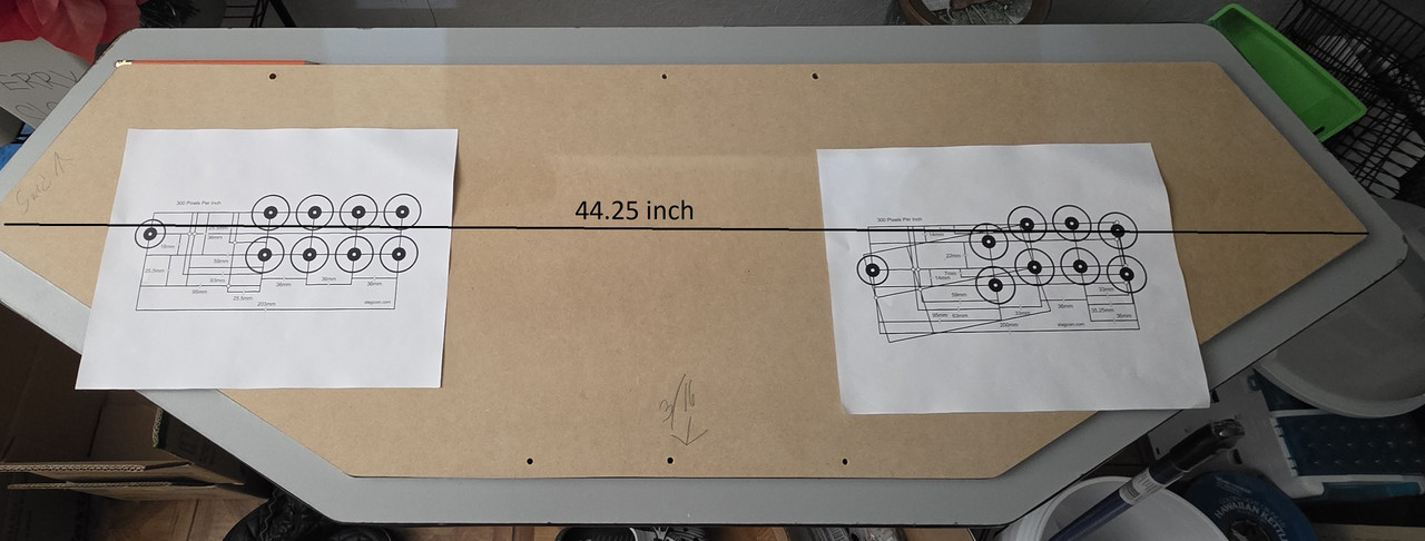

Hello, won a Capcom vs SNK cab off a auction sight unseen. While it did turn on and work it's in rough shape. After evaluating the cab and seeing it doesn't have a CRT (has the cheapest 16:9 monitor I've ever seen in it) and how the wiring has been spliced and cut a whole bunch I've decided to pull everything out and just rebuild it with a emulation PC in it with a 35 inch Arcooda monitor in it. I'm mostly a console type of guy so I don't know anything about arcade sticks and buttons. My first question is what buttons and sticks do I put in it? It can with IL button that take a microswitch in the bottom and oddly I had a ton of that style switch from modding lightgun triggers, not sure if that's the way to go. I've heard of the name brand Sanwa before, not sure if that's the move? For the stick I have no clue, I know you have different gates and I see so many styles. Can anyone shed some light on this for me? The buttons are 30mm and the stick hole is 45mm. Is the Ultimarc I-PAC the way to go to get this to interface with a computer once I'm done? If not what do I use?
Here is the current control deck. Thinking of just doing a fresh vinyl wrap on the metal deck, shouldn't be hard. I do want to replace the plexiglass, I see sources online for the 1/8th thick sheets online. Any tips for cutting it and drilling the holes? I haven't worked with plexiglass in 20 years and then I just made a custom cluster for my old Mustang.
Thanks for reading, sorry if these questions are super basic.

The first thing you are going to want to do... is to replace, or re-drill the control panel.
Angled sticks are a Horrible user experience,  and never should have been installed like that
The reason is... you are always looking at the screen, not the stick.. and so you will automatically be thinking
that  "UP"  is towards the monitor.  But since your stick is angled.. Up will be diagonal... so you will end up
making the wrong move.
Its different from holding a gamepad in your hand, and sitting at an odd angle... because the gamepad's UP,
is always locked in place.  Its always UP in the controllers orientation.. in your hands.
With a control panel, you cant really Feel which way is Up.  Especially since a Joystick doesnt have that
gamepad Cross shape, for even a Tactile feel.

 So, IMO..  I would recommend two rows of 3 Happs concave micro-switch buttons.  And at least one Leafswitch button, placed slightly
diagonally under them... similar to the layout of Mortal Kombat 3's  "Run"  button.   In that way, you can use it for Rapidfire games,
shmups, and classic games... as well as the run button for MK3.
 For the stick, Id use the Happs Competitions... in line with the buttons.  HOWEVER... Id ALSO place a leaf-switch stick diagonally
up above the Happs sticks.  In that way, your hand can reach either stick... and you can choose whichever you want to use, depending
on the games you choose to play.   You could even potentially use a wico command stick, that has a trigger button on top, so you can
play games like Tron, Mad Planets, and other Dual Control games that also feature a Spinner.
 Id also add a Spinner or Two to the Control Panel... for Spinner games like Tempest, Arkanoid, Star Trek, Tron, Mad Planets,
Supersprint, and many other Driving / Racing games.

 Note - Do not stack the sticks directly on top of each other, or your wrist/arm will hit the bottom stick, when using it
By adding a slight diagonal mount, your arm wont hit the other stick.
 Also... Do NOT curve your button rows !!   This is a very common mistake that so many people make.  My former self
included... which caused me to have to redo my entire Control Panel as a result.   While curved buttons look nice visually,
and save you almost an inch in space... It causes you to lose track of where they are, when you are playing.
 Your keyboards keys, are in a straight line for a good reason.  Your fingers sit directly above them.. and you know exactly
where they are located, because they are in a straight line.  If the keys were on a curve, and you were not looking at the
keyboard when you tried to type on them... you would accidentally hit the edges of the buttons, or potentially hit the
wrong buttons.

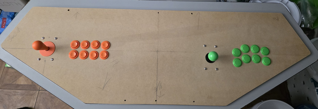

Most every Arcade game that exists... uses a wood control panel, topped with Plexiglass.
- Happ Buttons are adjustable in depth, and can be mounted to Wood or Metal panels
- Happs Joysticks are designed to sit under a wood control panel
 (Which tends to be particle board, maybe 3/4" thickness... I cant recall exactly)
 (However, if you want to raise them higher, you can partially route the wood, or use a Metal Mounting Bezel)
- Most Japanese Controllers, might be designed for metal control panels.. as they started using a generic plastic cabinet design
  *That said, I think many people route wood thinner, or use metal mounting bezels, or mount them on top.. under the plexiglass
   (only problem with mounting under plexi/artwork.. is if you ever need to service them, it will be a bit more work)

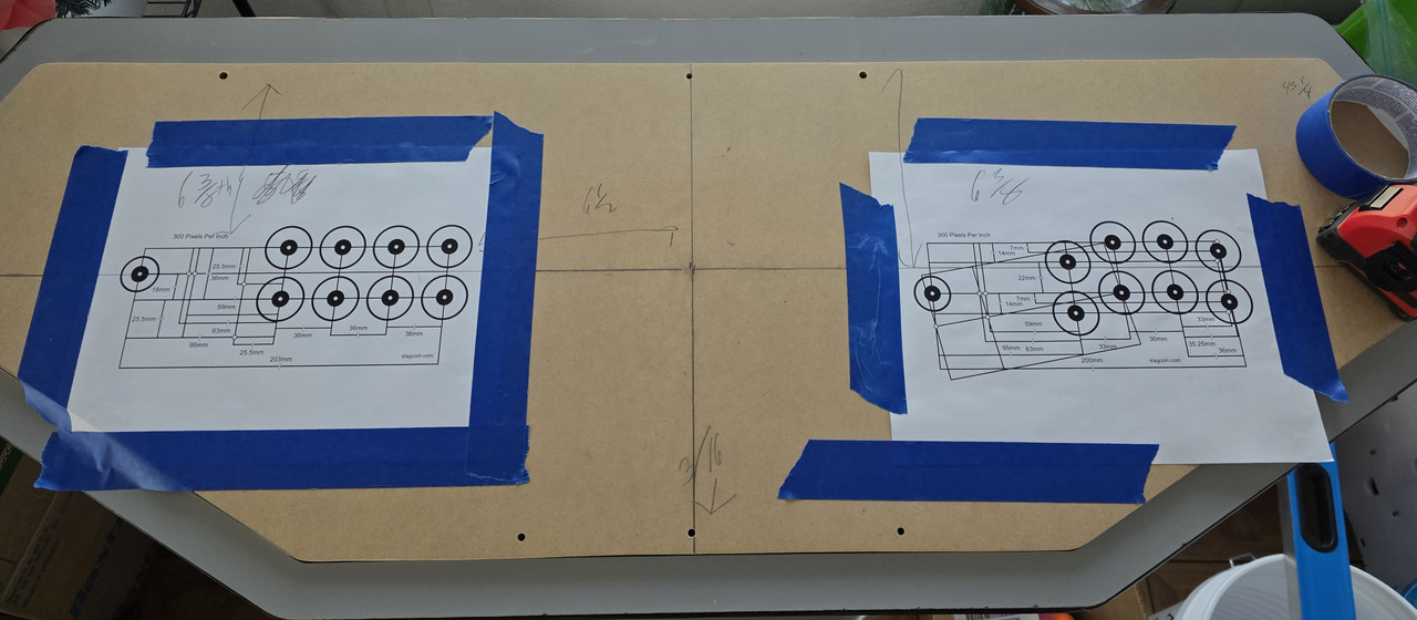

 Ive came up with a Mockup idea... based on your specs, and other games Id highly recommend playing...
- The top blue buttons, would be for Neo Geo. The straight line is better than the original method
- The Green sticks are Happs Competition sticks
- The Left Red stick, is a Trigger Stick.  This could be a Tron Handle stick, or a Balltop/Bat with top button
- The Right Red stick, is a Dedicated 4-Way.. for playing Pacman, and other 4way games
- The Purple Button, is the Pinball Leafswitch button
- The Gray Button, is for Defender (reverse button)
- The Orange things are Spinners.  You an could use Up/Down spinner on the left side, for Discs of Tron.. as well as to use an another button (such as Defender Reverse, MK3 Run, etc)
 This will allow you to play Most Arcade games, with the best Controller Options.. while still having extremely good Comfort  (You dont have to rest your arms on top of other controllers, as everything is adjusted to your arms playing angles)
 I recommend making a Cardboard mockup (use a few sheets thickness, glued together), and mounting the controllers to it.. for a Comfort Test, before settling on Exact Spacing Positions.  Have another person testing at the same time, to make sure both of you are not getting in the way of each others limbs.
 Note:  If you dont care about a dedicated 4way,  add another 8-way leafwitch stick... which will make Robotron easier to play (otherwise, you will have to use the Comps, or the trigger stick + a comp)
 I dont know what the current options are for Trigger Balltops, and Bats.  Though, one might be able to
hack a button onto a stick, as another option.  Or hack an older Computer stick, like the Wico Command stick, to the Panel.
 - The Trigger stick is needed for games like Tron, where you aim with the spinner.. move with the stick.. and fire with the top button.  Even if you are not a fan of Tron.. Mad Planets,  is worth having these controller options.  There are many other games that you can play, using these controls as well.
- There are only a few games that use an UP/Down spinner. Discs of Tron being the most famous of them. However, the additional button presses.. will give you options for other games.  You could daisy chain wire these buttons, off of the other buttons.
- You might add a 2nd pinball button to Each side of your Control panel.. for Pinball games.  But since your CP is too wide to use both at the same time.. use the button on top of the panel + the button on the side of the cabinet.   That said, using microswitch buttons for pinball isnt that big of a compromise.  Its just about how smooth leafs Feel, and react.

Do you have any opinions on this lay out? I have some 1/4 ply I'm gonna mock up some layouts on to try before I move to the metal for my cab
For my speakers, I want to keep the speakers in the cab. I know that's limiting but it's what I want to do.

« Reply #6 on: January 12, 2026, 11:52:59 am »
Dont Do it !!
I once built a control panel with a Curved button layout like that.  It was AWFUL.
It looks like it would fit your fingers Ergonomically.  However... the problem is.. you dont lay you
hand Flat, when using buttons.
 When you type on your Keyboard.. look at your fingers.  They are vertically bent downwards at the
first knuckle.  Thats why every key is in a straight line.. so you know exactly where they are, even
if your eyes were closed.
 When you try to use a Curved button layout on a Control Panel... you end up hitting the edges
of the buttons, instead of the center of each button.  Also.. you might even accidentally Miss the
button altogether
 You would not save more than any inch of space, by curving buttons.  And, you would seriously
regret doing it.  Just use the Straight Line rows.  Trust me on this.
 Many people have made the same Mistake... but they are too proud to rebuild their control panels,
and have suffered for it, as a result.

I have a Theory why certain Japanese cabinets used Curved buttons.
Their cabinets likely needed more control panel space for each players arms
Also.. as far as Ive seen... their buttons are either Flat Topped, or Convex (raised bump)
(I personally hate flat or raised buttons.  Convex is so much nicer feeling)
Being flat topped would make it less of a problem to press a buttons anywhere on its surface, rather than its center
Add to that, micro-switches that take less activation force.. might allow them to lay their hands flat, while playing
(I cant confirm this, because Ive only owned a Japanese stick.. not their buttons)
But even if all that is true... its still vastly inferior to simply bending your fingers vertically over the buttons...
because you get a superior mechanical advantage.  Better strength, speed, and better control.
Again, you never lay your fingers flat, when typing on your keyboard
Another thing that partially may have effected Japanese Cabinets... is that they are Sit Downs.   The problem with
a sit down fighting cabinet... is that if you are too short, your hands/wrists might be strained, trying to angle them
upwards on the Control Panel.   This is why most US Standing Arcade cabinets have a slight Angle on the Control
panel... to allow people of shorter heights (children), to be able to reach the controls with comfort.. rather than
their forearms being scraped on the sharp front edge of the cabinet.
But As said... even if you were to use all Japanese buttons / parts... Id still recommend using a Straight Line
alignment.   Its simply easier to tell where the buttons are, without accidentally hitting the wrong button...
and you get better strength, speed, and control, with slightly bent fingers.
Ohh, and As Ive said before... if you are not planning to use Japanese parts.. you can use wood for the control
panel.. rather than having to have a new metal part cut + drilled.  This also means, if you wish to change / remake
a control panel... its that much easier.  No need to ever cut metal again.

So I finally had some time to spend on my arcade project. Have this half inch MDF cut and fitting well. This is my test panel to see what layout I like. Any tips on where to place the templets so it feels even? Had my wife stand next to me and kinda just put it where it felt okay. Still want to somehow center it so it looks even. Also, thinking since I have such a big control panel that I could/should put a track ball in the middle for Golden Tee and other track ball games. What do you guys think? If I include a track ball, what is a good track ball to use? I really don't want any of that LED nonsense on it.
But yeah, any tips of tricks or rule of thumbs for where to place the controls would be great. This is my prototype but I still want it to be right so I can use it as a template to make the final board.
EDIT - I'm using a I-PAC2 for my interface so any track ball would be X/Y output and not a USB/PS2 one.
The Ultimarc UTrak is easy to mount and is plug and play with the IPac, but some people prefer a Betson or Suzo Happ.
- The trim bezel is a nice option, but if you're using it on a 3/4" thick panel, you'll want to countersink the underside of the panel 1/8" so the trim bezel isn't sticking up above the UTrak case.
A Suzo Happ 3" trackball with red boards and molex (not USB + PS/2 green boards) is a great choice.
- You'll want a mounting plate and a Molex to Dupont adapter.
Molex to Dupont adapter - uses non-standard wire colors so verify the pinout before connecting it to your IPac.
https://www.arcaderenovations.com/suzo-happ-to-ultimarc-utrak-arcade-trackball-adapter.html

Alright boys, after spending way to long measuring and eye balling, this is where i'm gonna drill. It's hard to make the layouts feel even because the joysticks are in different places on each templet. Right now they are matched by the top row of buttons.
Wish me luck on the cut!

Thanks for the reply, to be clear i'm using half inch MDF not 3/4. Plus the 3/32 the plexiglass is. What track ball feels the best? Outside of real Golden Tee cabs the only other track ball I've tried was on this mini cab someone built at Too Many Games (a retro game convention) and it felt like a cheap toy. I'm willing to spend some money for a nice, quality feeling unit. I also have a router
If you're looking for highest quality, go with the Suzo Happ as mentioned above.
- Not sure about the quality of the cheaper knockoff vesions sometimes referred to as "Suzo Happ style" trackballs.   :dunno
- The mount plate will cover a lot of woodworking boo-boos.   :lol
If you want to go with the Ultimarc UTrak, you can cut the 82mm circle (86mm for the trim bezel) using a "router compass" or circle cutting jig like these.
- Check the compatibility list to ensure you get the right model for your router.
Metric - https://www.amazon.com/Jasper-Metric-Circle-Cutter-Router/dp/B09B175D1V/
Imperial - https://www.amazon.com/Jasper-200J-Circle-Cutting-Plunge/dp/B00009K77A/?th=1

FYI - I believe Ive read many reports, of Ultimarc trackballs having issues, where it stutters mechanically, when changing direction
I believe this is due to trying to raise the ball up too high.. which was likely done to try to make it easier to mount.
The Happ Trackballs are Rock Solid, and Id highly recommend them over Anything else.
Its not hard to mount them.  Just drill a few holes.. and then jig-saw a rough square for the mounting plate
If you dont want to see the plate, im pretty sure you can hide it under the artwork, if you route a small lip ledge, to where the
plate sits flush with the CP Surface.   Then apply the artwork over the top of it. Carriage bolts after the plexi is put on.
As for Centering the Trackball..  that should Not be your main focus.   A common problem with centered Trackballs.. is that the right side players
joystick is too close to the ball... so when you spin the trackball hard and fast to the right... your hand Crashes hard into the stick.
Instead... you want to leave about a 1ft diameter circular area, from the center of the Trackball.. where no controllers are in that circle.
It might not be perfectly centered... but not crashing your hands into the stick (or the monitor), will be worth the mild visual annoyance.
Truth is, when you are playing the machine, you wont be looking at the Control Panel
-                         xxx                          -
-   [ o ]  ooo     x         x     [ o ]  ooo   -
-           ooo    x    ( )    x            ooo   -
-                     x         x                      -
-                        xxx                          -
( ) = Trackball
 X  = 1ft Diameter Circle of Free Space
Since Buttons are fairly Low in height.. you can actually get away with the Trackball being a little closer towards them
(moving trackball towards the left)   That said.. you still dont want buttons too close, in case someone slides, instead of arcs up.
« Last Edit: Yesterday at 01:43:33 pm by Xiaou2 »
