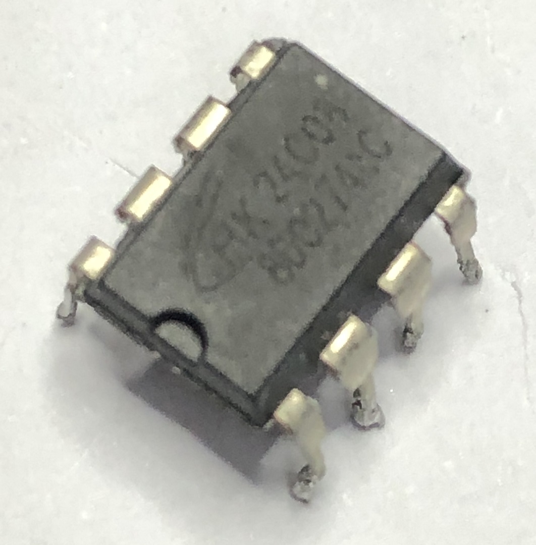

Time to talk about hacking the TV's EEPROMs. Here it is, "24C08":

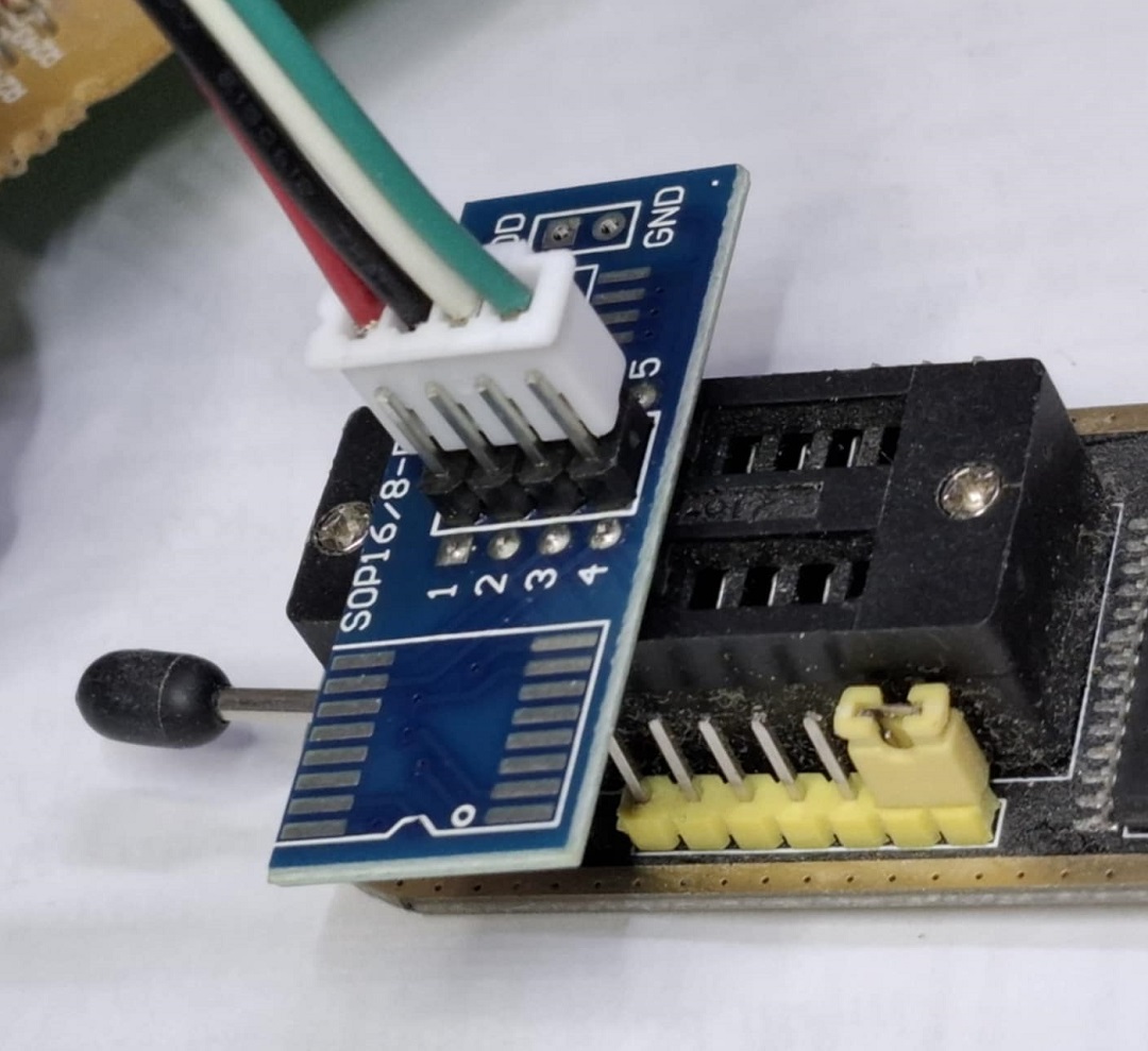

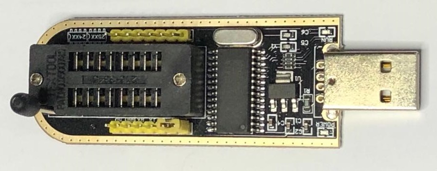

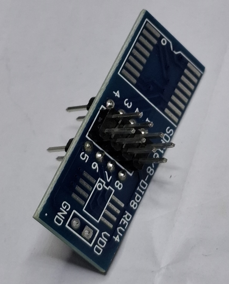

So I bought myself a cheap EEPROM programmer imaginatively called "CH341a", which works with the EEPROMs used in these China TVs (24C08). The unit comes as a kit with some useful accessories, including a clip that can piggyback onto the smaller surface mount SOP-8 ICs. Some pics below so you can see how it attaches.
Unfortunately the China TVs use larger DIP-8 chips, the clip cannot be used with them, so the EEPROM must be desoldered from the PCB so that you can slot the legs directly into the programmer. Very inconvenient. I worry about damaging the traces, and after doing this a few times I am now over it.

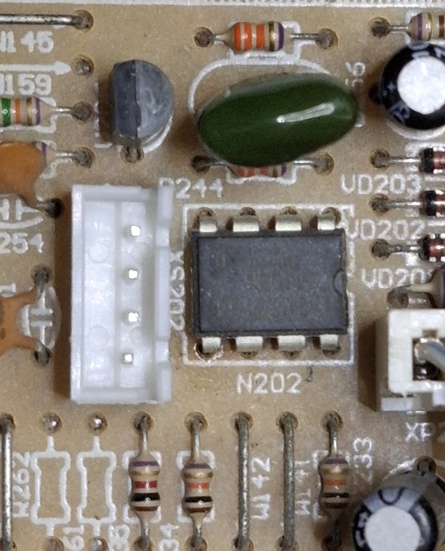

Working on these latest TVs, I noticed something different about them - a 4-pin connector that wasn't present on the ones I modded 3 years ago. The traces go to the EEPROM pins 5,6,7,8. This corresponds to 5v, GND, and two data pins. the other pins 1,2,3,4 are all connected to GND. Below are some pics, on the left is the earlier TV, note that the connector is missing.

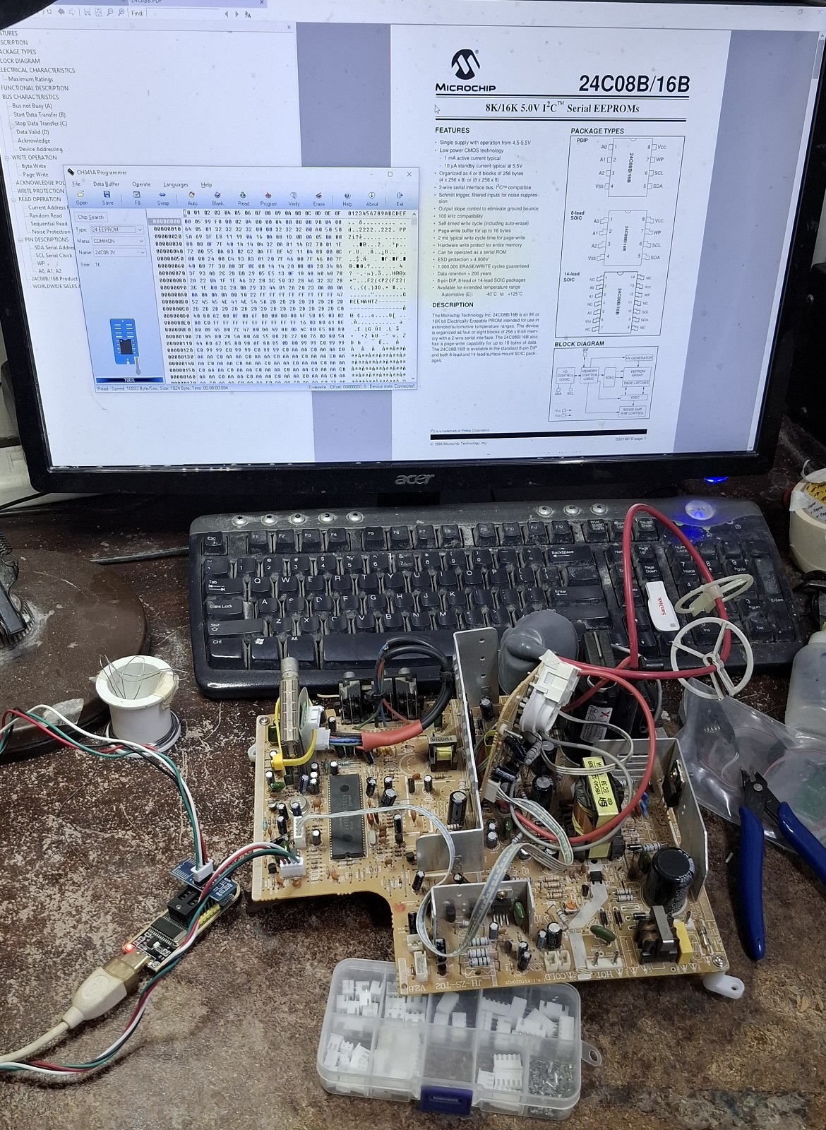

I already have the right connectors in that kit I mentioned earlier, So I added a male connector to that vacant spot on the older TV. I also made myself a short cable with two female ends, using red (5v) black (GND) and green/white for the data wires.  Then, carefully considering the correct orientation for the pins and cable, I slotted the 4P connector onto the CH341.
Now time to test. Success! Hurrah! Now I don't have to desolder the IC every time I want to reprogram it, or to just make a backup.
For fun, I hacked the vendor name in the EEPROM - now it is a GreenAntz TV!
