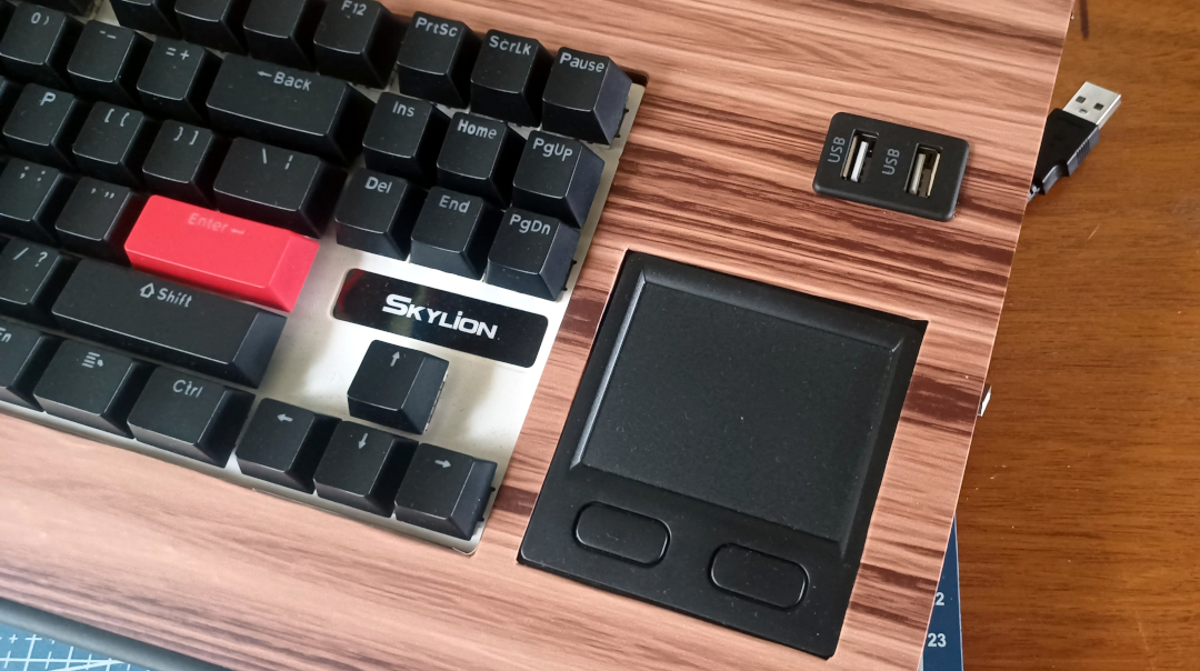

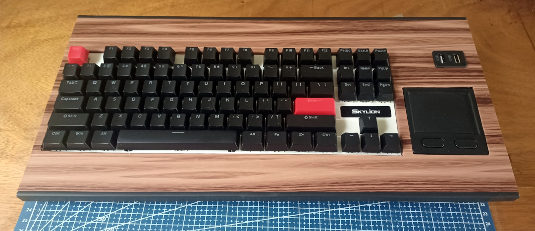

Something funny happened while I was building my little bartop machine a few months ago. Before the control panel had been completed, I had been in the process of setting up the OS (Linux), transferring files and software, and had temporarily sat a keyboard into the control panel cavity to do some commandline stuff in the terminal emulator... The temporary keyboard setup and all-in-one form factor of the system transported me back in time to my reminiscences of early 8-bit home computing just as effectively as the machine has with arcade games.
I decided that a terminal-style keyboard control panel would be a fun add-on for the bartop, because what better way to enjoy emulation of 8-bit computer systems than with a dedicated, retro-styled, all-in-one box? Since the design of the cabinet allows for very easy control panel swaps with USB interface, I figured why not.
I ordered an inexpensive mechanical keyboard, a trackpad module with USB interface, and a small two port panel-mount USB breakout. The keyboard is a ten-keyless unit chosen for its compact dimensions, and the trackpad is a useful compromise between the need to have a pointer device for admin use and my desire not to have to rely upon an external mouse, as a mouse is a little out of keeping with the early computers that it's going to be emulating. The USB breakout is simply for conveniences sake, so that I don't have to reach around to the back of the machine to plug in USB thumbdrives and whatnot.
The panel itself is just a piece of 12mm plywood with cavities cut out of it using a jigsaw. The keyboard cavity was very simple to cut out; just a rectangle with a minor relief pocket to accommodate the cord where it exits the keyboard case. The keyboard is recessed about 8mm from the top surface to keep the keycaps at an ergonomic installed height. The trackpad cavity was a bit trickier, as I wanted it to be flush-mounted to the top of the panel, and the trackpad has a raised bezel around its work surface. Installation required pocketing the underside of the panel which I did by hand via chisel and dremel. Both are retained on the underside by simple plywood straps that screw to the bottom of the panel.
I went cheap and easy on the finish, reusing some of the leftover woodgrain vinyl and 12mm adhesive edge molding, same as what was used on the cabinet itself. It's not an object of beauty, but it doesn't need to be.
