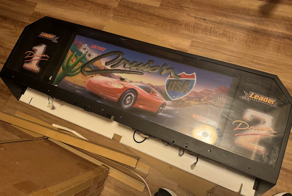

« Reply #22 on: Today at 02:52:39 pm »
https://youtube.com/shorts/SO_e-36-JFY
/edit Now I really need to get going and hang this beauty above my cabs!!!  Anyone have a manual on the Cruis'n USA topper? I think I can figure out the voltages but I don't want to accidently let out the magic smoke....
