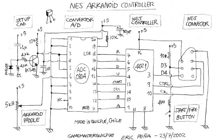

Given the size and complexity of the schematic, at a minimum this will be a two-layer PCB with plated through holes.
You might want to practice on an easier design like the the NES Arkanoid (Vaus) controller here or here.
