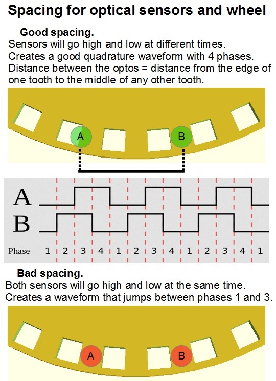

I'm trying to calculate the resolution needed for a trackball in Mame.
My spinners are 1200ppr which I'm sure I read somewhere was correct, or close enough.
The trackball however has a 2 1/4" diameter pool ball, turning against a 5mm shaft, so there's a big ratio.
Some basic maths will tell me the ratio, and I'm assuming 1200 is the target.
Am I correct in thinking that as it will be quadrature each hole in the wheel will actually be 2 pulses?
This will be fed into the optopac, same as the spinners.
Am I on the right track or miles off?
This is all being 3D printed so I can trial and error but I'd like to be fairly close to start with.
Assuming you have a properly paired encoder wheel and opto spacing, quadrature waveforms have 4 phases per tooth/gap.
- The good spacing image shows the encoder wheel at the left edge of Phase 1.
- Data line A is transitioning from high (not blocked) to low (blocked) and data line B is in the middle of being blocked.
- As you rotate the encoder wheel clockwise, the blocking and un-blocking of the optos will produce the quadrature waveforms shown.
Get the encoder wheel and opto spacing right then you can adjust the sensitivity in MAME.
- I'm guessing you plan to use Happ Red Boards instead of trying to design your own optical circuit, right?
To work out the correct opto spacing and encoder wheel measurements:
- Calculate the number of degrees for each tooth/gap on your encoder wheel.  For example, a 24 tooth encoder wheel ==> one 360 degree rotation of the wheel is divided into 24 teeth + 24 gaps ==> each tooth and each gap is 7.5 degrees wide. (360/48 = 7.5)
- How many teeth gap between optos?  The image above shows a 2.5 tooth gap. (2.5 * 7.5 = 18.75 degree gap angle)
-- More info about this gap value here.
- Use the known distance between the optos and the gap angle to calculate the radius from the center of the shaft to the opto position.
-- Split the triangle defined by the two optos and center of the shaft into two right triangles.
-- You know the gap angle and the distance between optos so divide those values by two and apply them to the angle (θ) and "opposite" of one of the right triangles then use the sine trigonometic function to solve for the hypotenuse which is the radius from the center of the shaft to the opto position.

Your idea should work fine at low speeds, but it probably won't work at high speeds.
The Red Board is a bit more complex than just 2 optos and 2 resistors.
Without the correct circuit design and balance of component values, you are more likely to run into problems like backspin at high speed due to high frequency roll off.
As you go faster, the high/low pulses of the quadrature waveforms become more narrow (higher frequency) but it still takes the same amount of time to transition between logic high and low.
If the transition time is too long compared to the pulse width, the optical (mouse) encoder won't have enough time to register the change in logic levels.
