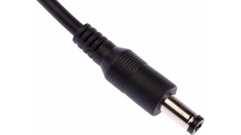

Hey all, so I've just pulled the trigger (pun fully intended) on purchasing an Aimtrak gun from eBay. I'm drawing a bit of a blank though on places to get a power supply for the recoil function in the UK. I can't find any on eBay or Amazon from UK sellers or any companies that do them  with a bit of Google searching. There are some US vendors that sell them, but I am utterly clueless about how the whole US to UK voltage thing works, other than I know our voltage is higher here. If I purchase a US PSU for the gun, can I then just use a standard 'kettle cord' cable to plug into it? Pretty sure I've got a spare one from an old PC somewhere. Alternatively, do any fellow UK BYOAC-ers know a place to get this type of PSU from over here? Thanks in advance for any replies.
As long as the PSU input range includes 240V/50Hz it will work fine in the UK.   :cheers:
- As always, check for a 110/240 switch before plugging in anything from the U.S.
BTW, the PSU picture you posted appears to show a Cloverleaf C5 connector instead of an "IEC" (standard 'kettle cord') connector and 18.5V/3.5A doesn't match the specs in the description.   :dizzy:
- It's probably a case of wrong photo, but they ship a PSU with the right specs.
- If it doesn't come with an IEC connector cord you might need to hunt down one with the right style of connector -- pretty sure the Cloverleaf C5 is used on some laptop PSUs.

These two listings are for this power supply.  (P/N 175-2792)
- The "175-2792" entry at the bottom of page 4 of this PDF states that the output connector is "2.1 x 5.5 x 11mm, Centre Positive".
The only thing I'm not 100% certain about those is if the output barrel connector size is the same as on this power supply from ebay here in the U.S. that Andy links to on the AimTrak page.
Input : 100V-240V 50/60Hz
Output : DC 24V 4A / 4000mA
Output adapter jack size : 5.5mm x 2.5mm-2.1mm
Adapters Connector inside positive (+) outside negative (-)
If you can't confirm the barrel connector size, this listing has a power supply that you can solder on the right connector and it has an on/off switch if you would like that option.   ;D
So, if I'm understanding this right, that US eBay link you linked to from Andy's page, looks like it should be OK to use over here then  as the Input :is 100V-240V 50/60Hz? So if I just swap out the US Cloverleaf C5 connector cable for a UK power outlet one I should be good to go?
The suspected Cloverleaf C5 is in this photo that you posted.
I can't tell if this power supply that Andy links to uses an IEC or Cloverleaf C5 cord.   :dunno
This power supply will work for you.  The only question is which type of cord you'll need.
- If it's an IEC cord, you'll need the one in the pic you posted earlier.
- If it's a Cloverleaf C5, you'll need one like this.

Cheers Scott, nice one. I'm going to order the PSU from the eBay dude in the US and just wait and see what type of cable it is when it arrives. Thanks again for your help!  :cheers:

The power supply turned up today. It was actually a slightly different connector for the plug, one with just two holes (don't know the name of it). Fortunately I had a spare one from an old camera I don't use anymore. Anyway, plugged it in and everything works perfectly, recoil on the gun doing what it's supposed to and my house didn't explode, so bonus! Thanks again for all your help with this Scott, it's been greatly appreciated!  :cheers:
